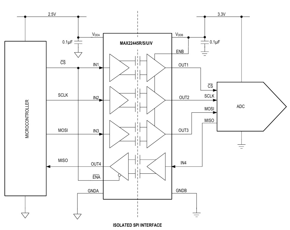

Notably, the output that enables the A side of the isolation can be connected to a shared SPI bus, allowing the CS signal to directly enable the MISO signal on the isolator. Additionally, all other output enables are traditional active-high, providing a convenient and straightforward interface.

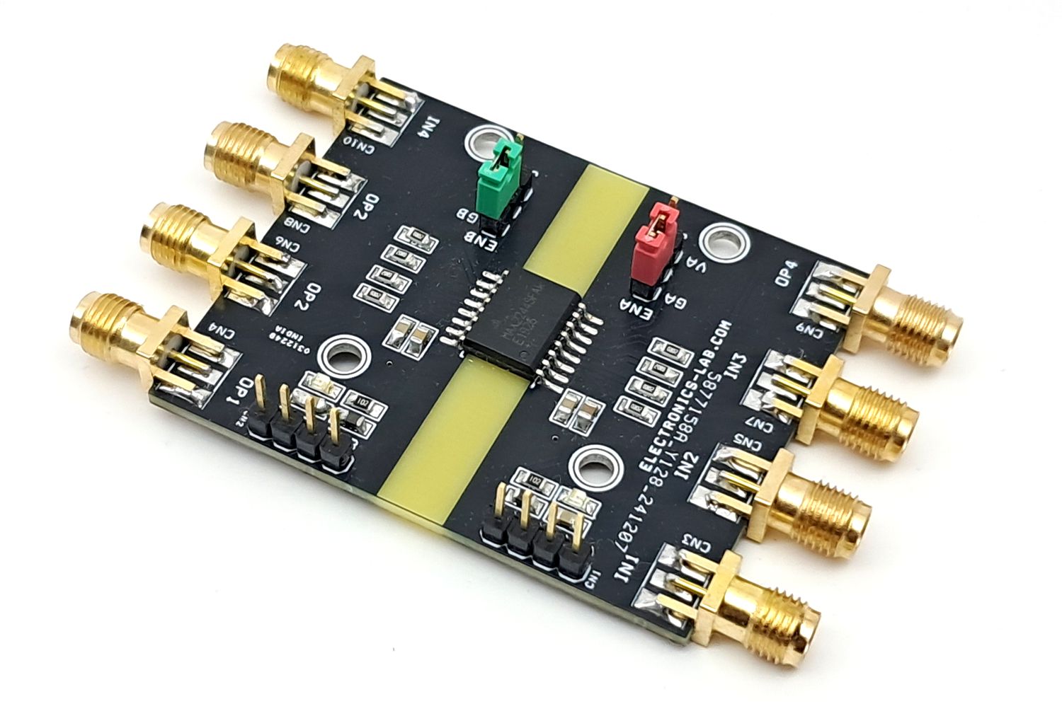

  • Power Supply A-Side 1.71V to 5.5V
  • Power Supply B-Side 1.71V to 5.5V
  • Power LED for both sides A and B
  • SMA connectors for Inputs and Outputs for High-Speed Data Transfer
  • Header Connector for Power
  • Ferrite Bead On power line to prevent noise
  • Reinforced Galvanic Isolation for Fast Digital Signals Up to 200Mbps Maximum Data Rate
  • Withstands 5kVRMS for 60s (VISO)
  • Continuously Withstands 1500VRMS (VIOWM)
  • Withstands ±12.8kV Surge Between GNDA and
  • GNDB with 1.2/50μs waveform
  • High CMTI (50kV/μs, Typical)
  • Low Power Consumption 0.74mW per Channel at 1Mbps with VDD = 1.8V
  • 4mW per Channel at 1Mbps with VDD = 3.3V
  • 2mW per Channel at 100Mbps with VDD = 1.8V
  • 3 Direction Configurations
  • Active-High or Active-Low Enable Inputs
  • 2 Fixed Output Default States (High/Low)
  • 4 x 3 mm PCB Mounting Holes
  • PCB Dimensions 54.77 x 45.09 mm

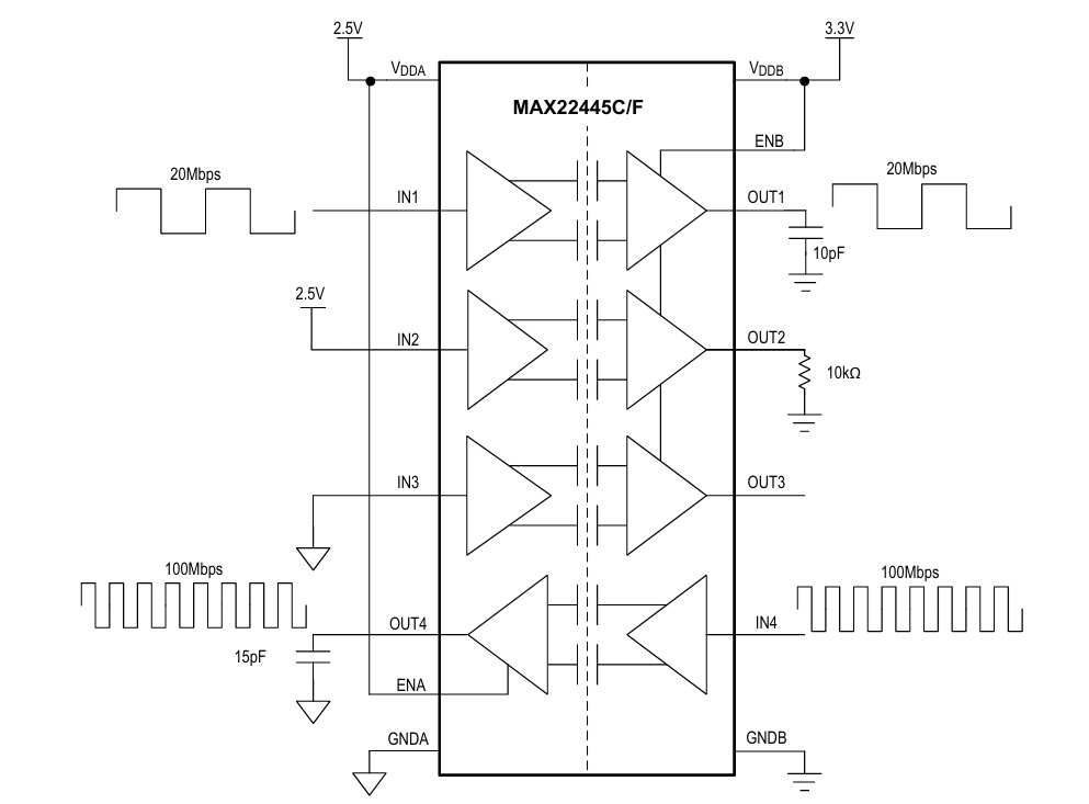

Digital Isolation: The MAX22445 provides reinforced galvanic isolation for digital signals that are transmitted between two ground domains. The devices withstand differences of up to 5kVRMS for up to 60 seconds, and up to 2121VPEAK of continuous isolation.
Level-Shifting: The wide supply voltage range of both VDDA and VDDB allows the MAX22445 to be used for level translation in addition to isolation. VDDA and VDDB can be independently set to any voltage from 1.71V to 5.5V. The supply voltage sets the logic level on the corresponding side of the isolator.

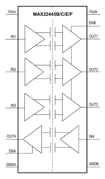

Unidirectional Channels: Each channel of the MAX22445 is unidirectional; it only passes data in one direction, as indicated in the functional diagram.  The device features four unidirectional channels that operate independently with guaranteed data rates from DC up to 200Mbps. The output driver of each channel is push-pull, eliminating the need for pullup resistors. The outputs are able to drive both TTL and CMOS logic inputs.

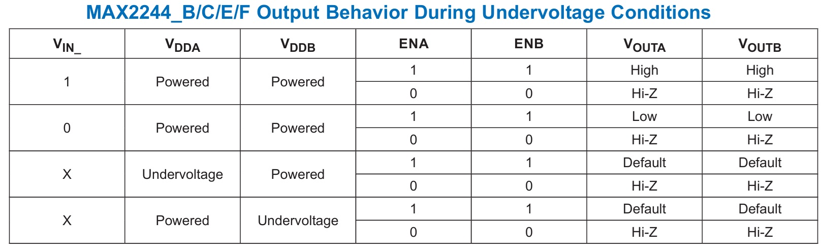

Start-up and Undervoltage-Lockout: The VDDA and VDDB supplies are both internally monitored for undervoltage conditions. Undervoltage events can occur during power-up, power-down, or during normal operation due to a sagging supply voltage. When an undervoltage condition is detected on either supply while the outputs are enabled, all outputs go to their default states regardless of the state of the inputs
Power-Supply Sequencing: The MAX22445 do not require special power supply sequencing. The logic levels are set independently on either side by VDDA and VDDB. Each supply can be present over the entire specified range regardless of the level or presence of the other supply.

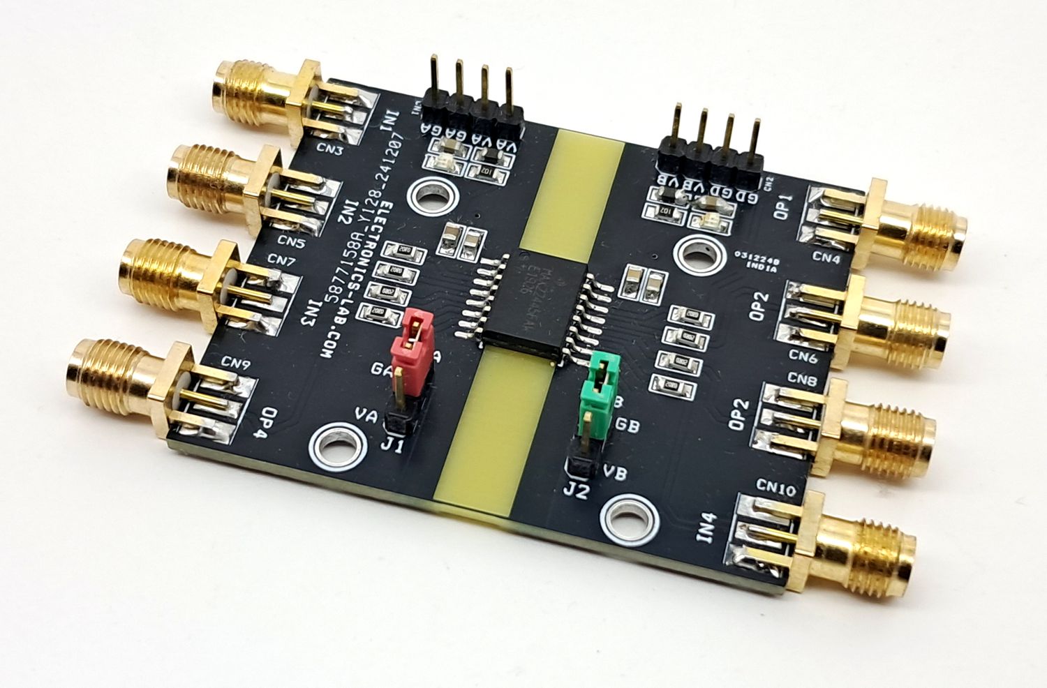

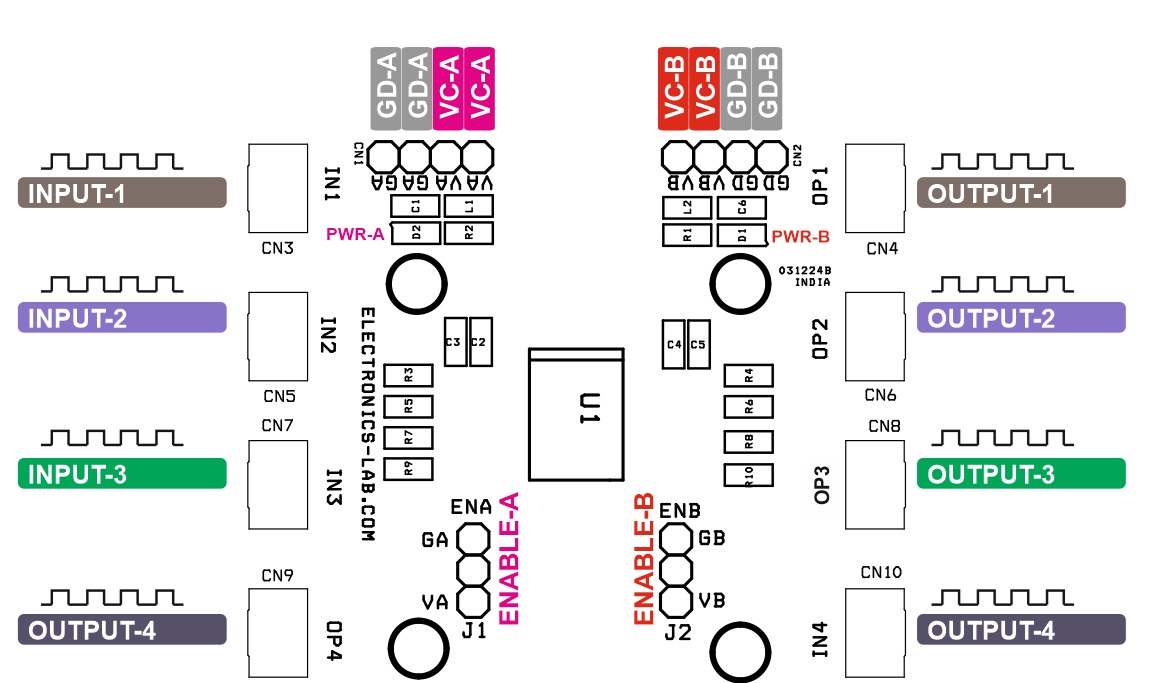

Jumpers
Jumper J1 and J2 are provided to enable or disable the output. Jumper J1 for A side and Jumper J2 for B side.
Note: Devices are available with a maximum data rate of either 25Mbps or 200Mbps, and with outputs that are either default-high or default-low. The default state of the output assumes that the input is either not powered or is open circuit. Refer the datasheet of the chip to select the right chip as per data speed requirements.
  • MAX22445FAWE chip supports data rates up to 200Mbps, enables polarity Low Active-High
  • MAX22445MAWE chip supports data rates up to 25Mbps
Connections
  • CN1 Power A Side: Pin 1,2 = VCC-A 1.71V to 5.5V, Pin 3,4 = GND
  • CN2 Power B Side: Pin 1,2 = VCC-B 1.71V to 5.5V, Pin 3,4 = GND
  • CN3 Input-1 (A Side)
  • CN5 Input-2 (A Side)
  • CN7 Input-4 (A Side)
  • CN9 Output-1 (A Side)
  • CN4 Output-1 (B Side)
  • CN6 Output-2 (B Side)
  • CN8 Output-3 (B Side)
  • CN10 Input-4 (B Side)
  • D1: Power LED A-Side
  • D2: Power LED B-Side

Block Diagram

Isolated SPI Example Circuit
Output Table

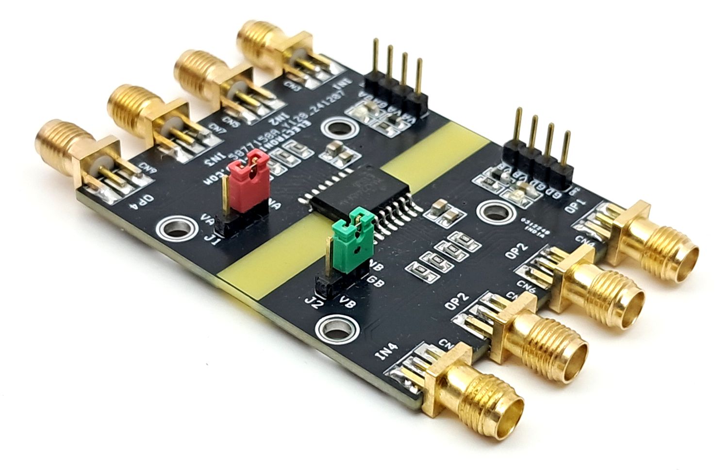

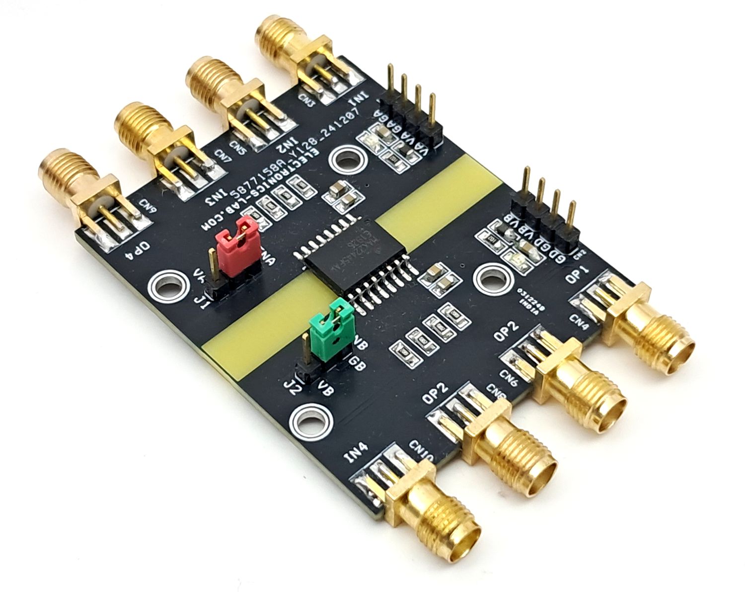

Photos
