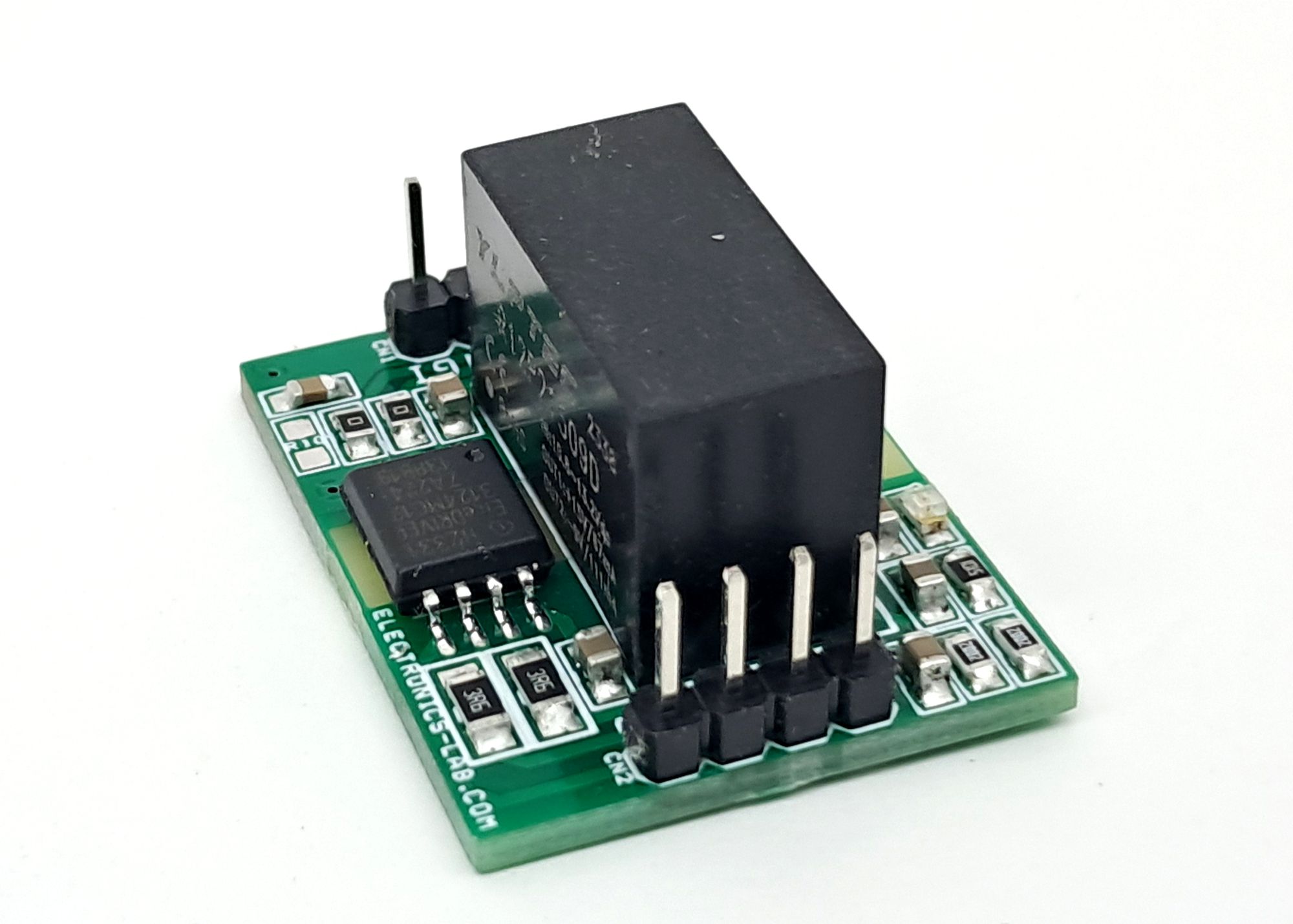

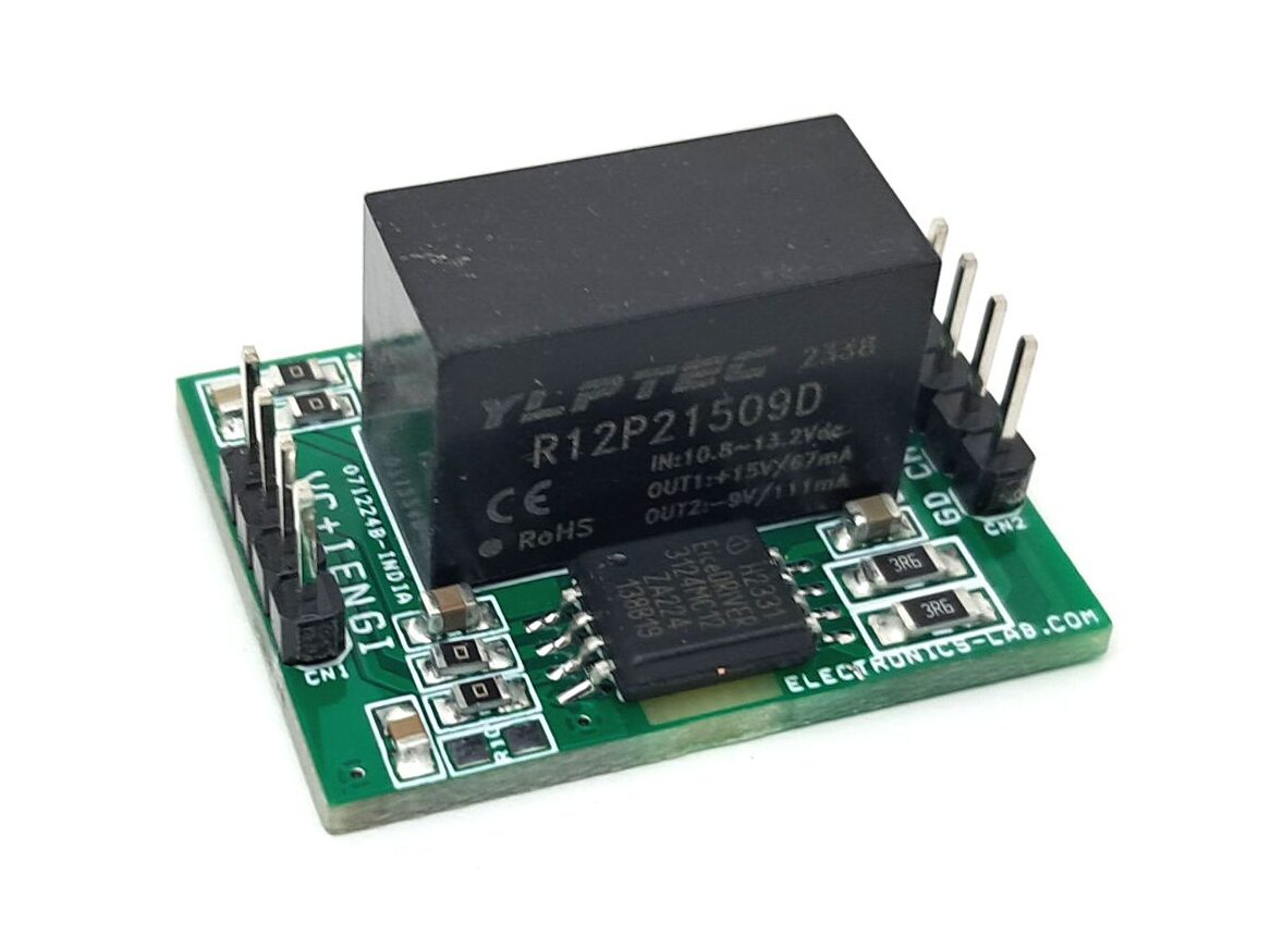

The project design features a galvanically isolated single-channel gate driver IC with a dedicated isolated DC-DC gate drive power supply providing bipolar output of +15V/-9V. This compact module is designed to control IGBTs in inverters, offering high gate driver currents up to 14A for applications like half-bridge, full-bridge, and single IGBT. The driver operates in two modes, non-inverting and inverting, with a minimum input pulse width to filter glitches. The output driver section uses MOSFETs for rail-to-rail output to control gate voltage during on-state and short circuits efficiently. This setup is suitable for use with various IGBT voltages and features optimizations for high-frequency operations.
This project design consists of galvanically isolated single channel gate driver IC and dedicated isolated DC-DC gate drive power supply with bipolar output +15V/-9V. This compact module can control IGBTs in inverters. The isolated high current IGBT gate driver module is a simple solution for power drivers, consisting of a gate driver chip 1ED3124MC12H and an isolated 2W DC-DC converter (R12P21509D). This module is optimized for high-frequency operations and can provide high gate driver currents up to 14A, making it suitable for applications such as half-bridge, full-bridge, and single IGBT.

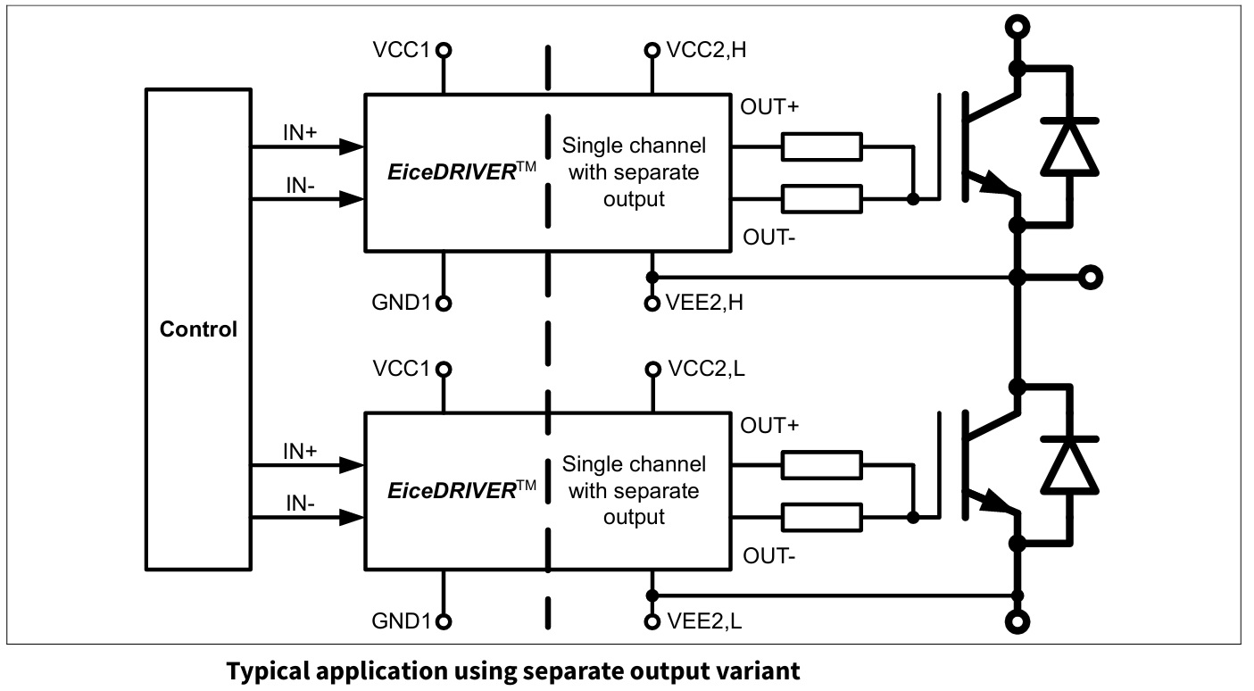

Driver outputs: The output driver section uses MOSFETs to provide a rail-to-rail output. This feature permits that tight control of gate voltage during on-state and short circuit can be maintained as long as the driver’s supply is stable. Due to the low internal voltage drop, switching behavior of the IGBT is predominantly governed by the gate resistor. Furthermore, it reduces the power to be dissipated by the driver.
Single-channel 5.7 kV (rms) isolated gate driver IC with separate output, Galvanically isolated coreless transformer gate driver, For use with 600 V/650 V/1200 V/1700 V/2300 V IGBTs
  • Input Supply 12V DC
  • DC-DC Converter Output +15V DC/ -9V DC
  • Header Connector for Input Power and Signal Input
  • Up to 14.0 A typical peak output current
  • DC-DC Converter Isolation 6.4VKVDC
  • Gate Driver Chip Isolation 5.7 kV (rms)
  • 3 V and 5 V input supply voltage
  • High common-mode transient immunity CMTI > 200 kV/µs
  • Output Header Connector
  • On Board Power LED (Output DC-DC Converter)
  • PCB Dimensions 31.12 x 23.81 mm
The module is configured to drive the IGBTs, but this can be configured for high current MOSFETS and Sic-MOSFETs
The module is configured for IGBTs but can also drive MOSFETs and Sic-MOSFETs by replacing the DC-DC converter with the following options:
  1. R12P22005D: +20/-5V for SiC MOSFETs
  2. R12P21503D: +15/-3V for SiC MOSFETs
  3. R12P21509D: +15/-9V for IGBTs
When replacing the DC-DC converter, it’s essential to adjust the gate resistor values (R6 and R9) according to the gate capacitance and response time of the device being driven.

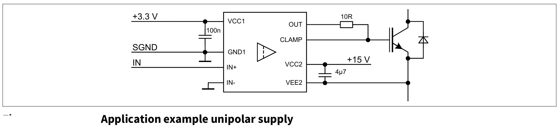

The 1ED3124MC12H   gate driver ICs are galvanically isolated single channel gate driver ICs for IGBT, MOSFET and SiC MOSFET in PG-DSO-8 package. They provide a typical output current of up to 14.0 A on separate source and sink pins. The input logic pins operate on a wide input voltage range from 3 V to 15 V using CMOS threshold levels to support 3.3 V microcontrollers. Data transfer across the isolation barrier is realized by the coreless transformer technology. All variants have logic input and driver output undervoltage lockout (UVLO), and active shutdown.

  • VCC1: Logic input supply voltage of 3.3 V up to 15 V wide operating range
  • GND1: Ground connection of input circuit.
  • IN+: non-inverted control signal for driver output. An internal filter provides robustness against noise at IN+. An internal weak pull-down resistor favors off-state.
  • IN-: Inverted control signal for driver output. An internal filter provides robustness against noise at IN-. An internal weak pull-up resistor favors off-state.
  • VCC2: Positive power supply pin of output driving circuit. A proper blocking capacitor has to be placed close to this supply pin.
  • VEE2: Reference ground of the output driving circuit. In case of a bipolar supply (positive and negative voltage referred to IGBT emitter) this pin is connected to the negative supply voltage.
  • OUT+: Driver source output pin to turn on external IGBT. During on-state the driving output is switched to
  • Switching of this output is controlled by IN+ and IN-. This output will also be turned off at an UVLO event.
  • OUT-: Driver sink output pin to turn off external IGBT. During off-state the driving output is switched to VEE2.Switching of this output is controlled by IN+ and IN-. In case of UVLO an active shut down keeps the output voltage at a low level.
  • OUT: Combined source and sink output pin to external IGBT. The output voltage will be switched between
  • VCC2 and VEE2. Switching of this output is controlled by IN+ and IN-. In case of an UVLO event this output will be switched off and an active shut down keeps the output voltage at a low level.

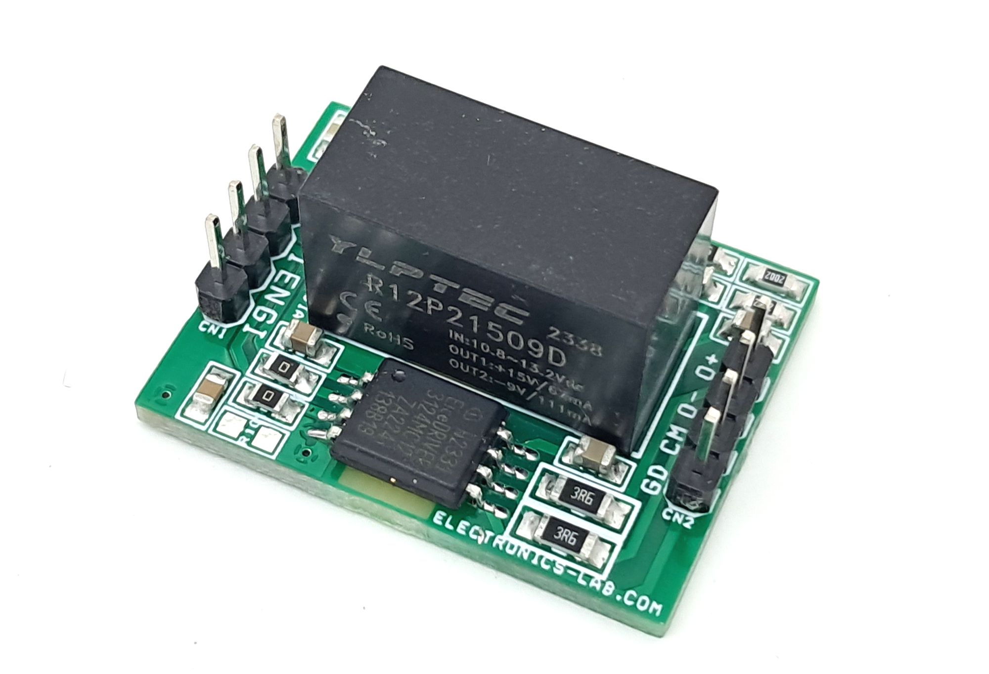

Connections
  • CN1: Pin 1 = VCC 12V DC Input, Pin 2 = IN+ PWM Input, Pin 3 = IN- PWM Input, Pin 4 = GND-Input Side
  • CN2: Pin 1 = IGBT Gate, Pin 2 = IGBT Gate, Pin 3 = Common (IGBT Emitter) , Pin 4 = Power Ground (No Use)
  • D1: Power LED Output side
