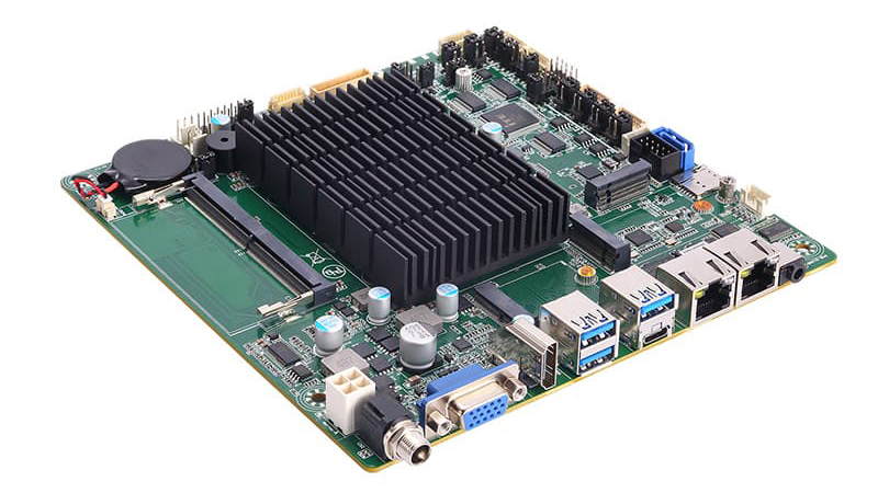

Axiomtek MANO330 Intel Mini-ITX SBC
Axiomtek has introduced the MANO330, a Thin Mini-ITX motherboard built for industrial and embedded applications. The Intel Mini-ITX SBC comes with Intel Processor N97 and N150 options, DDR5 memory support, dual Ethernet, multiple display interfaces, and several M.2 expansion slots. Its compact 170 × 170 mm form factor makes it suitable for digital signage, kiosks, industrial automation, and other space-limited embedded systems.
The board combines modern connectivity with flexible expansion options. It supports up to 32GB of DDR5-4800 SO-DIMM memory, offers HDMI, VGA, and LVDS display outputs, and includes USB Type-C with DisplayPort Alt Mode. Axiomtek also equips the board with multiple M.2 slots for NVMe storage, wireless modules, and cellular connectivity, allowing developers to customize systems for different industrial deployments.

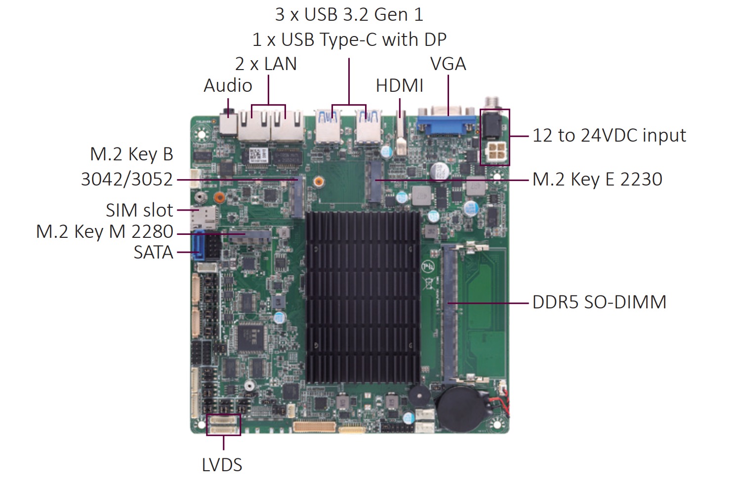

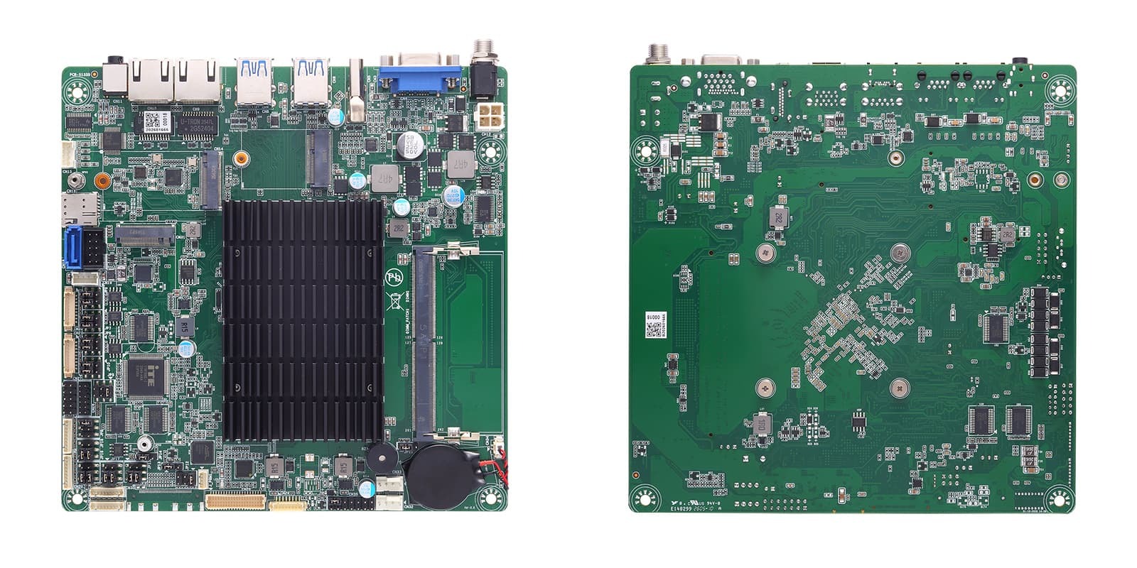

Axiomtek MANO330 SBC Top and Back Side

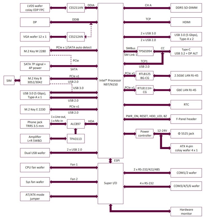

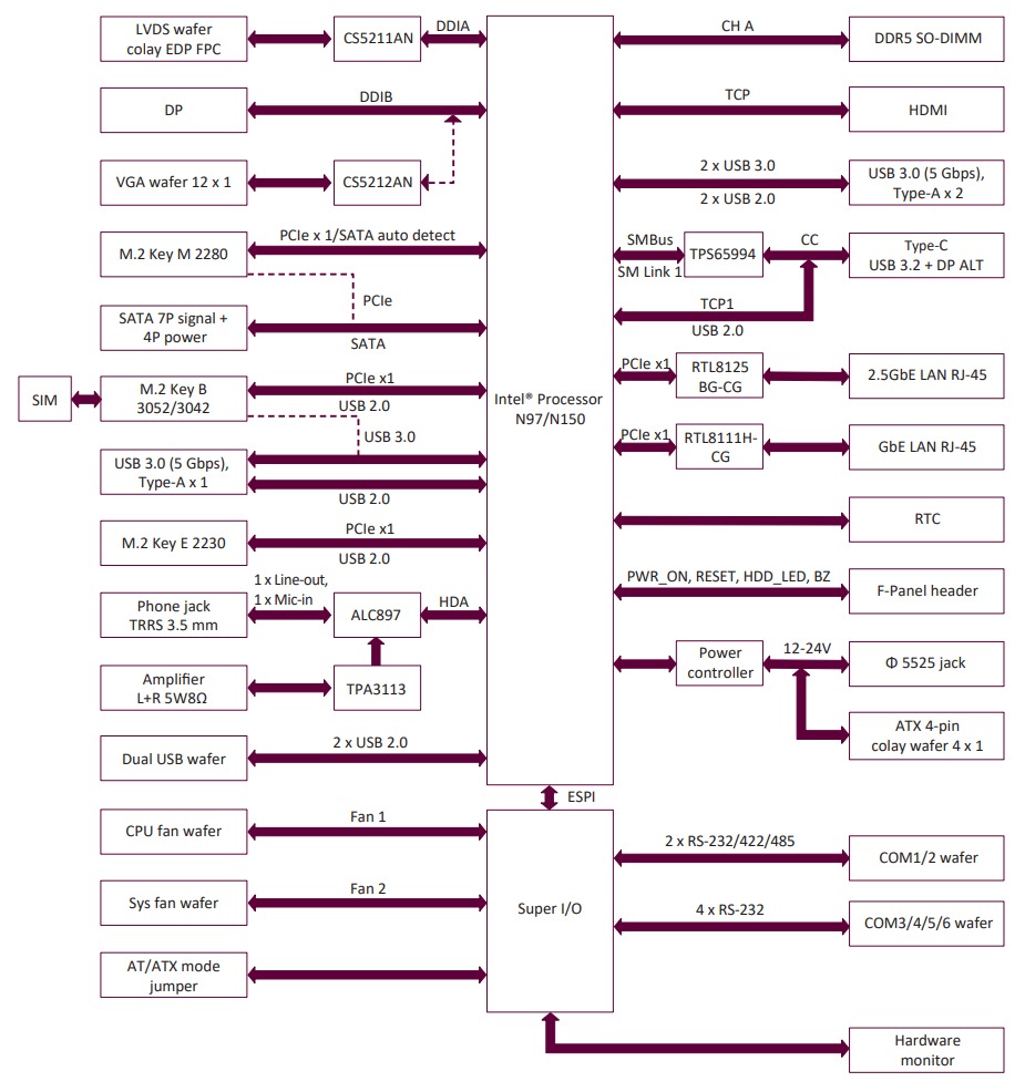

Block Diagram
Block Diagram
