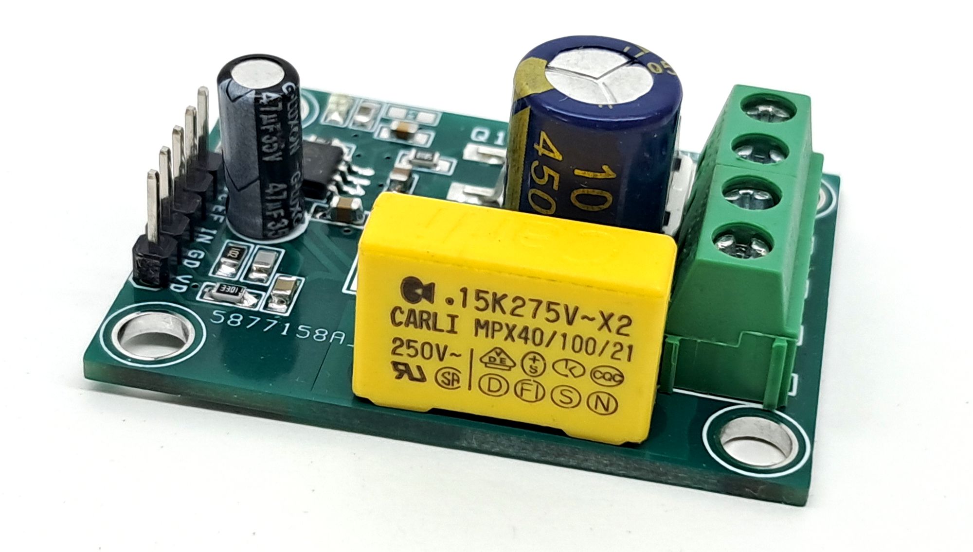

High Voltage IGBT Module, Low-side Driver with Over-Current Protection and Fault/Enable

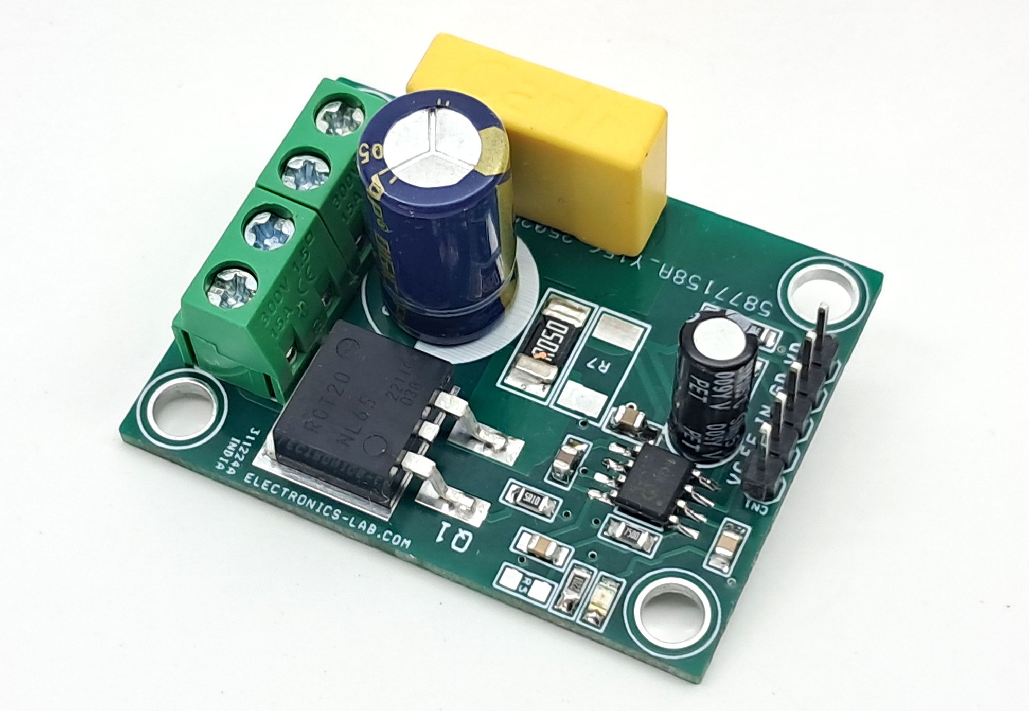

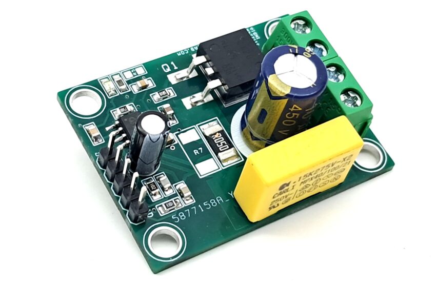

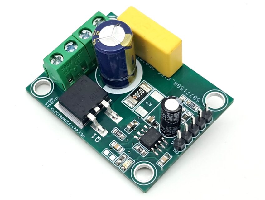

This IGBT driver module is a low-side gate driver that features integrated over-current protection. The primary functions of this module are its built-in over-current protection and enable/fault output capabilities. The board’s main components include the gate driver chip (1ED44176N01F), an SMD D2PK IGBT, and a current sense resistor. The chip is equipped with an over-current protection function, which has a typical threshold of 0.5V at the OCP (Over-Current Protection) point. When an over-current condition occurs, the driver output is automatically switched off. Simultaneously, the EN/FLT (Enable/Fault) pin is internally pulled down, and an internal current source charges the capacitor (C4) connected between the FLTC and VSS pins to program the fault clear time. This module is capable of driving loads up to 1A and can drive higher current with forced air cooling. It can operate within a load power supply range of 80-400V DC, making it a reliable and efficient solution for various applications.
Note: that this project is capable of driving both resistive and inductive loads. For inductive loads, an optional diode (D2) is provided. It is essential to use a high-switching diode, taking into account the load current and load voltage before utilizing this diode. Use   DPAK TO252 package.
  • Power Supply for the Load 80V to 400V DC
  • Power Supply for Logic Circuit 15V (Range 12V-16V)
  • Load Current Up To 1A, Higher Current with Cooling Fan
  • Power Supply VD(VDD) 3.3V To 5V
  • On Board Power LED
  • Header Connector for Gate Driver Power and Input/Output Signal
  • Screw Terminals for Load Power and Load
  • Over-current detection with positive voltage input (OC shutdown)
  • 5 V over-current threshold with accurate ±5% tolerance
  • Single pin for fault output and enable, Normally High
  • Under voltage lockout
  • CMOS Schmitt-triggered Inputs
  • 3 V, 5 V and 15 V Input Logic Compatible
  • Output in Phase with Input
  • VCC Supply Undervoltage Positive Going Threshold 11.9V
  • OCP to Low Level EN/FLT Signal Delay 440nS
  • Fault Clear Time 110uS (C4=1nF)
  • The switch turns off during protection
  • PCB Dimensions 44.61 x 33.97mm
  • 4 x 4MM PCB Mounting Holes

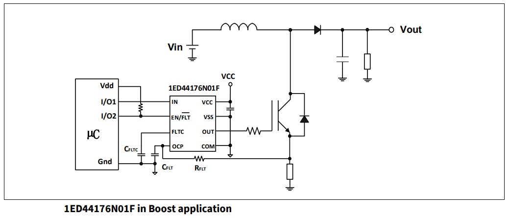

Typical Application

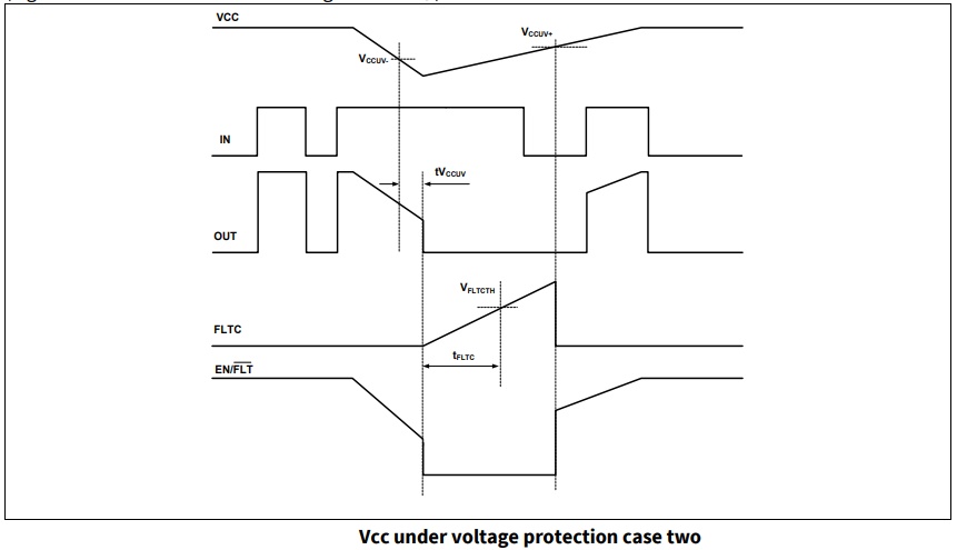

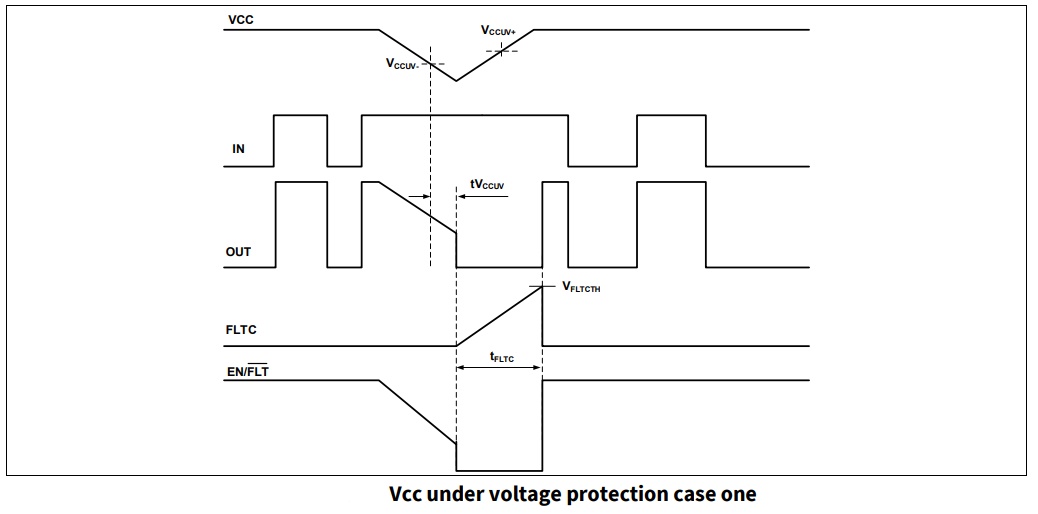

Undervoltage lockout (VCC)
The 1ED44176N01F has an internal UVLO protection feature on the VCC pin supply circuit blocks. Upon power-up, if the VCC voltage fails to reach the VCCUV+ threshold, the driver cannot turn on. Additionally, if the VCC voltage decreases below the VCCUV- threshold and the VCC bias voltage remains lower than the VCCUV- threshold exceeding UVLO filter time (tVCCUV) during operation, the undervoltage lockout circuitry will recognize a fault condition and shut-down the drive output. The EN/FLT will then transit to the low state to inform the controller of the fault condition, regardless of the status of the IN-input pin.  The tVCCUV about 2μs helps to suppress noise from the UVLO circuit, so that negative-going voltage spikes at the supply pin will avoid parasitic UVLO events. When VCC is higher than VCCUV+ and longer than tFLTC, EN/FLT becomes high and the OUT will follow the input signal IN.

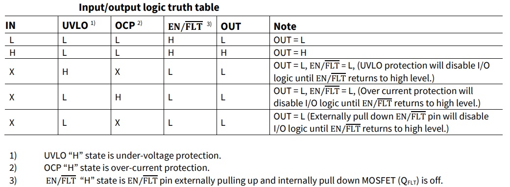

Enable Input
1ED44176N01F provides an enable functionality that allows to shut down or to enable the output. When EN/FLT is pulled up (the enable voltage is higher than VENH) the output is able to operate normally, pulling EN/FLT low (the enable voltage is lower than VENL) the output is disable. The enable function is not latched. The relationships between the input, output.

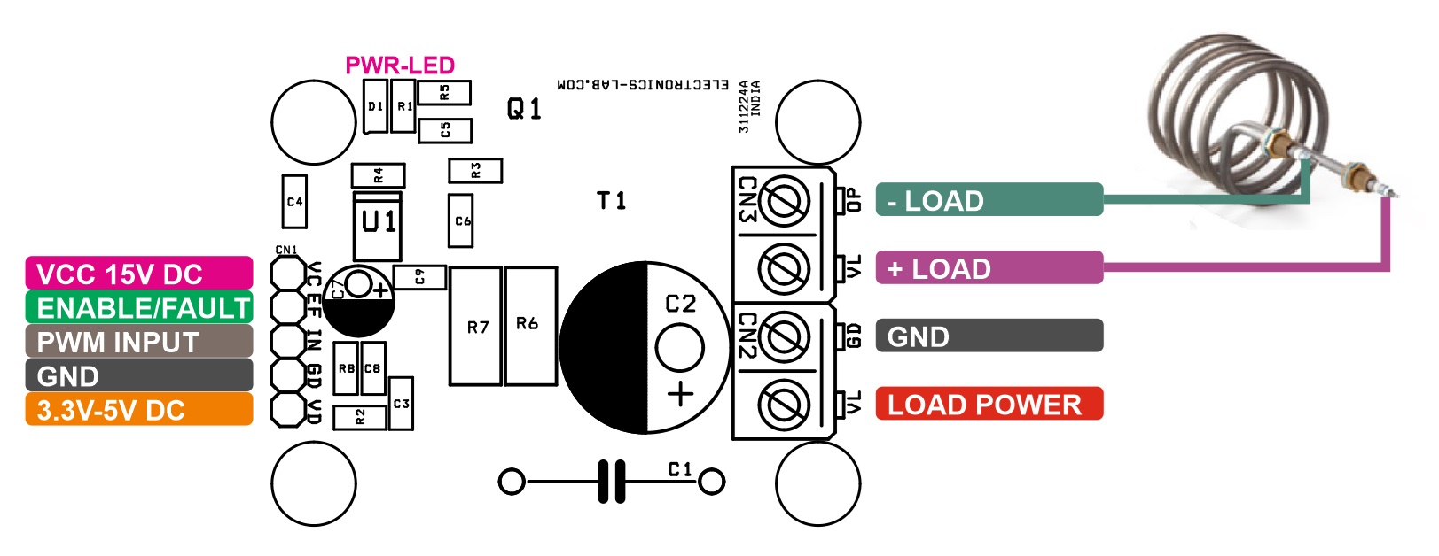

Connections
  • CN1: Pin 1 = VCC 12V-16V, Pin 2 = Enable/Fault, Pin 3 = PWM/Signal Input, Pin 4 GND, Pin 5 = VDD 3.3V-5V DC
  • CN2: Pin 1 = Load Power 80V-400VD, Pin 2 = GND
  • CN3: Pin 1 = +Load, Pin 2 = -Load
  • D1: Power LED

Input – Output Table

VCC Undervoltage Protection Diagrams

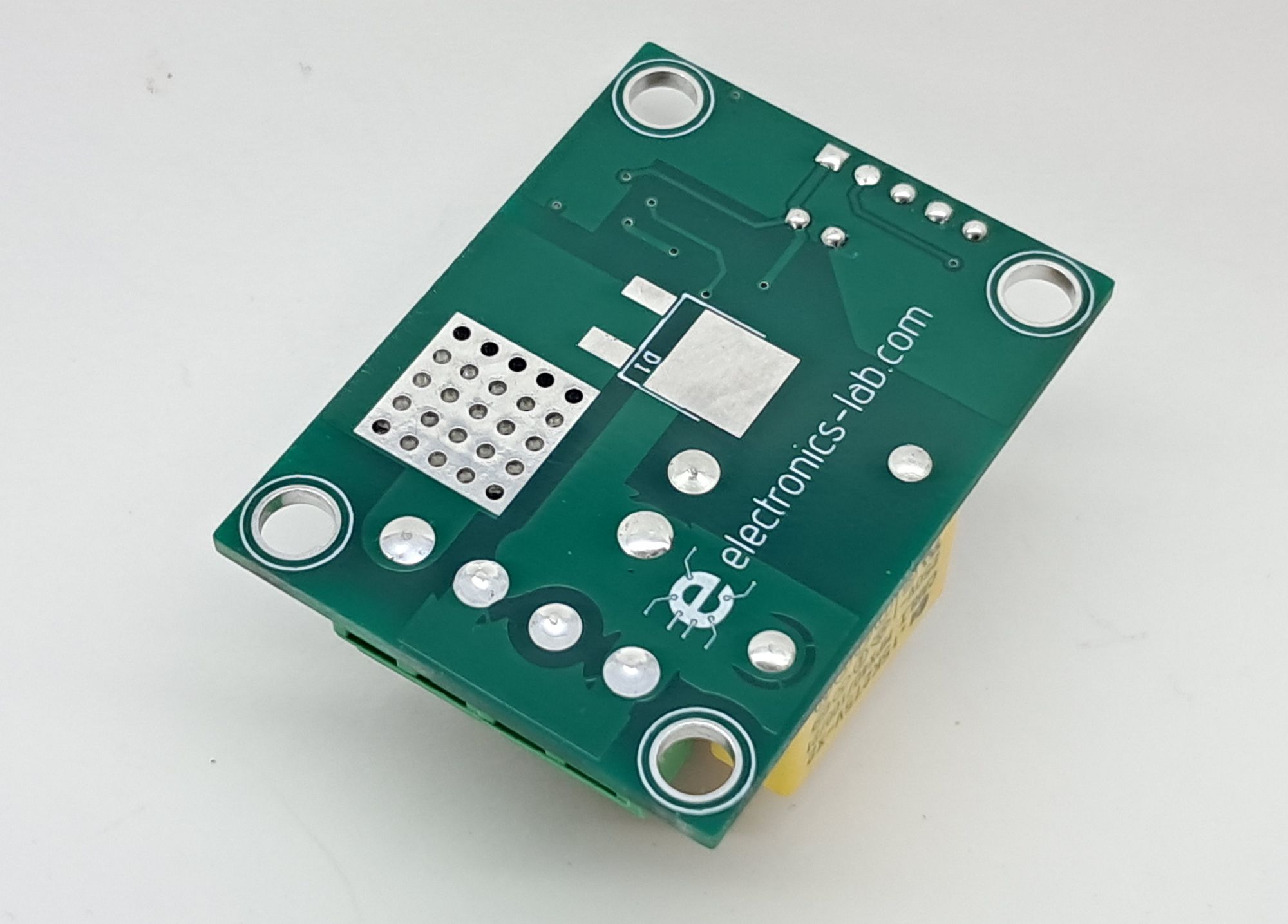

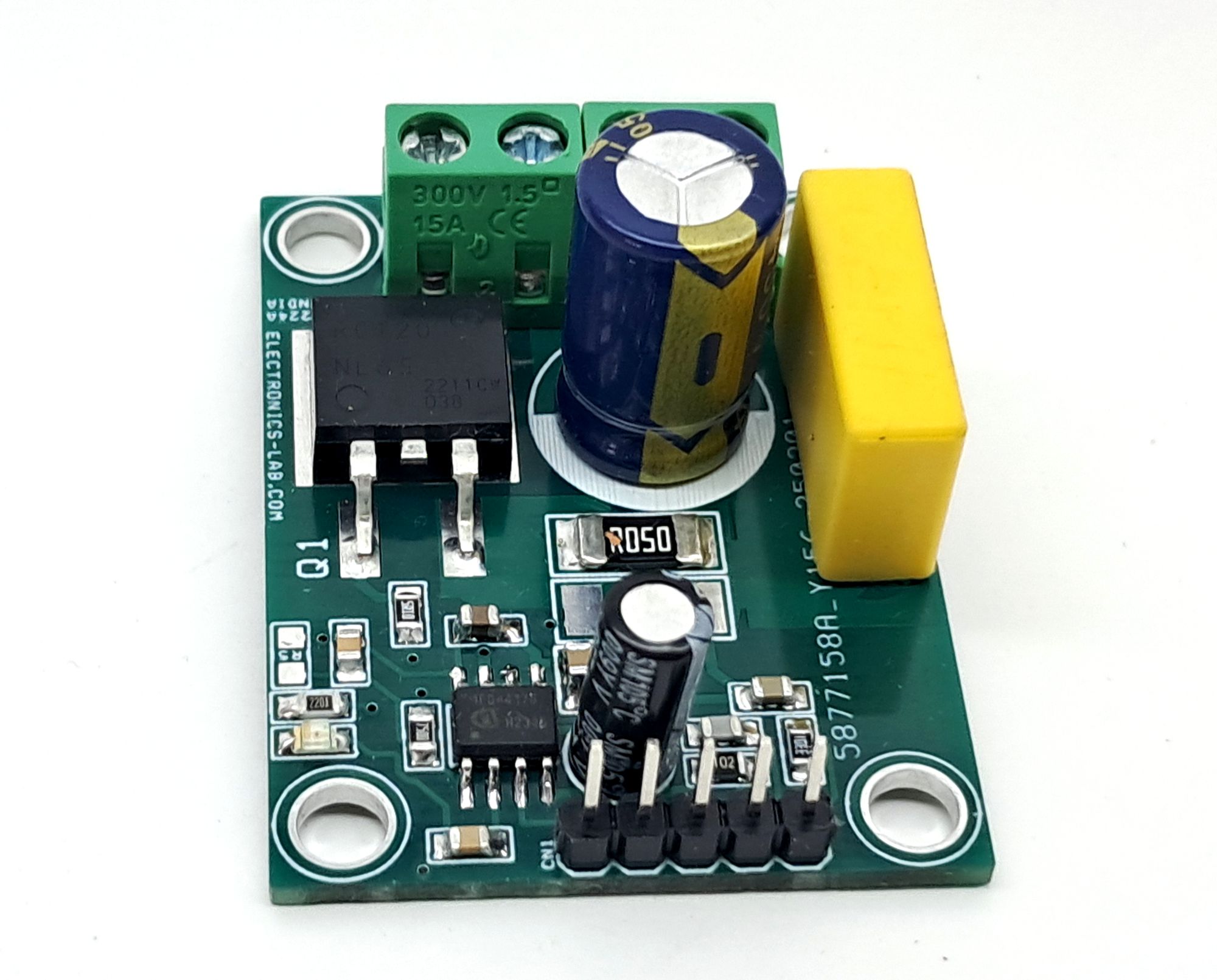

Photos
