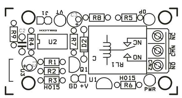

One Channel Infra-Red Remote and receiver with onboard Relay provides normally open and normally closed output. The project based on PIC12F683 Microcontroller from Microchip , TSOP1738 used as Infra-Red receiver.
One Channel Infra-Red Remote and receiver with onboard Relay provides normally open and normally closed output. The project based on PIC12F683 Microcontroller from Microchip , TSOP1738 used as Infra-Red receiver. Micro-controller decodes the RC5 serial data coming from TSOP1738 and provides high output if the data is valid. The output can be set Momentary or Latch using on board Jumper (J1) and closure. The board provided with 3 LEDs, Power LED, Valid Transmission LED and Output LED. This Remote works with switch No1 of RC5 Remote.
- Power Supply Remote 2X AA Batteries
- Power Supply Receiver 7-12V DC
- Current Consumption Receiver 30mA
- Onboard jumper for momentary and latch operation selection
- Transmitter range 10-15 feet
- RC5 (Philips) Remote
- Onboard power LED
- Onboard output ON/OFF LED
- Onboard Valid Transmission LED
- Onboard 5V regulator

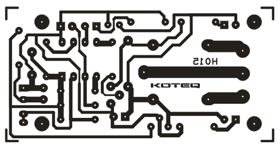

- PCB Dimensions 59.06 MM X 29.53 MM

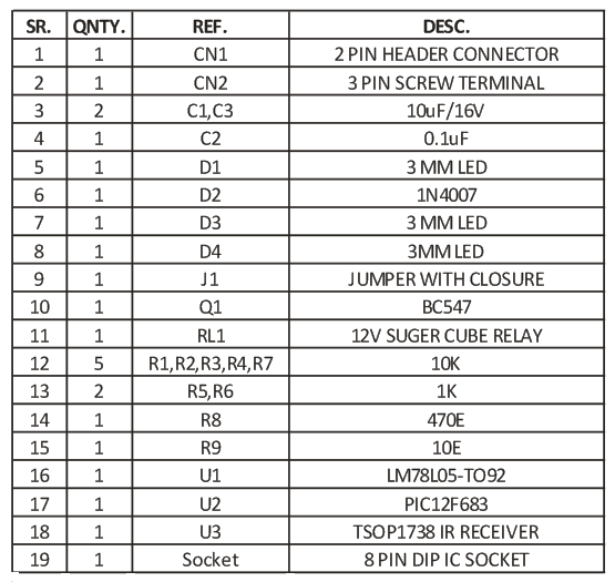

What do the capacitors in the circuit do?
They are used to filter the DC voltage from noise.
What is the function of the jumper on the GP4 pin?
