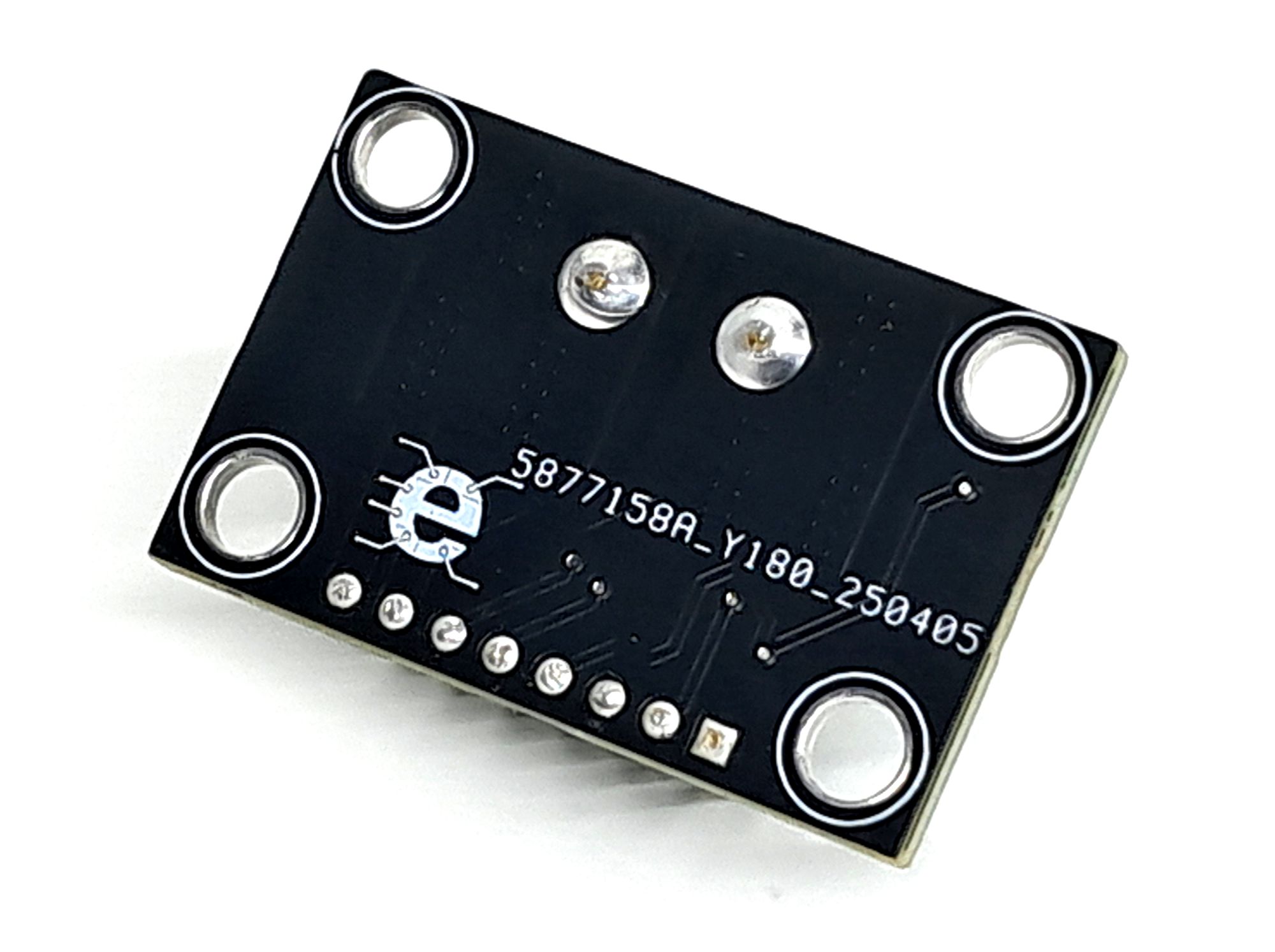

- PCB Dimensions 36.20 x 23.34 mm
- 4 x 4MM Mounting Holes

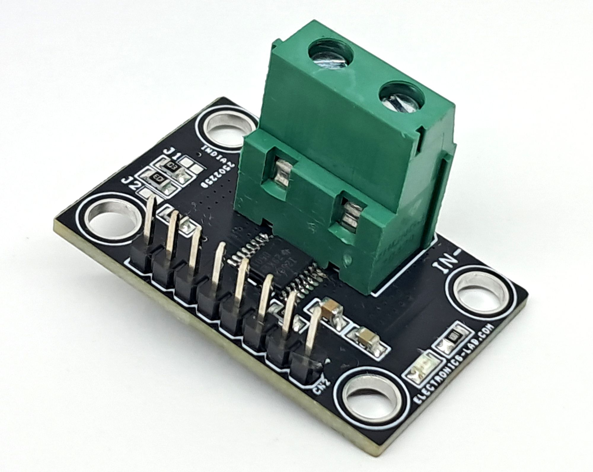

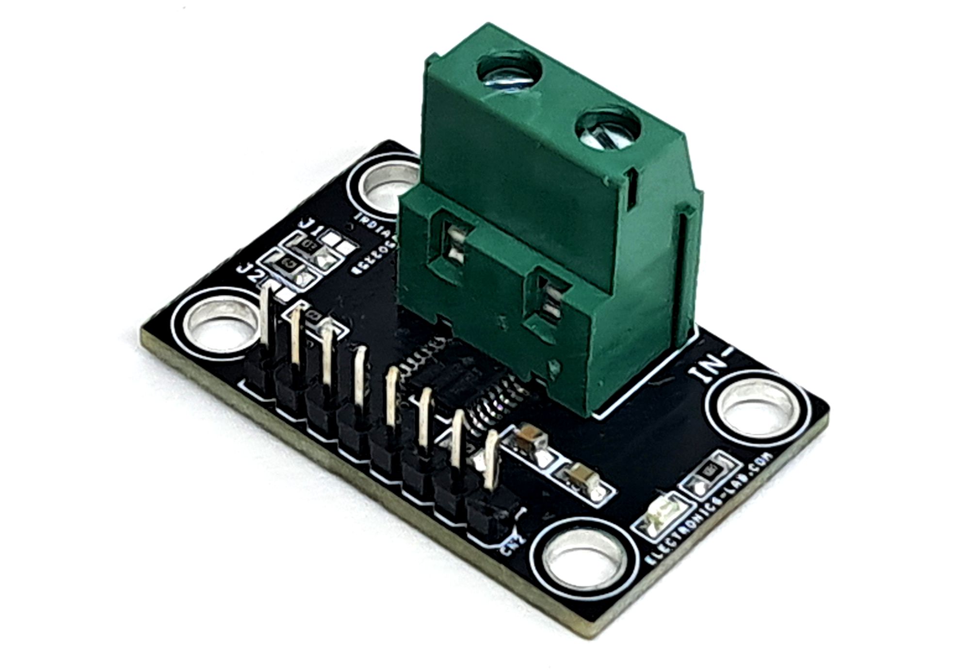

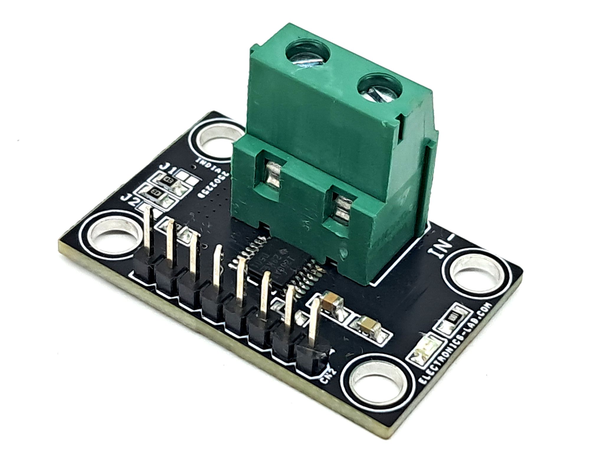

Connections
- CN1: Pin 1 = +IN/Current Sense, Pin 2 = -IN/Current Sense
- CN2: Pin 1 = Alert, Pin 2 = SDA, Pin 3 = SCL, Pin 4 = VCC, Pin 5 = GND, Pin 6 = VBUS, Pin 7 = +IN, Pin 8 = -IN
- Jumper 1, Jumper 2: Solder Type, Address Jumpers
- D1: Power LED

| NO | QNTY. | REF | DESC. | MANUFACTURER | SUPPLIER | SUPPLIER PART NO |
| 1 | 1 | CN1 | 2 PIN SCREW TERMINAL PITCH 7.62MM | WURTH | DIGIKEY | 732-10975-ND |
| 2 | 1 | CN2 | 8 PIN MALE HEADER PITCH 2.54MM | WURTH | DIGIKEY | 732-5321-ND |
| 3 | 1 | C1 | 10uF/16V CERAMIC SMD SIZE 0805 | YAGEO/MURATA | DIGIKEY | |
| 4 | 1 | C2 | 100nF/50V CERAMIC SMD SIZE 0805 | YAGEO/MURATA | DIGIKEY | |
| 5 | 1 | D1 | LED RED SMD SIZE 0805 | OSRAM | DIGIKEY | 475-1278-1-ND |
| 6 | 2 | J1,J2 | JUMPER SOLDER TYPE/PCB | |||
| 7 | 1 | R1 | 1K 5% SMD SIZE 0805 | YAGEO/MURATA | DIGIKEY | |
| 8 | 4 | R2,R3,R4,R5 | 10K 5% SMD SIZE 0805 | YAGEO/MURATA | DIGIKEY | |
| 9 | 1 | U1 | INA260 16TSSOP | TI | DIGIKEY | 296-47777-1-ND |
