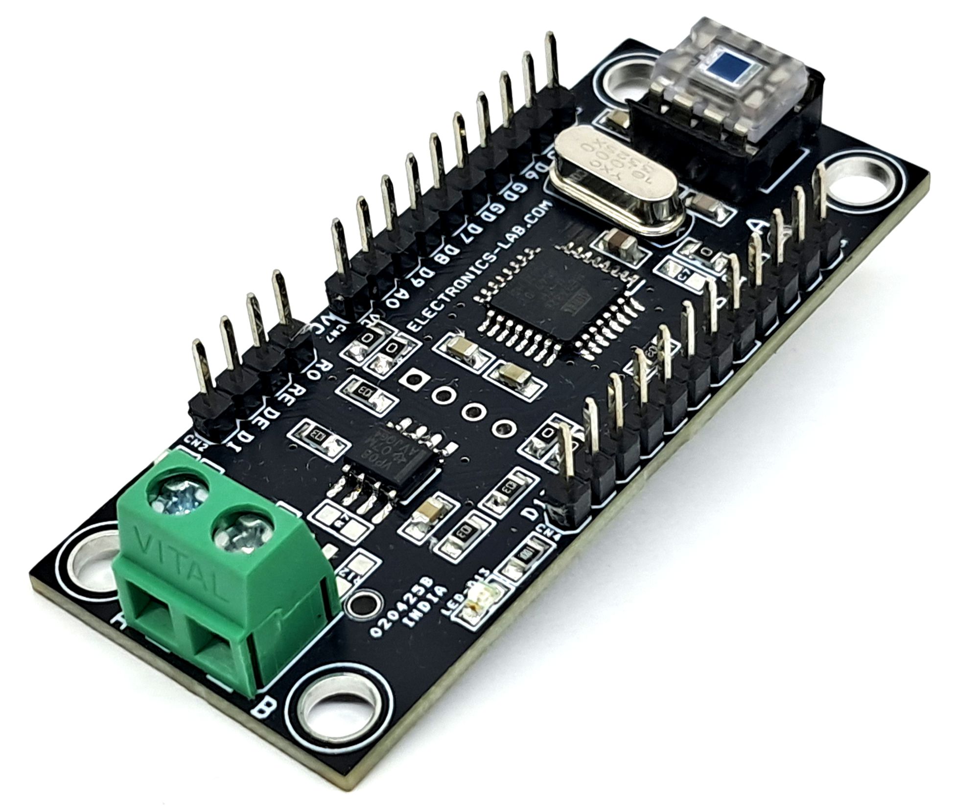

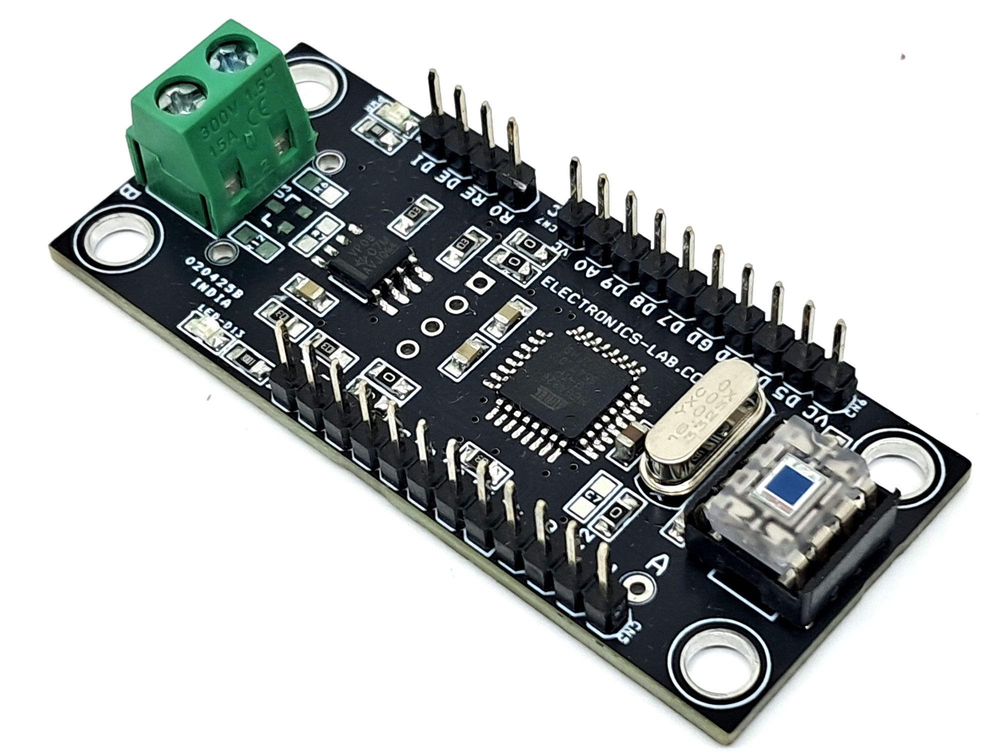

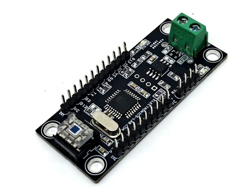

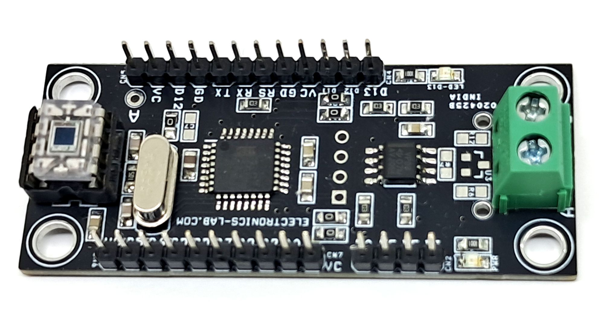

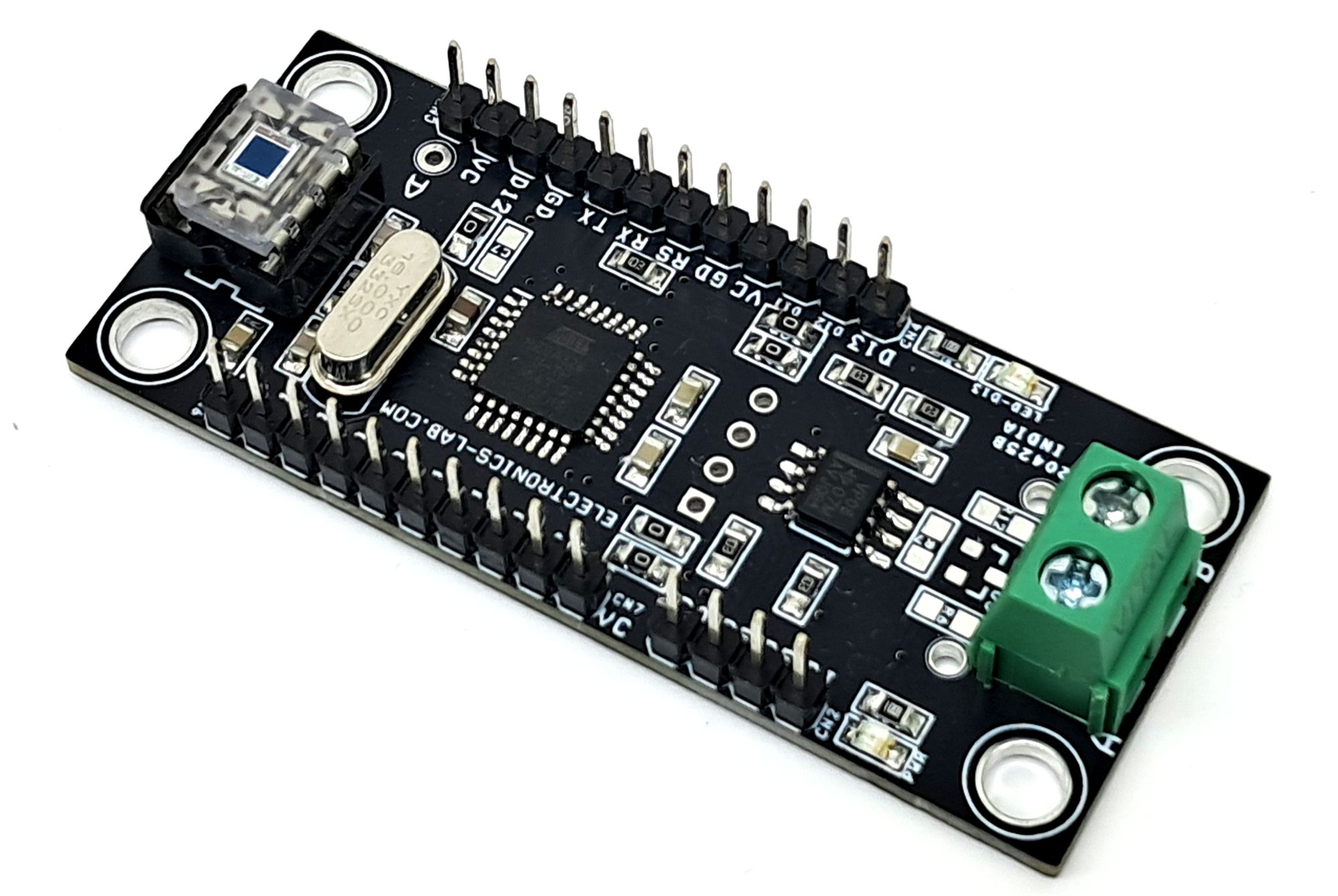

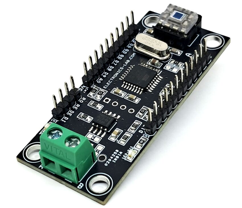

RS485 Light Sensor Interface Board
This ATmega328-based, Arduino-compatible board integrates an OPT101 light sensor and an SN65HVD485E transceiver to provide a complete, ready-to-use platform for developing RS485 network sensors with optional OLED display support.
This Arduino-compatible hardware is primarily designed for RS485-based applications. It features an ATmega328 microcontroller, RS485 SN65HVD485E Half-Duplex RS-485 Transceiver chip, OPT101 light sensor, multiple I/O lines, and a provision for mounting a 0.96-inch OLED display.
A simple and practical example application is a light sensor system communicating over RS485. Screw terminals are provided for easy connection of the RS485 A and B twisted pair cables, while all other I/O lines are accessible through header connectors.
This board is ideal for developing light-sensing and other sensor-based RS485 communication projects.

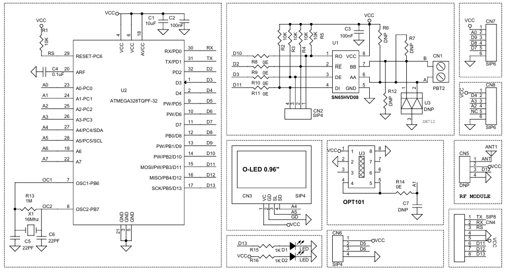

Note: OPT101 Light Sensor Conned to A1 Analog pin of Arduino
SN65HVD485E Half-Duplex RS-485 Transceiver vs Arduino Pins
  • RO= Arduino D10
  • RE = Arduino D2
  • DE = Arduino D3
  • DI = Arduino D11

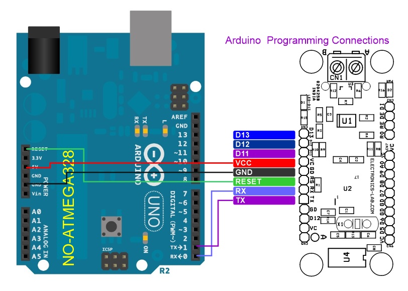

Arduino Programming
  • Supply 5V DC
  • OPT101 Light Sensor on Board
  • RS485 Communication (Half-Duplex)
  • Screw Terminal for RS485 Connection
  • RS485 Bus-pin ESD protection up to 15 kV
  • RS485 Bus-open-failsafe receiver
  • Glitch-free power-up and power-down bus inputs and outputs
  • Multiple I/O Lines Available for Interface
  • On Board Power LED
  • On Borad Function LED Connected to D13
  • On Board Optional 0.96 OLED Display
  • On Board Optional RF433 MHz RF Module
  • 4 x 4 mm Mounting Holes
  • PCB Dimensions 62.55 x 26.51 mm

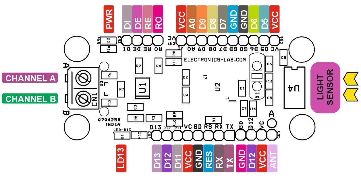

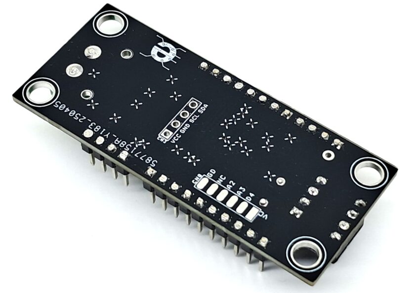

Connections
  • CN1: Pin 1 = RS485 Channel B, Pin 2 = RS485 Channel A
  • CN2 RS485 Chips I/O: Pin 1 = RO, Pin 2 = RE, Pin 3 = DE, Pin 4 = DI
  • CN3: OLED Display Optional

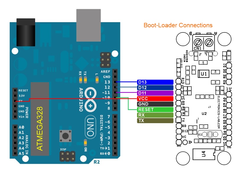

  • CN4 Programming Connector: Pin 1 = TX, Pin 2 = RX, Pin 3 = Reset, Pin 4 = GND, Pin 5 = VCC, Pin 6 = D11, Pin 7 = D12, Pin 8 = D13
  • CN5: Optional RF 433 MHz RF Module
  • CN6: Pin 1 = VCC, Pin 2 = D5, Pin 3 = D6, Pin 4 = GND
  • CN7: Pin 1 = VCC, Pin 2 = A0, Pin 3 = D9, Pin 4 = D8, Pin 5 = D7, Pin 6 = GND
  • CN8: Pin 1 = VCC, Pin 2 = D4, Pin 3 = A3, Pin 4 = A2, Pin 5 = NC, Pin 6 = GND
  • D1: LED Connected to D13
  • D2: Power LED
Schematic
