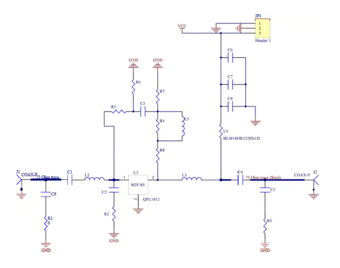

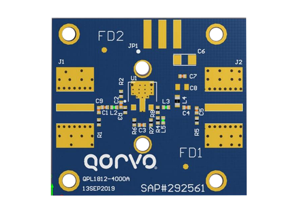

Qorvo QPL1812EVB-01 Evaluation Board
Qorvo QPL1812EVB-01 Evaluation Board is a demonstration and development platform for the QPL1812 Single Ended Amplifier. The QPL1812 is a 75Ω CATV amplifier with a high gain of 19dB, high linearity, and low distortion from 50MHz to 1800MHz. The Qorvo QPL1812EVB-01 Evaluation Board in combination with the QPL1812 amplifier is ideal for broadband cable applications.
