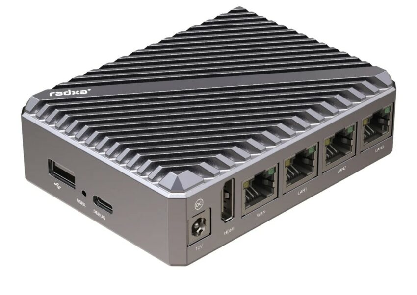

The Radxa E24C is a fanless network-embedded mini router based on the Rockchip RK3528A SoC, equipped with four Gigabit Ethernet ports, 4K HDMI video output, and an M.2 NVMe slot for high-speed storage in a compact enclosure, designed for routing, edge networking, and industrial tasks. The Radxa E24C builds upon the dual Gigabit Ethernet Radxa E20C mini network Titan.
Radxa E24C Fanless Network Router
The Radxa E24C builds upon the dual Gigabit Ethernet Radxa E20C mini network Titan. The front and side panels of the E24C include a DC power input, HDMI output, four configurable WAN/LAN Gigabit Ethernet ports, multiple USB 2.0 Type-A ports, and a USB Type-C port that supports OTG data transfer and UART debugging. The Radxa E24C is an ideal choice for network engineers, developers, and system integrators, providing a robust platform for deploying firewalls, VPN gateways, custom routers, and edge computing solutions.

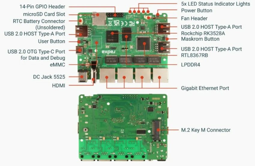

Radxa E24C specifications:
  • SoC: Rockchip RK3528A
  • CPU: Quad-core Arm Cortex-A53 processor @ up to 2.0GHz
  • GPU: Arm Mali-G450 GPU with support for OpenGL ES 1.1/2.0 and OpenVG 1.1
  • VPU:
    • Hardware video decoding: H.264, H.265, AVS2 up to 4Kp60
    • Hardware video encoding: H.264, H.265 up to 1080p60
  • System Memory: 1GB, 2GB, or 4GB LPDDR4 RAM
  • Storage:
    • 8GB, 16GB, or 32GB eMMC 5.1 flash
    • MicroSD card slot (UHS-I)
    • M.2 2280 Key-M slot (PCIe Gen2 x1) for NVMe SSD
  • Video Output: HDMI 2.1 port supporting up to 4Kp60
  • Networking: 4x Gigabit Ethernet RJ45 ports (via Realtek RTL8367RB switch)
  • USB:
    • 3x USB 2.0 Type-A host ports
    • 1x USB 2.0 Type-C OTG port (for serial and data)
  • Expansion: 14-pin GPIO header with SPI, UART, I2C, 5V, 3.3V, and GND
  • Debugging: USB Type-C port for serial console access
  • Misc:
    • Power, Maskrom, and User buttons
    • 5x status LEDs
    • RTC battery connector
    • Fan header
  • Power Supply: 12V/2A via 5.5 mm x 2.5 mm DC barrel jack
    • Power Consumption:
      • Idle: ~5W
      • Full load: up to 12W
  • Operating Temperature: 0°C to 70°C
  • Dimensions: 143 x 99 x 25.3 mm (with aluminum alloy enclosure for passive cooling)
Radxa E24C PCB specifications
