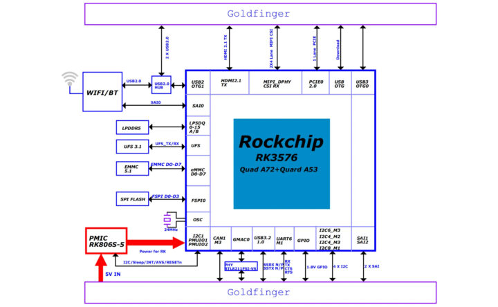

Radxa-NX4-SoM-Block-Diagram

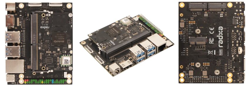

Radxa-NX4-SoM and IO Board Peripherals
Radxa NX4 IO Board specifications:
  • Compatibility: Radxa NX4 SoM (aforementioned in details)
  • Storage: M.2 M-Key 2280 slot for NVMe SSD via 1x PCIe 2.0
  • Display: 1x HDMI output
  • Camera: 2x MIPI CSI connectors, 4-lane each
  • Networking:
    • Gigabit Ethernet RJ45 port
    • PoE support (requires additional PoE HAT)
  • USB:
    • 4x USB 3.2 Type-A ports
    • 1x USB 3.2 Type-C port
  • Expansion:
    • M.2 M-Key 2280 socket
    • M.2 M-Key 2230 socket (Reserved but not supported by the NX4)
    • M.2 E-Key 2230 socket (Reserved but not supported by the NX4)
    • 40-pin GPIO header with I2C, SPI, UART, PWM, and GPIOs
  • Misc:
    • 4-pin PWM fan connector
    • 2-pin RTC battery connector
    • 4-pin CAN bus header
    • 12-pin Button Header
  • Power Supply:
    • 9 to 20V DC via 5.5 × 2.5 mm DC barrel jack
    • 1x 2-Pin PoE Backpower Header
    • 1x 4-Pin PoE Header
  • Dimensions: 100 mm x 79 mm
