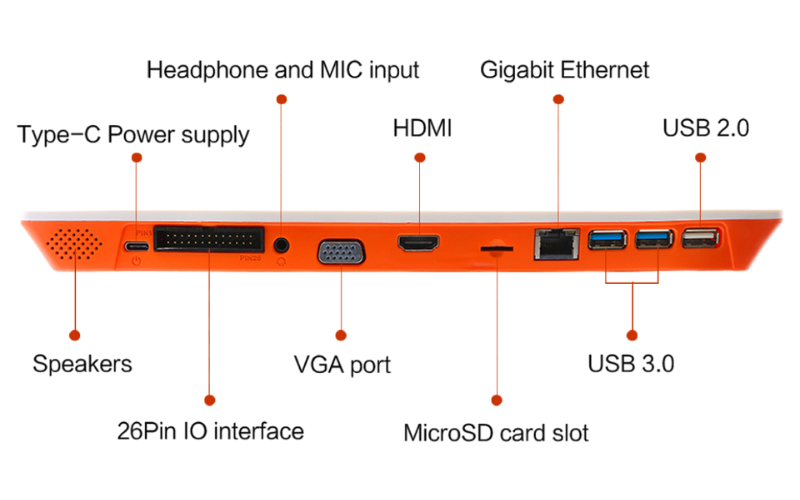

  • Expansion: 1x HDMI 2.0 and 1x VGA (for video), 2x USB 3.0
  • GPIOs: 26 pins
  • Power: USB Type-C
  • Dimensions: 286x122x22 mm
  • Weight: 385 grams
