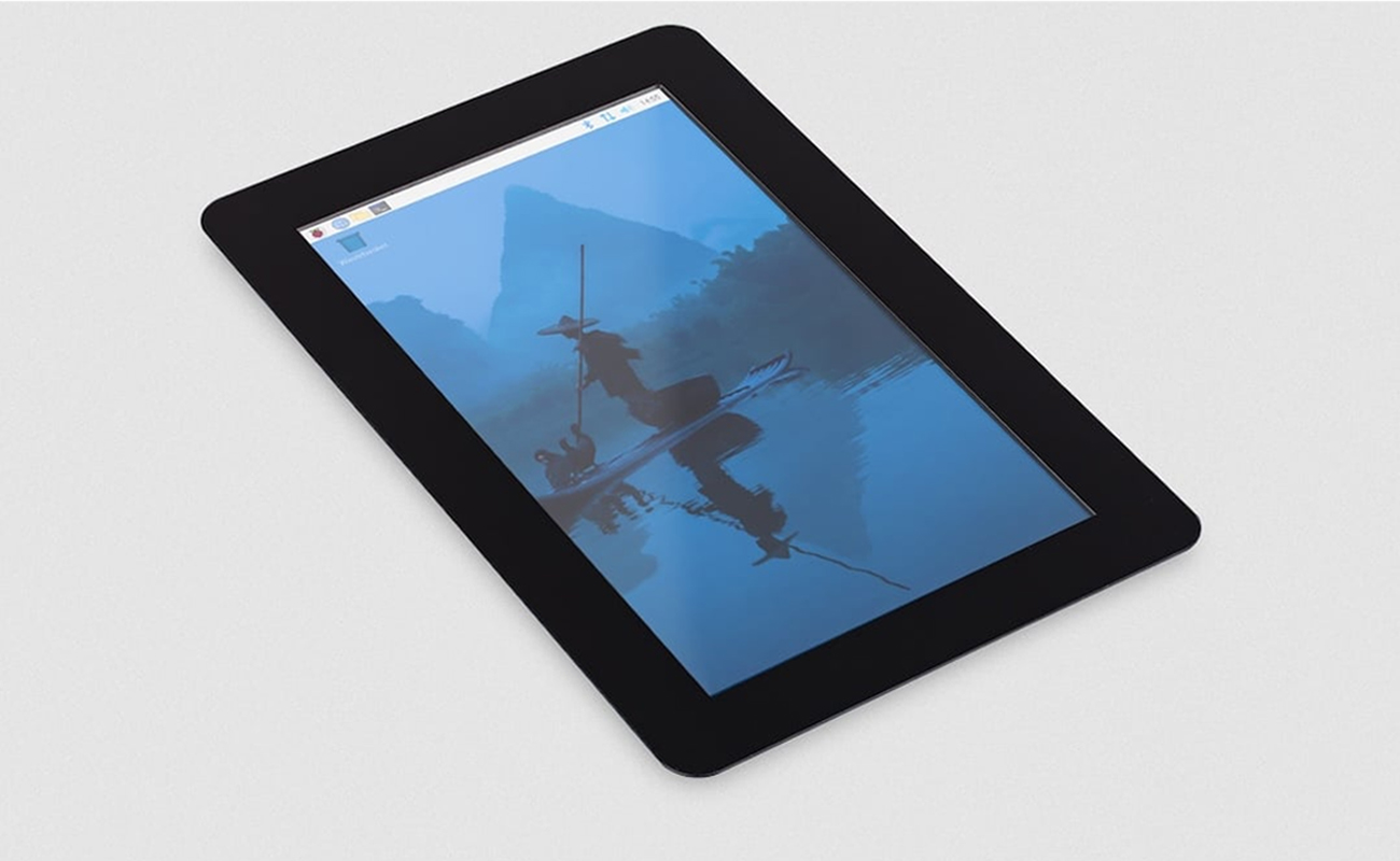

Raspberry Pi Touch Display 2 is A 7-inch Capacitive Touchscreen with 720×1280 Resolution
Raspberry Pi has recently launched its Touch Display 2, a 7-inch touchscreen display designed for Raspberry Pi computers. With a resolution of 720 × 1280 pixels, the display features a TFT LCD with anti-glare treatment and a five-finger capacitive touch panel.
Raspberry Pi has recently launched its Touch Display 2, a 7-inch touchscreen display designed for Raspberry Pi computers. With a resolution of 720 × 1280 pixels, the display features a TFT LCD with anti-glare treatment and a five-finger capacitive touch panel. It connects to Raspberry Pi devices via a ribbon cable to the DSI port and power from the GPIO port, supporting all models except the Raspberry Pi Zero line. Key specifications include a viewing angle of up to 70 degrees, LED backlight, and RGB-stripe colour configuration. The display must operate in a 0–50°C environment and users must handle it carefully to avoid damage. It is supported by compliance with regional standards and guaranteed production until at least January 2030. An intuitive interface is offered by applications ranging from personal projects to professional dashboards, without a keyboard or mouse.

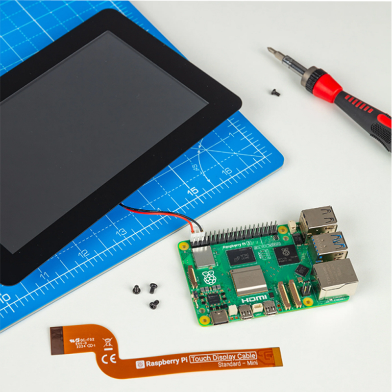

Touch Display 2 with Raspberry Pi 5 module
The back of the display features four mounting holes compatible with the Raspberry Pi 5 and other Raspberry Pi boards. It connects via a ribbon cable to the MIPI DSI port, while a 3-pin connector for 5V and GND plugs into the 40-pin GPIO header to supply power.

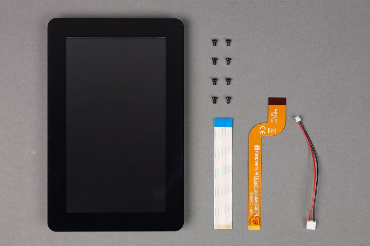

Box contains: Touch Display 2, eight M2.5 screws, 15-way to 15-way FFC, 22-way to 15-way FFC for Raspberry Pi 5, GPIO connector cable
