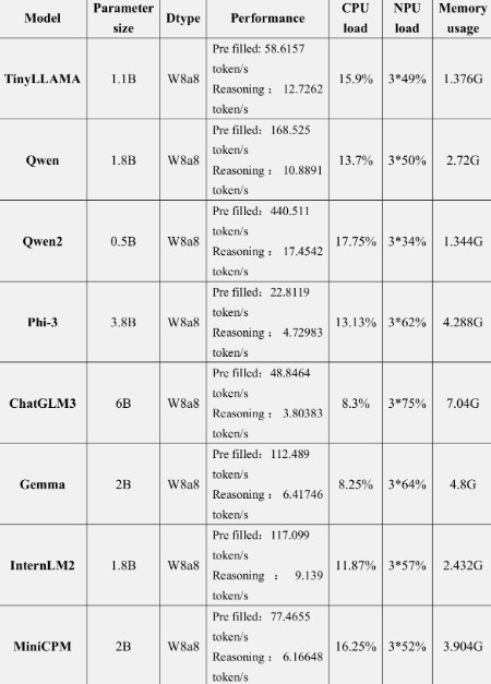

Radxa tested various models and reported the following performance on Rockchip RK3588(S) hardware:
  • TinyLlama 1.1B: 15.03 tokens/s
  • Qwen 1.8B: 14.18 tokens/s
  • Phi3 3.8B: 6.46 tokens/s
  • ChatGLM3: 3.67 tokens/s

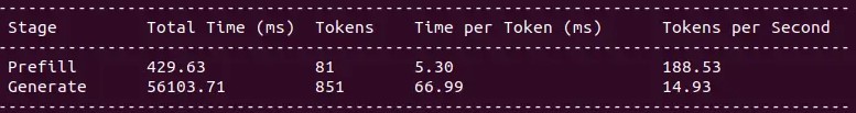

When it was tested with DeepSeek-R1 (Qwen 14B) on the GPU of the Rockchip RK3588 SoC, we achieved 1.4 token/s and later had to install an AMD W7700 graphics card on it for better performance. When it was tested with DeepSeek R1 (Qwen2 1.5B) on an NPU, we achieved almost 15 tokens/s.
DeepSeek is perfectly adapted and operates efficiently on Arm based SoM like Rockchip RK3588, RK3588S, or RK3576 development boards. The above demo was tested on Radxa ROCK5 Model B RK3588 SoC and DeepSeek R1 (Qwen 1.5B) running the Banana Pi BPI-M7 board (RK3588).
