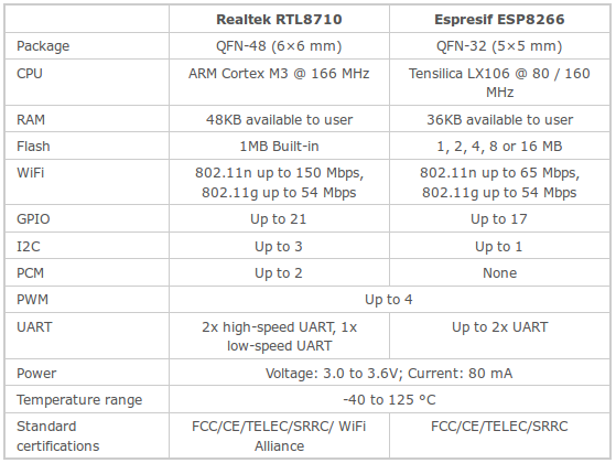

RTL8710 is a Wifi network solution from the Taiwanese Company Realtek. It can operate independently, or as a slave to another MCU host. The same way of ESP8266.
RTL8710 has a built-in ARM Cortex M3 MCU at 166 MHz, 1MB flash and peripherals like UART, PWM, I2C, GPIO and PCM, a more detailed comparison is shown in the  table bellow:
Table courtesy of cnx-software
