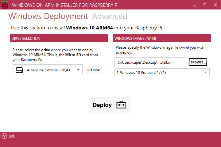

You can use this third-party installer if you already have a Raspberry Pi 3 Model B (or B+) and a MicroSD card with A1 rating. To install Windows 10 ARM on Raspberry Pi 3, please follow the steps below:
  1. Download the Windows 10 ARM image, WoA installer and Core Packages from here.
  2. Run WoA Installer and go to the Advanced section.
  3. Click on ‘Import Core Package’ option and select the package directly.
  4. After importing, you will be allowed to use deploy Windows option.
