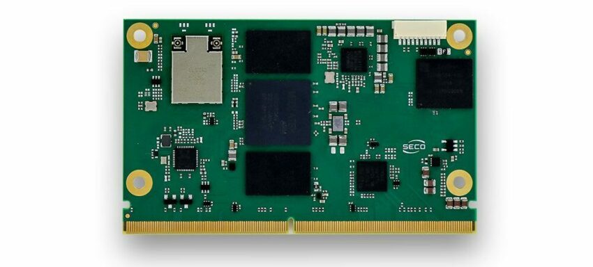

SECO has unveiled two new SMARC system-on-modules: the SOM-SMARC-Genio510 and SOM-SMARC-Genio700, powered by MediaTek Genio 510 and 700 SoCs featuring Cortex-A78 and Cortex-A55 cores. These industrial-grade modules are designed for high power efficiency, delivering reduced energy consumption even during intensive edge AI workloads.
SOM-SMARC-Genio500 with MediaTek Genio 510
SECO has unveiled two new SMARC system-on-modules: the SOM-SMARC-Genio510 and SOM-SMARC-Genio700, powered by MediaTek Genio 510 and 700 SoCs featuring Cortex-A78 and Cortex-A55 cores. These industrial-grade modules are designed for high power efficiency, delivering reduced energy consumption even during intensive edge AI workloads. They are well-suited for applications such as retail touchscreens, intelligent industrial sensors, advanced conferencing systems, and dynamic digital signage.
The SOM-SMARC-Genio510, powered by the MediaTek Genio 510, offers industrial-grade performance optimized for demanding AI tasks. It supports up to 8GB of LPDDR4 memory, 64GB of eMMC flash storage, dual Ethernet interfaces via RGMII, USB connectivity, camera inputs, and an optional M.2 slot for Wi-Fi and Bluetooth modules, providing versatile connectivity and expansion options.

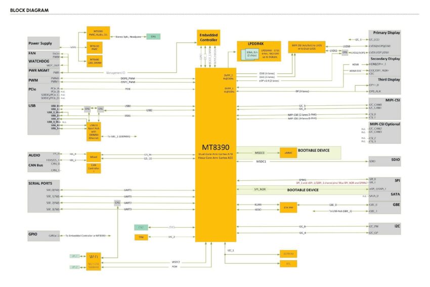

SOM-SMARC-Genioxxx block diagram
