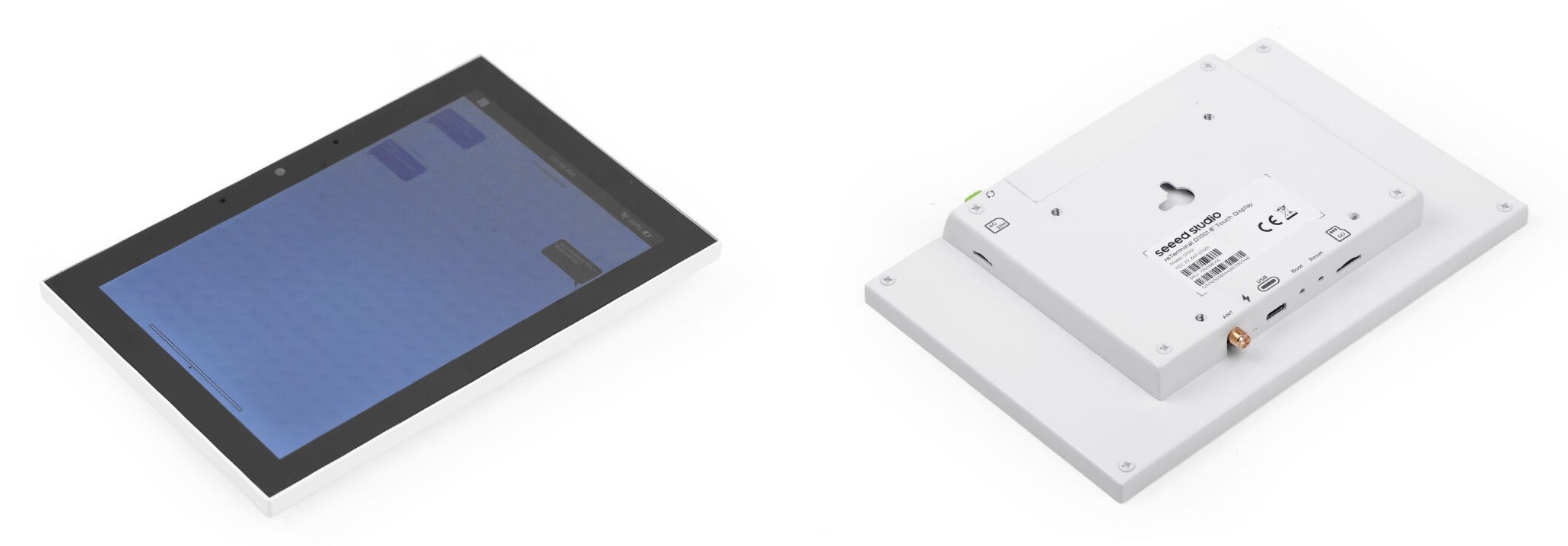

reTerminal D1001 8-inch LCD Touch Display Front and Back Side

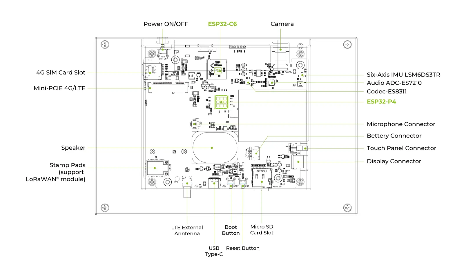

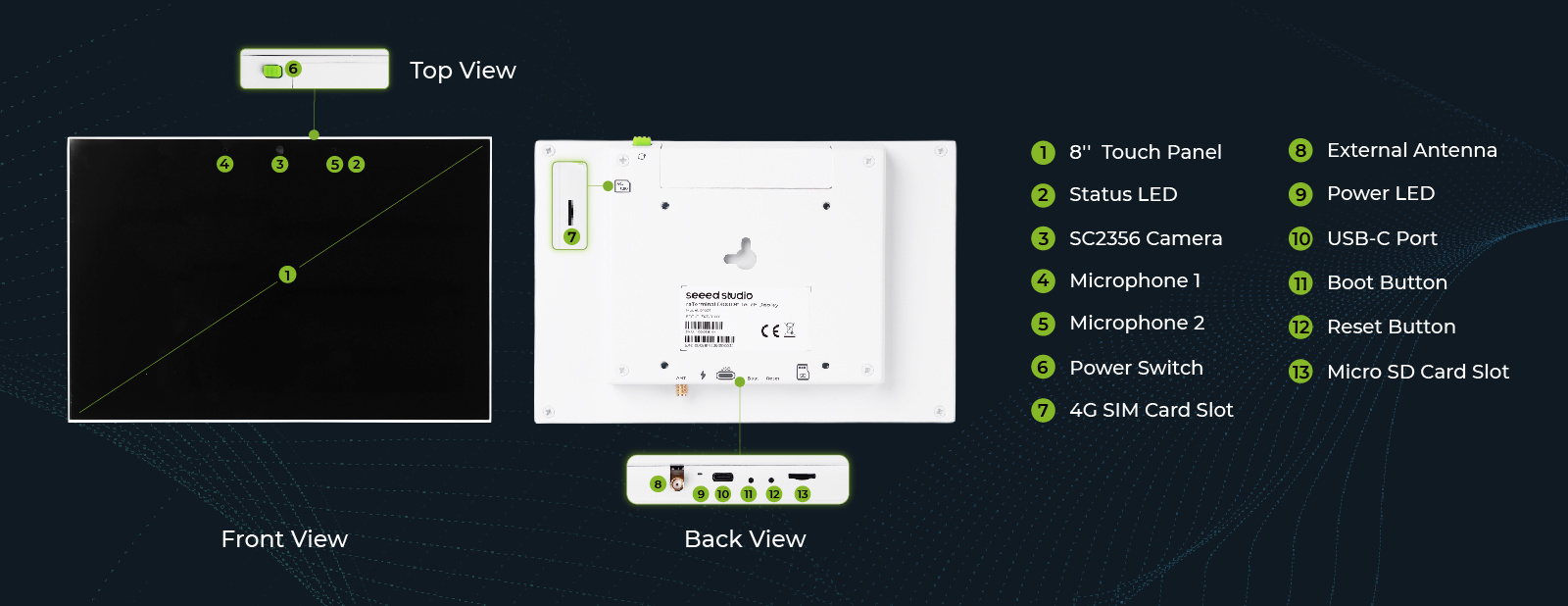

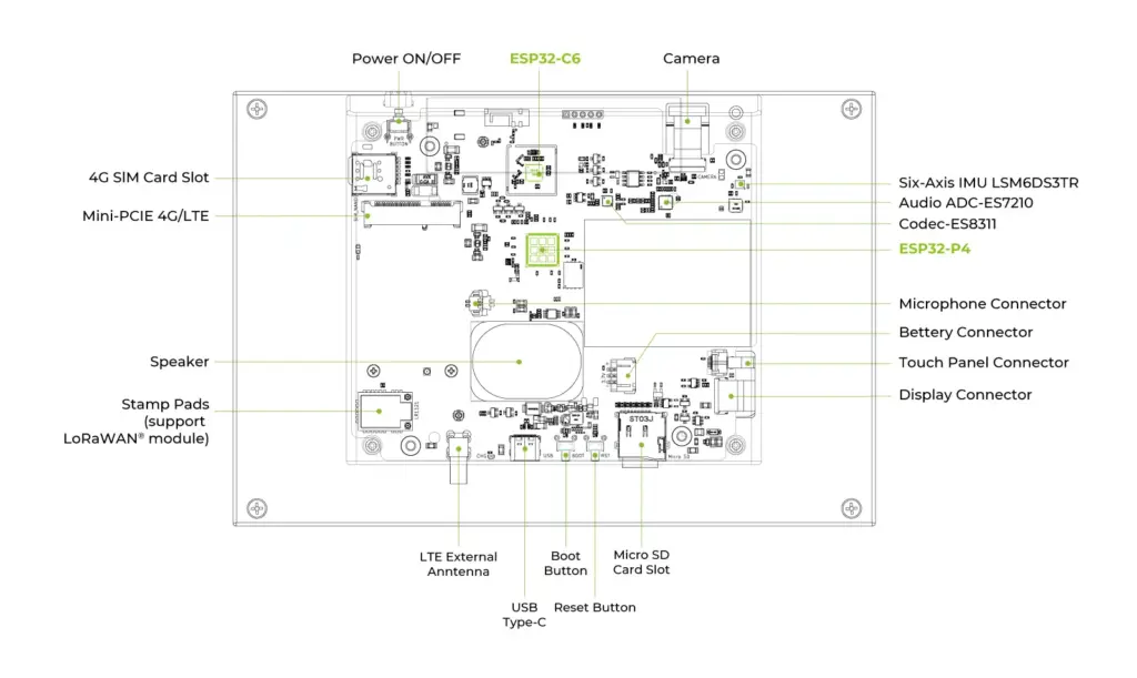

reTerminal D1001 Specifications:
  • SoC: ESP32-P4NRW32 dual-core RISC-V processor @ 400 MHz with 32MB PSRAM
  • Wireless: ESP32-C6 (Wi-Fi 6 2.4 GHz + Bluetooth 5 LE via SDIO)
  • Storage: 32MB QSPI flash, MicroSD card support
  • Display: 8-inch LCD Touch Display, 800 × 1280 resolution, MIPI-DSI interface
    • Brightness: 250 cd/㎡
    • Viewing angle: All
    • Driver IC: 9365DA-H3
  • Touch: Capacitive touch panel with GSL3670 controller
  • Orientation: Portrait / Landscape supported
  • Camera: 2MP SC2356 MIPI-CSI camera
    • Resolution: 1608 × 1208
    • Video: up to 1600 × 1200 @ 30 fps (10-bit)
  • Audio:
    • Dual microphones
    • Speaker: 2W @ 8Ω (NS4150B)
    • Codec: ES8311
    • ADC: ES7210
  • Connectivity:
    • Wi-Fi 6 (2.4 GHz)
    • Bluetooth 5 LE
    • Mini-PCIe slot for optional 4G module
    • Onboard + external antenna
  • Sensors and RTC:
    • LSM6DS3TR (accelerometer + gyroscope)
    • RTC: PCF8563T (timed wake-up support)
  • Expansion and I/O:
    • USB Type-C (power, debug, flashing)
    • GPIO, I2C, UART
    • Dual-row 2.54mm header
  • Misc:
    • Integrated LCD Touch Display for HMI / AIoT applications
    • Supports camera, audio, wireless, and sensor-based edge applications
  • Power:
    • 2500mAh battery
    • USB Type-C 5V input
    • Onboard charging support
  • Dimensions: 200 x 136 x 25 mm

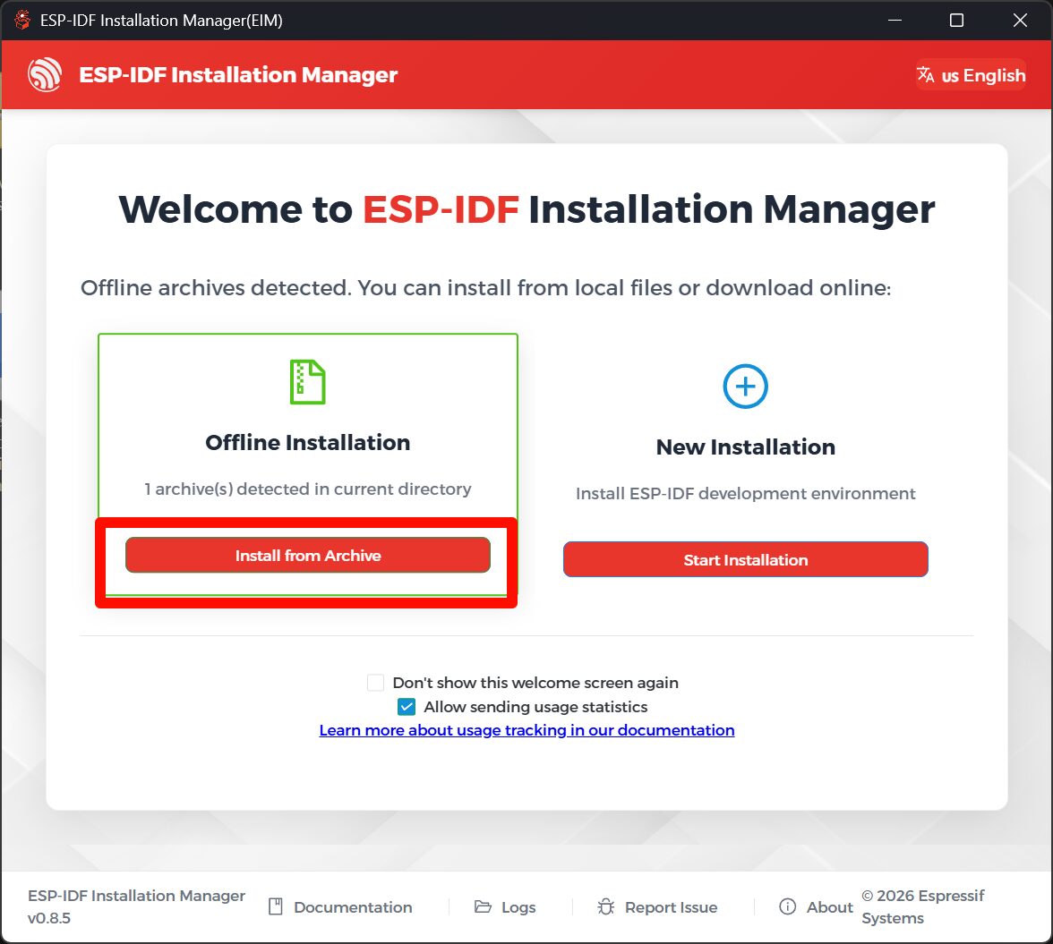

The platform uses the ESP-IDF framework, which gives you full control over hardware, peripherals, and real-time performance. You can install the ESP-IDF environment using Espressif’s installation manager and integrate it with Visual Studio Code for development. The official firmware repository includes factory demos that showcase UI rendering, camera preview, and sensor interaction. You can build, flash, and monitor firmware directly through VS Code, which simplifies development and debugging. If you struggle with embedded toolchains, this setup removes most friction and lets you focus on application logic instead of environment issues. More details available on the wiki page.
ESP-IDF Installation Manager
