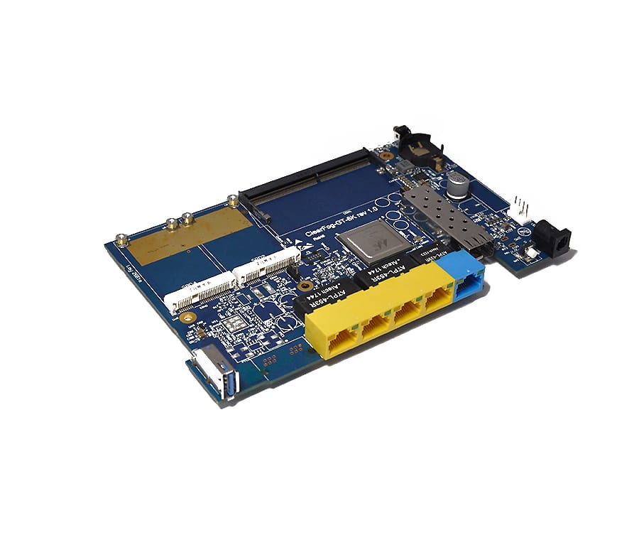

At the heart of the ClearFog GT 8K is the quad-core Marvell’s ARMADA A8040 SoC, running at a speed of 2GHz and some other co-processors like DMA, XOR, and, others. Ideally, it is expected for the ClearFog GT 8K to share some similar traits with its other ClearFog boards, but it has less in common with them. The Marvell’s Armada 8040 SoC features a networking accelerator with a security co-processor, enabling the ClearFog GT 8K with “full” virtualization support as claimed by SolidRun.
The launching of ClearFog GT 8K means that SolidRun has now upgraded its entire ClearFog family with this newer networking board, powered on the same ARMADA A8040 processor as on the community board, and offering support for up to 16GB RAM, 6 network interfaces, including one 10GbE Small Form-Factor Pluggable Transceiver (SFP+) cage which is useful for telecommunication or data communications applications, and three PCIe slots. There is also the presence of a small RTC or CMOS battery that maintains the time, date, hard disk and other configuration settings in the CMOS memory when the main battery is removed.
ClearFog GT 8K offers vast application potential as a versatile networking solution with a large variety of interfaces. It also allows network functions virtualization and high-end edge computing. The 177 x 110mm measured ClearFog GT 8K is larger than the ClearFog Base but smaller than the ClearFog Pro. It offers an extended 0 to 70°C operating range and adds a -40 to 85°C option. Showing its difference with its family, the ClearFog Pro has a 12V DC input as compared to the wide-range input found on the ClearFog Base and Pro.
This Single Board Computer is capable of running the Linux Kernel version 4.4x, Ubuntu 16.04, and Google IoT Core for easy connection to the Google Cloud Platform.

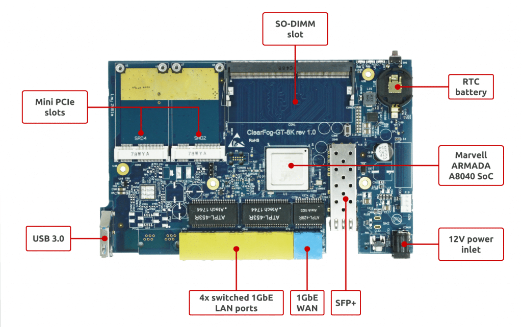

Below are specifications for the ClearFog GT 8K SBC
  • Processor — Marvell Armada 8040 (4x Cortex-A72 cores @ up to 2GHz); packet, security, DMA, and XOR co-processors
  • Memory/storage:
    • Up to 16GB of single-channel DDR4 RAM
    • 64Mb SPI flash
    • MicroSD slot
    • Optional up to 128GB eMMC
    • Optional M.2 (via adapter) for SSDs
  • Networking:
    • 1x 10GbE port via SFP+
    • 4x switched GbE ports with a 2.5GbE uplink to SoC
    • Dedicated WAN GbE port
  • Other I/O:
    • USB 3.0 port
    • Debug UART
    • GPIO
  • Expansion — 3x PCIe slots (USB 2.0 + PCIe); optional M.2 for SSD
  • Other features — User push buttons; LEDs; heatsink; RTC with battery; optional enclosure
  • Power — 12V DC input
  • Operating temperature — 0 to 70°C or -40 to 85°C
  • Dimensions — 177 x 110mm
  • Operating system — Linux 4.4x; Ubuntu 16.04; Google IoT Platform
