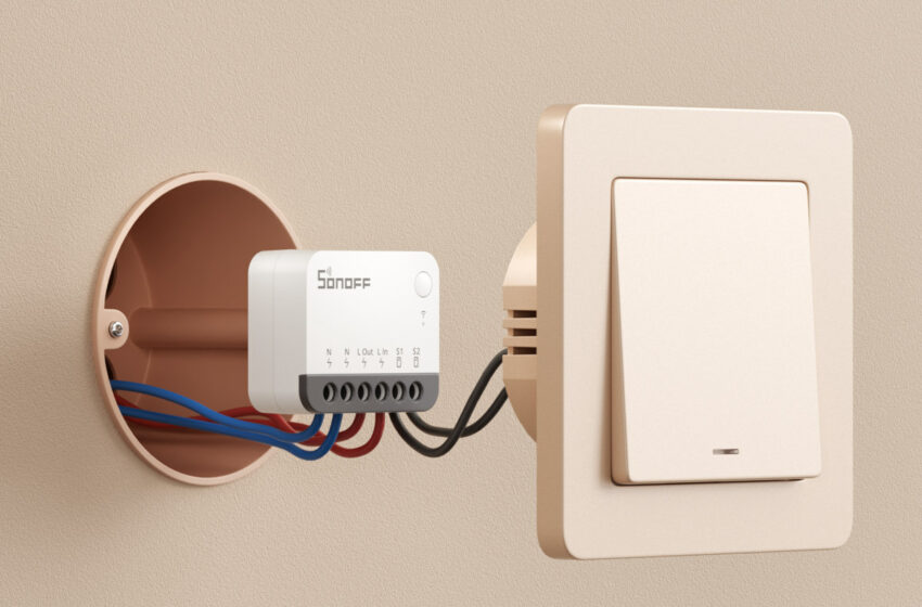

Measuring just 32x18x44mm, the ZBMINIR2 is one of the smallest Zigbee switches on the market, allowing it to fit seamlessly into most standard wall boxes. Despite its size, it delivers robust functionality, offering compatibility with Zigbee hubs such as Sonoff ZBBridge, Philips Hue, and SmartThings. It also integrates effortlessly with Amazon Alexa, Google Assistant, and the eWeLink App, enabling remote control, voice commands, and easy automation.

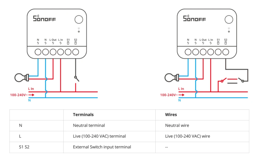

Wiring Instructions
Wiring Instructions
The ZBMINI Extreme not only operates as a switch but also enhances your Zigbee network by functioning as a router. This allows it to extend the network’s range and stability, ensuring that up to 64 Zigbee devices stay connected, even in large or complex home setups. Its compact design makes it ideal for installations in tight spaces, such as junction boxes, while transforming traditional lighting systems into smart solutions.
