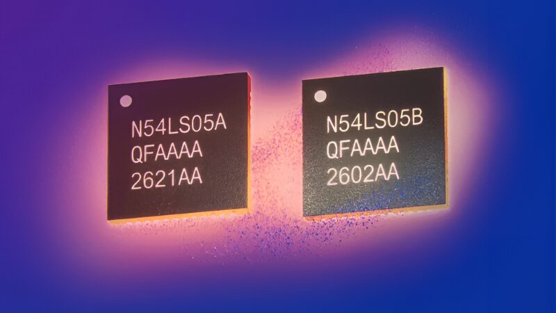

Nordic Semiconductor expands its nRF54L series with the n54LS05A and n54LS05B entry-level Bluetooth LE SoCs
Nordic Semiconductor expands its nRF54L series with the n54LS05A and n54LS05B entry-level Bluetooth LE SoCs. Image used courtesy of Nordic Semiconductor

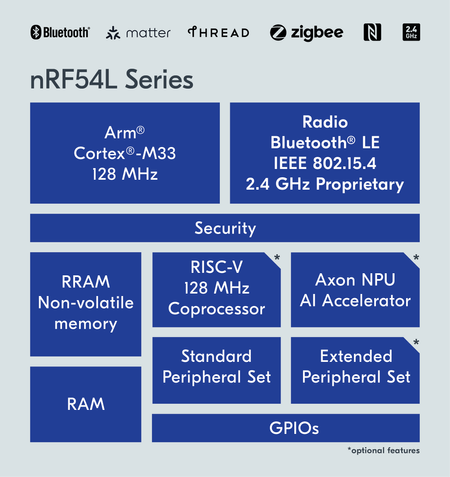

Nordic’s nRF54L series SoCs feature an Arm Cortex M33 running at 128 MHz
Nordic’s nRF54L series SoCs feature an Arm Cortex M33 running at 128 MHz. Image used courtesy of Nordic Semiconductor

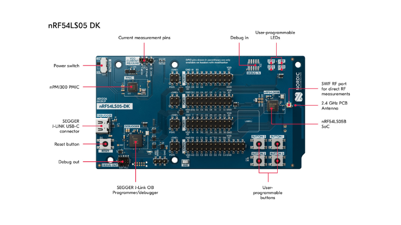

The nRF54LS05 DK development kit for the nRF54LS05A and nRF54LS05 SoCs
The nRF54LS05 DK development kit for the nRF54LS05A and nRF54LS05 SoCs. Image used courtesy of Nordic Semiconductor
