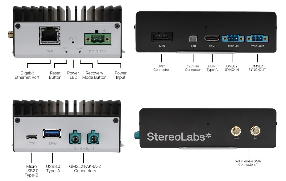

ZED Box Mini specifications:
  • System-on-Module options (NVIDIA Jetson Orin):
    • Orin Nano 4GB – 34 TOPS
    • Orin Nano 8GB – 67 TOPS
    • Orin NX 8GB – 117 TOPS
    • Orin NX 16GB – 157 TOPS
  • Storage: 256GB SSD via M.2 Key-M 2242 socket
  • Video output: 1x HDMI 1.4 or 2.1 port (module-dependent)
  • Camera Input:
    • 2x GMSL2 FAKRA-Z connectors
    • GMSL2 camera sync trigger input
    • GMSL2 camera sync trigger output
  • Networking:
    • 1x Gigabit Ethernet RJ45
    • Optional Wi-Fi 6 and Bluetooth via Intel AX210 on M.2 Key-E 2230
    • Dual 2.4/5GHz external Wi-Fi antennas
  • USB:
    • 1x USB 3.0 Type-A
    • 1x Micro USB 2.0 Type-B (for flashing and OTG)
  • Expansion: 10-pin GPIO with CAN. UART, 2x GPIO, 5V, 3.3V,  and GND
  • Misc.: 2-pin 12V fan connector (fan required in MAXN SUPER mode)
  • Power input: 10.5V to 13.5V DC input (up to 60W) via screwable terminal block
  • Dimensions:
    • Unit: 152.8 x 103.8 x 41.5 mm
    • Mounting holes: 92 x 45mm
  • Weight: 600g aluminum passive-cooled case

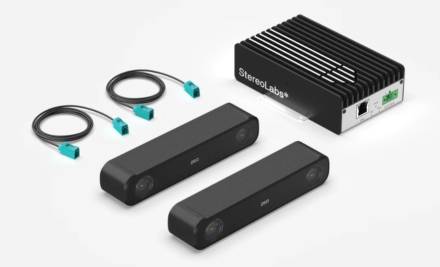

The ZED Box Mini ships with a power supply, two sync connectors (no cables provided), a micro USB to USB cable, and two Wi-Fi antennas (if Wi-Fi is selected at the time of order). The NVIDIA Jetson Orin Nano Super with Jetpack 6.2 introduces a key enhancement: the new MAXN SUPER and 25W reference power modes to increase computational power and flexibility.

The ZED Box Mini is available for purchase on the Stereolabs store, priced between $879 and $1,335, depending on the selected configuration. Stereolabs also offers a Dual Autonomy Kit, which includes two ZED X depth cameras and necessary cables, starting at $2,247. Additional details can be found in the official press release.
