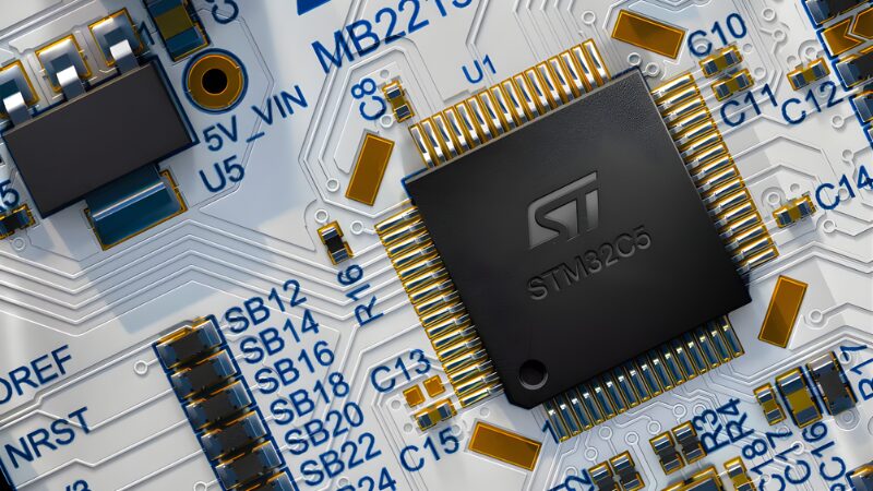

ST’s STM32C5 series MCUs are powered by an Arm Cortex-M33 embedded processor and ST’s 40 nm manufacturing process
ST’s STM32C5 series MCUs are powered by an Arm Cortex-M33 embedded processor and ST’s 40 nm manufacturing process. Image used courtesy of STMicroelectronics

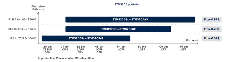

A look at ST’s STM32C5 MCU product portfolio
A look at ST’s STM32C5 MCU product portfolio. Image used courtesy of STMicroelectronics

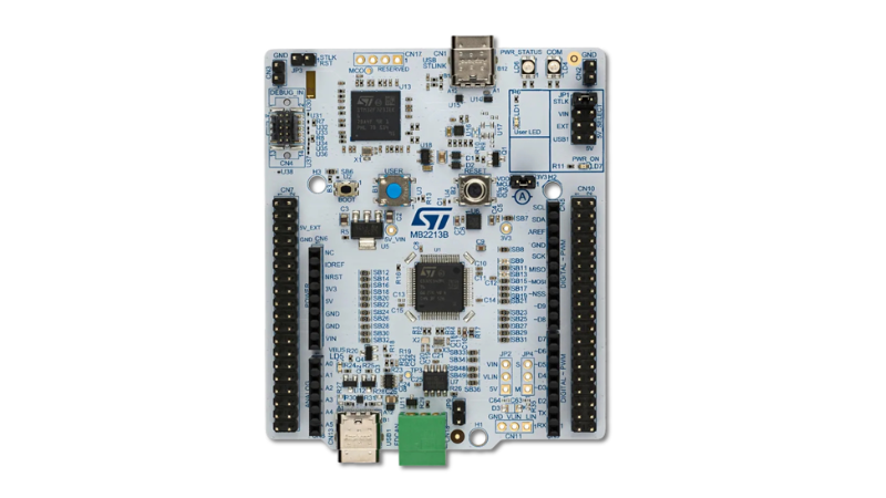

Users can begin prototyping STM32C5 MCUs with ST’s STM32 Nucleo-64 development board
Users can begin prototyping STM32C5 MCUs with ST’s STM32 Nucleo-64 development board. Image used courtesy of STMicroelectronics
