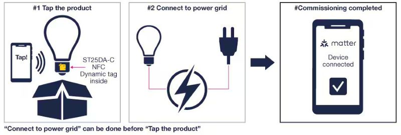

STMicroelectronics has designed its new ST25DA-C chip to serve as an alternative to conventional commissioning methods such as Bluetooth Low Energy, QR codes, or passcodes. A key technical advantage of the ST25DA-C is its ability to perform commissioning operations on devices that are not yet connected to main power. This battery-less connectivity is enabled through energy harvesting: the device draws the electrical current required for operation directly from the radio frequency field generated by the tapping smartphone. This capability significantly improves the installation process for devices like wall switches or light fixtures that lack internal batteries and are often installed before power is available.
The ST25D’s NFC-enabled battery-less connectivity enables unpowered devices to be added to a smart home network
The ST25D’s NFC-enabled battery-less connectivity enables unpowered devices to be added to a smart home network. Image used courtesy of STMicroelectronics

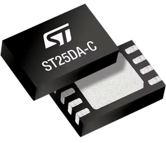

The ST25DA-C is designed for minimal physical footprint in space-constrained IoT applications. It is supplied in a compact 2.00 mm × 3.00 mm ultra-thin DFN8 package. Integration is further simplified by the inclusion of a 78-pF tuning capacitor, allowing designers to utilize highly integrated, smaller antennas.

The device can be powered either by its Vcc pin, with a supply voltage range of 1.62 V to 3.3 V, or contactlessly via the 13.56 MHz carrier. The chip incorporates more than 3 KB of non-volatile memory allocated for Matter certificates, keys, and attributes.
