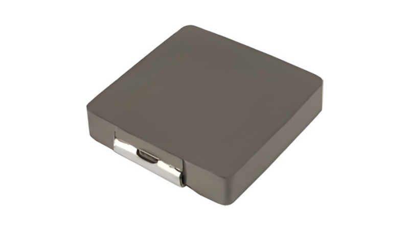

Sumida America has released the 0615CDMCC/DS series, a family of shielded power inductors manufactured using metal compound molding. This manufacturing approach embeds the winding within a solid composite core structure, eliminating the internal air gaps typically found in conventional ferrite-based inductors. The result is improved magnetic flux containment, which translates to higher saturation current ratings and more stable inductance behavior under load.
Sumida’s 0615CDMCC/DS series power inductors feature a metal compound molding construction
Sumida’s 0615CDMCC/DS series power inductors feature a metal compound molding construction. Image used courtesy of Sumida
0615CDMCC/DS Series Power Inductors

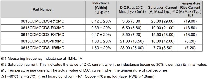

Electrical characteristics of the 0615CDMCC/DS series lineup
Electrical characteristics of the 0615CDMCC/DS series lineup.  Image used courtesy of Sumida
