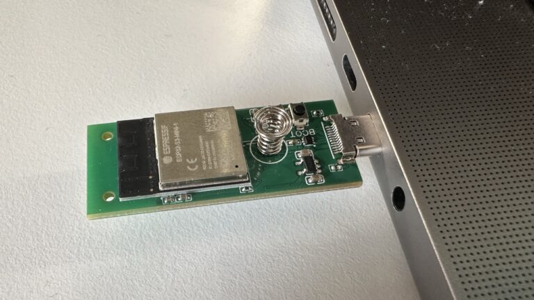

ThingPulse’s ESP32-S3-based Compact Pendrive S3 128MB
ThingPulse has developed a USB-C plug featuring ESP32-S3, flash memory of 128MB, and capacitive touch for commands. This ThingPulse Pendrive S3 can work as a BadUSB device, sending hundreds of keystrokes per second and executing predefined commands through simple scripts.
ThingPulse has developed a USB-C plug featuring ESP32-S3, flash memory of 128MB, and capacitive touch for commands. This ThingPulse Pendrive S3 can work as a BadUSB device, sending hundreds of keystrokes per second and executing predefined commands through simple scripts. The WiFi Duck enhances this capability by providing wireless control over these scripts via a web interface, eliminating the need for physical script transfers or application installations. This device emulates a USB keyboard and connects to a WiFi network, where users can remotely manage and deploy scripts in “real-time”, significantly streamlining the process of executing complex command sequences on target systems.
Meanwhile, the Espressif ESP32-S3-MINI-1 module on the board integrates an Xtensa dual-core 32-bit LX7 microprocessor with support for 2.4GHz Wi-Fi and Bluetooth 5 (low-energy).
ThingPulse Pendrive S3 specifications:
- Wireless module – ESP32-S3-MINI
- CPU – Dual-core Xtensa LX7 @ 240 MHz,
- Memory/Storage – 512 KB SRAM, 8MB on-chip flash,
- Wireless – 2.4GHz Wi-Fi and Bluetooth 5 (LE)
- PCB antenna
- Storage – 128MB flash memory, addressable via SDIO/MMC or SD card interface, in 1-bit or 4-bit mode
- USB – USB-C male connector
- Other specs
- WS2812B addressable RGB LED
- Capacitive touch button (Spring)
- USB drive plastic enclosure
TinyUSB enables the emulation feature of the pendrive module, allowing the device to mimic itself as mice, keyboards, storage, etc. The ThingPulse Pendrive S3 also supports CircuitPython, a subset of Python specifically for microcontrollers.
