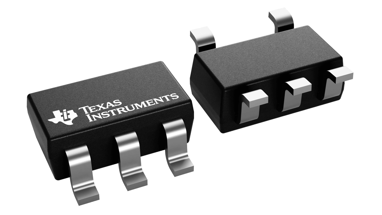

TLV916x RRIO Low-Noise Op Amps
Texas Instruments' 16 V, 11 MHz op amps are ideal for industrial applications offering high performance and flexibility Texas Instruments' TLV916x (TLV9161, TLV9162, and TLV9164) is a family of 16 V, general-purpose op amps that offer exceptional DC precision and AC performance including rail-to-rail input/output (RRIO), low offset, low-offset drift, and low noise. Features including differential and common-mode input voltage ranges to the supply rails, high short-circuit current (±73 mA), and high slew rate (33 V/µs) make these devices flexible, robust, and high-performance op amps for industrial applications.
Analog by mixos
Texas Instruments’ 16 V, 11 MHz op amps are ideal for industrial applications offering high performance and flexibility
Texas Instruments’ TLV916x (TLV9161, TLV9162, and TLV9164) is a family of 16 V, general-purpose op amps that offer exceptional DC precision and AC performance including rail-to-rail input/output (RRIO), low offset, low-offset drift, and low noise. Features including differential and common-mode input voltage ranges to the supply rails, high short-circuit current (±73 mA), and high slew rate (33 V/µs) make these devices flexible, robust, and high-performance op amps for industrial applications.
The TLV916x op amps are available in microsize packages including WSON, as well as standard packages such as SOT-23, SOIC, and TSSOP. The devices offer a temperature range of -40°C to +125°C.
  • Low offset voltage: ±210 µV (typ.)
  • Low offset voltage drift: ±0.25 µV/°C (typ.)
  • Low noise: 6.8 nV/√Hz at 1 kHz, 4.2 nV/√Hz at 10 kHz broadband
  • High common-mode rejection: 110 dB
  • Low bias current: ±10 pA
  • RRIO
  • Supply ranges: ±1.35 V to ±8 V and 2.7 V to 16 V
  • Robust EMIRR performance
  • MUX-friendly/comparator inputs
  • Amp operates with differential inputs up to the supply rails
  • Amp can be used in an open-loop or as a comparator
  • Wide bandwidth: 11 MHz GBW, unity-gain stable
  • High slew rate: 33 V/µs
  • Low quiescent current: 2.4 mA per amp
