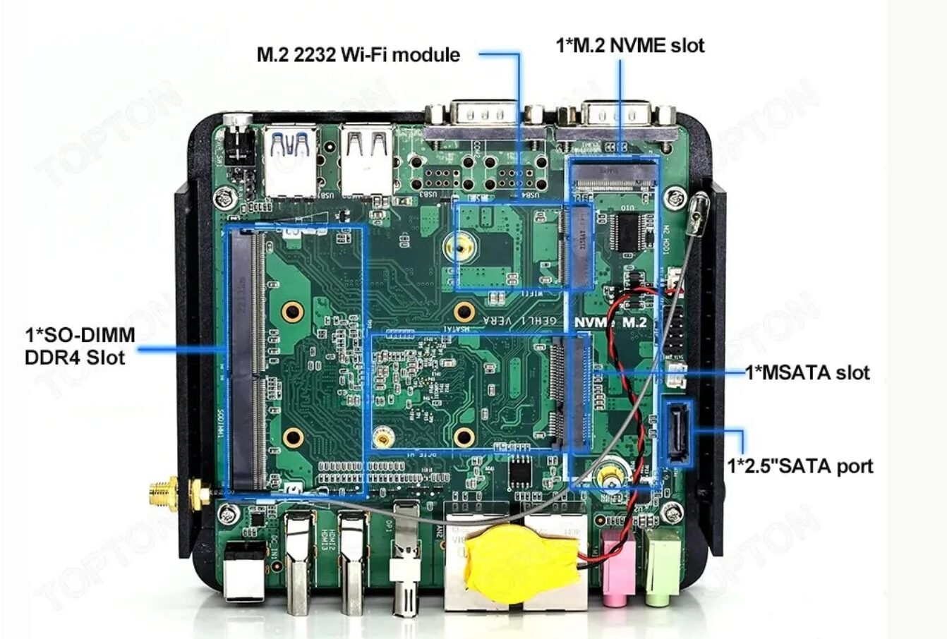

The Topton M4, priced at $106, is notably affordable but the catch is it ships without RAM, storage, or a wireless module. While this might be seen as a drawback, it also offers an opportunity for those who have spare RAM SSDs or USB Wi-Fi dongles lying around. You can add all that in and get yourself a pretty powerful mini PC with a 50% lower price.

  • CPU: Intel N100 Alder Lake-N Quad-Core, Turbo up to 3.4 GHz, 6MB Cache.
  • Graphics: 24EU Intel HD, up to 750 MHz; 6W TDP.
  • RAM: Max 32GB DDR4-3200, SO-DIMM.
  • Storage:
    • 2 2280 (NVMe/SATA III SSD).
    • SATA III (2.5-inch HDD/SSD).

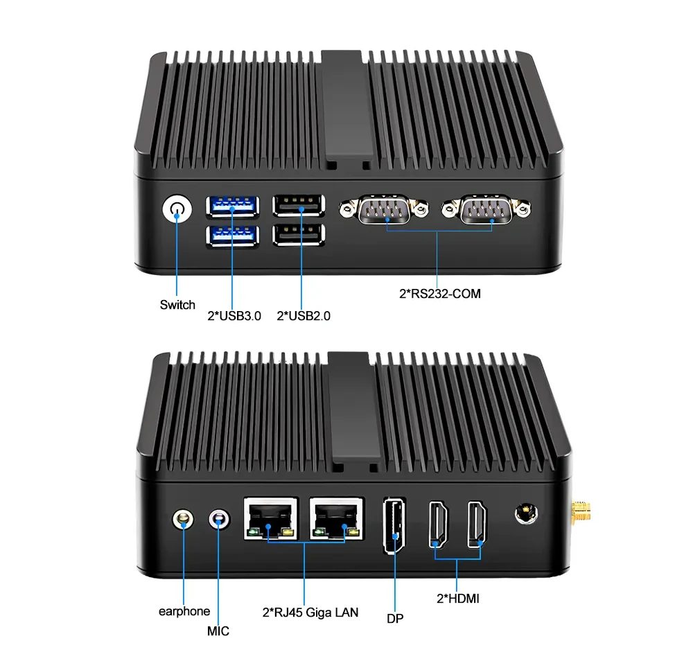

  • Video Outputs:
    • 2x HDMI 2.0 (4Kp60).
    • 1x DisplayPort (4Kp60).
    • Supports triple displays.
  • Audio: 3.5mm headphone and mic jacks; digital via HDMI/DP.
  • Connectivity:
    • Dual Gigabit Ethernet (Realtek).
    • Wi-Fi 5, Bluetooth 4.2 (external antenna).
  • USB: 2 USB 3.0, 2 USB 2.0.
  • Serial: 2 COM ports (DB9).
  • Other Features: Power button, RTC, battery.
  • Power: 12V DC (3A-5A).
  • Size: 135 x 127 x 39 mm.
The mini PC supports Windows 11, OPNsense, Ubuntu, and more. While similar N100 processor computers support up to 16GB RAM, the M4 offers a 32GB/1TB option, though its compatibility is unconfirmed. The TopTon M4 includes a power adapter, cord, SATA cable, and two antennas. Pre-installed Windows 11 is provided in models with RAM, storage, and Wi-Fi. Unlike others in its price range, it features customizable RAM, storage, and wireless options.
