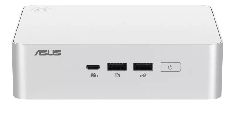

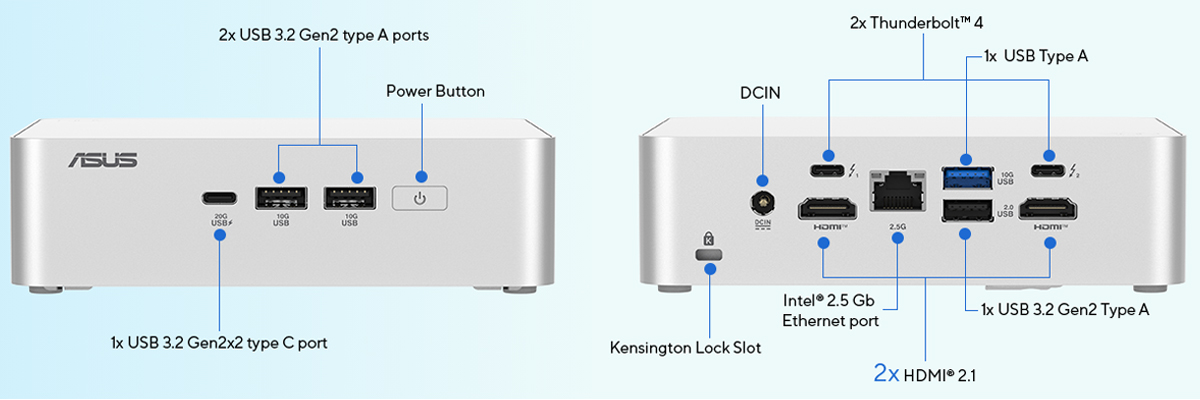

The NUC 15 Pro+ supports up to 96GB of DDR5-6400 RAM across two SO-DIMM slots and features dual M.2 PCIe Gen4x4 NVMe SSD slots, accommodating storage capacities from 128GB to 2 TB. For connectivity, the mini PC includes Intel Wi-Fi 7 and Bluetooth 5.4, along with multiple high-speed ports. The front I/O panel features one USB 3.2 Gen2x2 Type-C and two USB 3.2 Gen2 Type-A ports, while the rear panel includes one USB 3.2 Gen2 Type-A, one USB 2.0 Type-A, an RJ45 LAN port, and a DC-in connector.

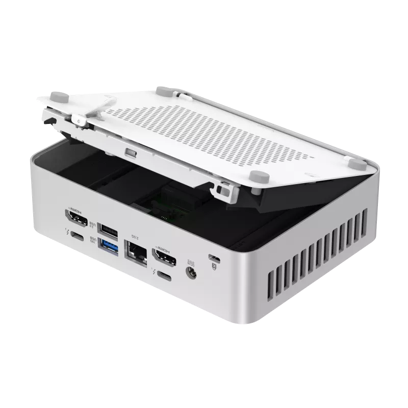

The compact 0.7L chassis is designed for tool-free upgrades, making it easy to expand memory and storage. The NUC 15 Pro+ supports up to four 4K displays via HDMI 2.1 and Thunderbolt 4 ports (supporting DisplayPort 2.1 and USB4) for an immersive visual experience. With its powerful AI capabilities, high-speed connectivity, and versatile display options, the Asus NUC 15 Pro+ is an excellent choice for professional computing, AI-driven tasks, and business applications.

    • Front: 1x USB 3.2 Gen2x2 Type-C, 2x USB 3.2 Gen2 Type-A
    • Rear: 1x USB 3.2 Gen2 Type-A, 1x USB 2.0 Type-A
  • Expansion:
    • 2x Thunderbolt 4 (supports DP 2.1, USB4)
    • 1x Kensington Lock slot
