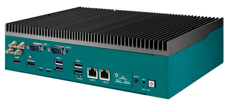

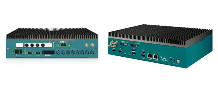

Vecow EAC-5000 is also characterized by various wireless connectivity options such as WiFi, 5G, 4G LTE, 6x antennas, support for up to 8x GMLS2 cameras, 1x PCIe x8 slot, 2 GbE LAN, 5x USB, 2x SIM card sockets, 1x software ignition control, a wide range input DC of 9V to 50V, and temperature range of -20 to 70°C. It can be wall mounted with a mounting bracket, and the company offers an optional DIN Rail mount too.

  • 2x M.2 Key M 2280 socket
  • MicroSD card socket
  • 1x 64GB eMMC 5.1
  • 1x Digital Display interface up to 8K60
  • 8x Fakra-Z connectors for GMSL2 automotive cameras
  • 2x GbE ports
  • 2x SIM card socket
  • Optional WiFi, 5G, 4G LTE connectivity through M.2 sockets
  • 6x antennas for WiFi, 5G, 4G LTE, UMTS, GPRS
  • 1x USB 3.1 Gen 2
  • 4x USB 3.1
  • 2x COM RS-232/422/485
  • 2x isolated CAN BUS
  • 1x PCIe Gen4 x8 slot
  • 1x M.2 Key B socket
  • 1x M.2 Key E socket
  • 8x DI, 8x DO
  • 1x Micro USB console debug port
  • 1x Micro USB OS flash port
  • Power and Rest Buttons
  • 2x User-programmable LEDs
  • 16-mode Software Ignition control
  • 3-pin Remote Switch terminal block
  • Remote power on/off and remote reset control
  • Power Input: DC 9V to 50V via 3-pin terminal block
