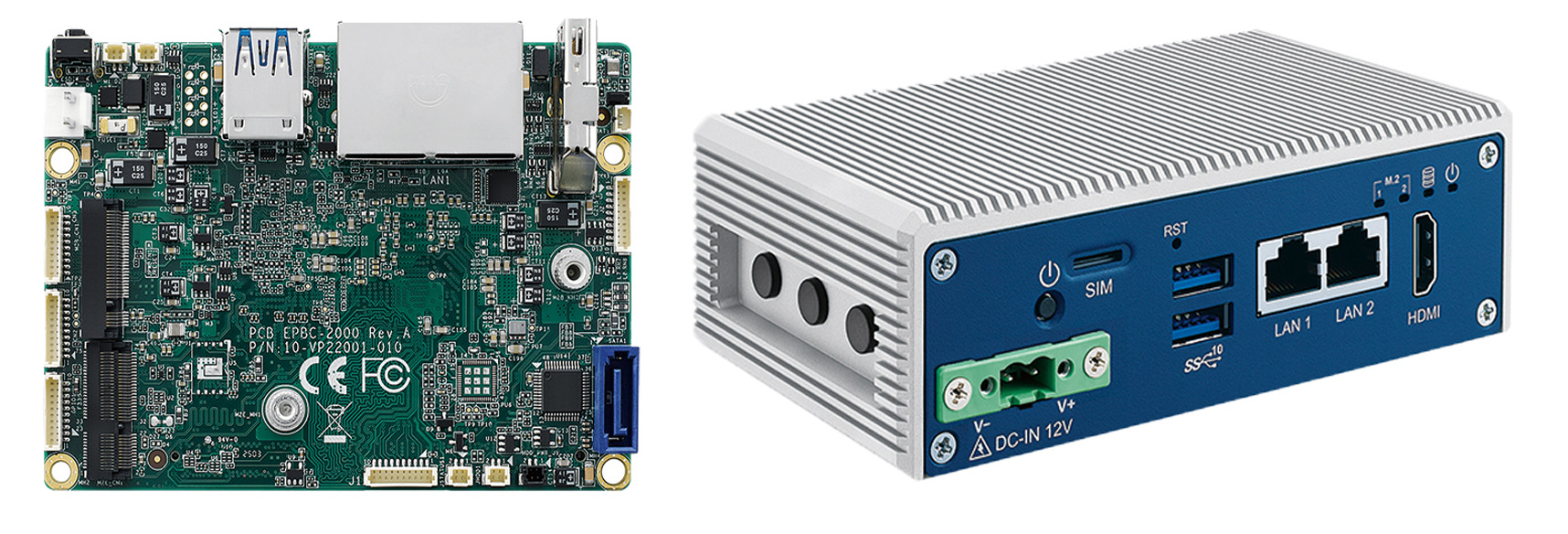

Vecow PBC-2000 Industrial Embedded System uses EPBC-2000 2.5-inch Pico-ITX SBC as Its core
The Vecow PBC-2000 is a fanless industrial embedded system built around the EPBC-2000 Pico-ITX SBC with an Intel Atom x7211RE dual-core Amston Lake processor and integrated Intel UHD graphics. It operates in extreme temperatures from -40°C to 70°C and supports up to 16GB DDR5 ECC memory.
The system offers dual 2.5GbE Ethernet ports, multiple serial and USB interfaces, SATA III storage, and M.2 slots for storage and wireless modules including WiFi, Bluetooth, and 4G/5G with an external SIM slot. Other features include hardware monitoring with auto-throttling, a watchdog timer, Wake-on-LAN, and PXE boot. The industrial embedded system comes with various mounting options, including wall and DIN rail, which make it suitable for control systems, autonomous mobile robots, smart factories, IoT hubs, and more.
Vecow PBC-2000 and EPBC-2000 specifications:
  • Processor: Intel Atom x7211RE dual-core Amston Lake SoC, 2.0 GHz base, up to 3.4 GHz boost, 6 MB cache, 16EU Intel UHD Graphics, 9W TDP
  • Memory: Supports up to 16GB DDR5 4800MHz ECC via 1x SO-DIMM slot
  • Storage:
    • 1x M.2 Key-B 2280 slot (PCIe x2 / USB 2.0)
    • 1x SATA III port (6 Gbps) with internal power connector
  • Networking:
    • 2x 2.5GbE Ethernet ports (Realtek RTL8125BI-CG)
    • Optional M.2 slot for WiFi and Bluetooth modules
    • Optional M.2 slot + external SIM card slot for 4G/5G cellular connectivity
  • Video Output: 1x HDMI 2.1, up to 4096×2304 @ 60Hz
  • Audio: Internal line-in and mic headers (on SBC only)
  • USB Ports:
    • 2x USB 3.2 Gen 2 Type-A
    • 10-pin USB 2.0 header (on SBC only)
  • Serial Interfaces:

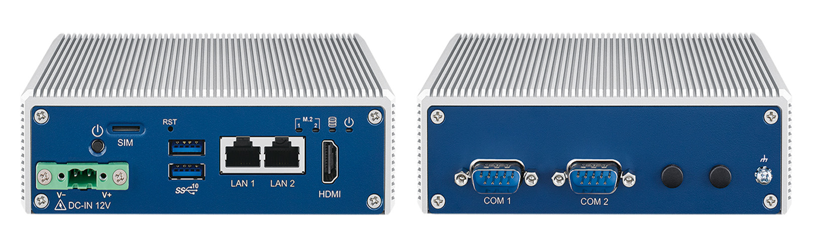

    • 2x RS-232/422/485 DB-9 ports (on embedded PC) or header on SBC
  • Expansion:
    • M.2 Key-B slot (2280/3042/3052, PCIe x2 / USB3 / USB2)
    • M.2 Key-E slot (2230, PCIe x1 / USB2)
    • 10-pin GPIO header (on SBC only)
  • Power: 12V DC input via 2-pin terminal block
  • Special Features:
    • Fanless design with hardware monitoring and auto-throttling
    • Watchdog timer for system reliability
    • Support for Wake-on-LAN and PXE boot
    • Wall mount standard, optional DIN rail mounting
    • Compatible with Windows 10/11 and Linux
    • Supports the Vecow VHub AIoT software suite (AI acceleration, AMR development, EtherCAT I/O)
  • Dimensions:
    • Embedded system: 136 × 44.5 × 78.5 mm
    • Pico-ITX SBC: 100 × 72 mm
  • Operating Temperature: -40°C to 70°C (with airflow)
  • Storage Temperature: -40°C to 85°C
  • Humidity: 5% to 95% non-condensing
  • Weight: Approx. 0.6 kg
  • Certifications: CE, FCC, ICES, EN50155, EN50121-3-2
The PBC-2000 Industrial Embedded System is compatible with Vecow’s VHub AIoT Software Suite, which includes tools like the VHub AI Developer Kit for OpenVINO-based AI acceleration, VHub ROS for autonomous mobile robot development, and the VHub EtherCAT platform for industrial I/O control, enabling advanced functionality for edge AI and automation tasks. The system runs Windows 10, Windows 11, and Linux operating systems.
