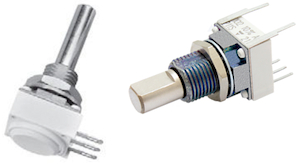

Vishay / Sfernice P11H Modular High Torque Panel Potentiometers
Vishay / Sfernice P11H Modular High Torque Panel Potentiometers are designed to keep the setting under high mechanical constraints from vibration, shock, and other factors. Vishay / Sfernice P11H Potentiometers provide high torque (8Ncm) with a smooth feeling during the potentiometer's entire life.
Vishay / Sfernice P11H Modular High Torque Panel Potentiometers are designed to keep the setting under high mechanical constraints from vibration, shock, and other factors. Vishay / Sfernice P11H Potentiometers provide high torque (8Ncm) with a smooth feeling during the potentiometer’s entire life. The series offers 12.5mm2 single turn panel control with 6.35mm shaft diameters and operates over a lifespan of 50,000 cycles.
  • Keep the setting under high mechanical constraints (vibration and shock)
  • High torque (8Ncm) with smooth feeling during all potentiometer life
  • Torque stability under high environmental constraints
  • 12.5mm2 single turn panel control with 6.35mm shaft diameters
  • Compact, versatile, modular, and robust
  • Tests according to CECC 41000 or IEC 60393-1
Specifications
  • IP64 sealing level
  • 50,000 cycles lifespan
  • Up to 7 modules
