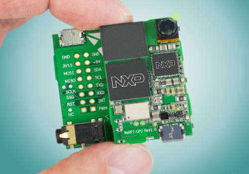

“WaRP7” is a new platform which increases developer’s opportunity to innovate and bring new products to the market by smoothing and speed up the development process of IoT applications and wearable technologies. WaRP7 is a $85 platform designed by “Farnell element14”.
warp_7platform

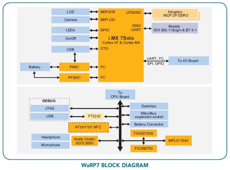

WaRP7 is a $85 platform designed by “Farnell element14”. It consists of a main board and a daughter card. The main board comes with a i.MX 7Solo applications processor from NXP and 8GB storage memory. WaRP7 supports WiFi, Bluetooth, USB-OTG, BLE, and NFC connections.
The processor is a member of i.MX 7Solo processors family and it is designed for devices that require high-performance processing with low-power requirements and a high degree of functional integration. It features an advanced implementation of the ARM® Cortex®-A7 core, as well as the ARM® Cortex®-M4 core.

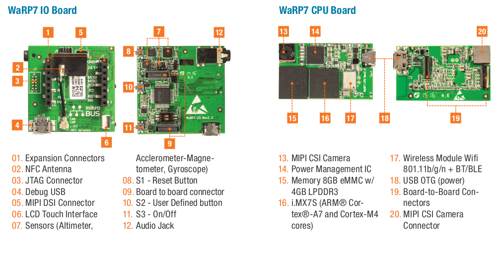

Using the daughter card ‘WaRP7 IO Board’, prototyping will be fast thanks to the ability of using various expansion modules. It has a flexible design connected with various sensors to collect data, and a MikroBus™ expansion socket which opens users to over 200 Click Boards™ from MikroElektronika.
WaRP7 features the following sensors, located in the daughter card :
  • A high-precision barometer.
  • A six-axis sensor combining an industry-leading accelerometer and magnetometer.
  • A three- axis gyroscope.
Another key element provided in the WaRP7 platform is a MIPI CSI Camera.

WaRP7 Architecture
WaRP7 Architecture

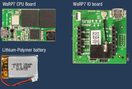

warp7_kit
WaRP7 development kit is available for about 85$ and contains WaRP7 CPU board ƒ, WaRP7 IO board and Lithium-Polymer battery.
