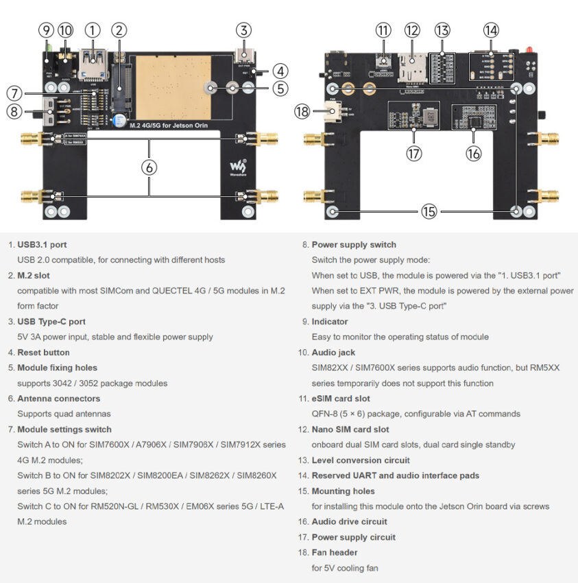

  • USB:
    •  1x USB USB3.1 port (USB 2.0 compatible, for connecting with different hosts)
    • 1x USB Type-C port for power(5V,3A)
  • Expansion:
    • Standard M.2 B-Key slot (supports SIM8260X-M2 / SIM8262X-M2 / RM5XX / SIM7600), Nano SIM slot, eSIM (QFN-8)
    • Reserved UART and audio interface pads
  • Misc:
    • Module settings switch
      • Switch A to ON for SIM7600X / A7906X / SIM7906X / SIM7912X series 4G M.2 modules
      • Switch B to ON for SIM8202X / SIM8200EA / SIM8262X / SIM8260X series 5G M.2 modules
      • Switch C to ON for RM520N-GL / RM530X / EM06X series 5G / LTE-A M.2 modules
    • 4 × SMA antennas, IPEX adapter connectors (quad-antenna support).
    • Power/reset buttons
    • Status LED Indicator
    • Fan header
    • Screw holes for attachment to Jetson/host board.
    • Onboard level shifters for peripheral compatibility
  • Power:
    • Switchable power supply
      • When set to USB, the module is powered via the USB3.1 port
      • When set to EXT PWR, the module is powered by the USB Type-C port

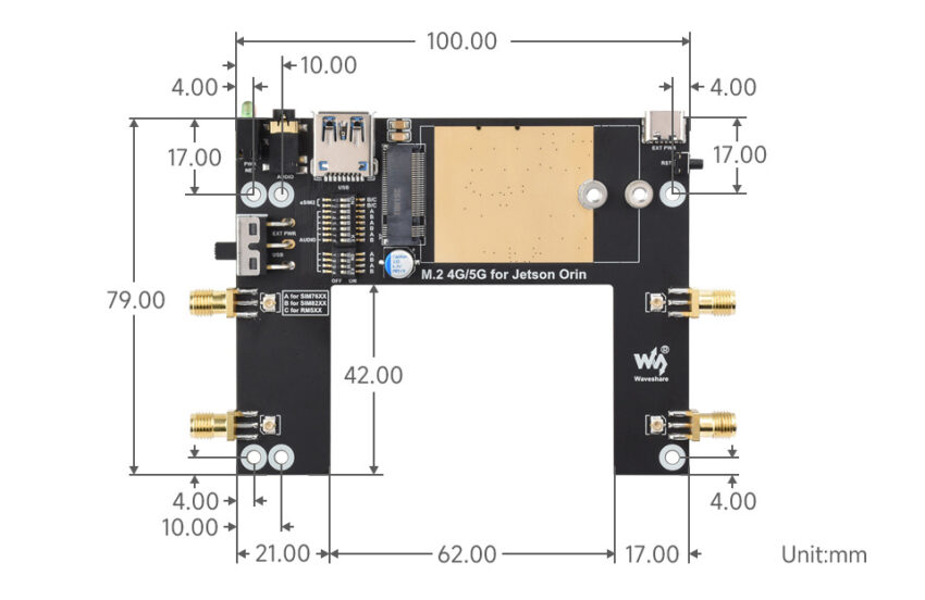

  • Dimensions: 100 mm x 79 mm
