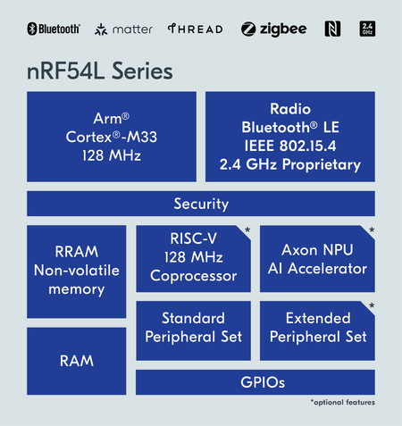

 nRF54LM20B ultra-low power wireless SoC features an integrated Axon NPU, 2 MB non-volatile memory, and 512 KB RAM
The nRF54LM20B features a multicore architecture (Arm Cortex-M33 and RISC-V) with an integrated Axon NPU, 2MB NVM, and a 2.4 GHz radio, designed for advanced Edge AI and IoT applications. Image used courtesy of Nordic Semiconductor
The SoC also uses a dual-core design, combining an Arm Cortex-M33 application processor with a RISC-V coprocessor. This setup allows tasks to be split efficiently, with the main core running application logic while the coprocessor and NPU take care of real-time data processing and AI inference.

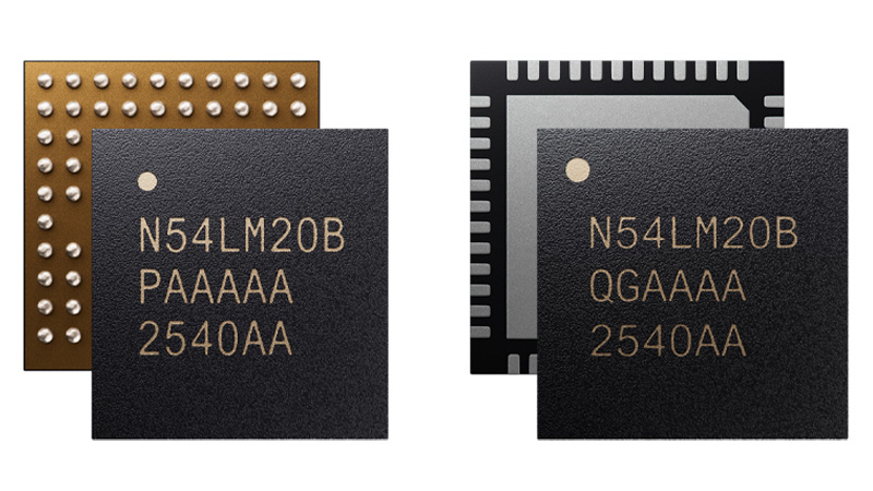

Nordic Semiconductor’s nRF54LM20B is available in a CSP package (left) and QFN package (right). Images used courtesy of Nordic Semiconductor
