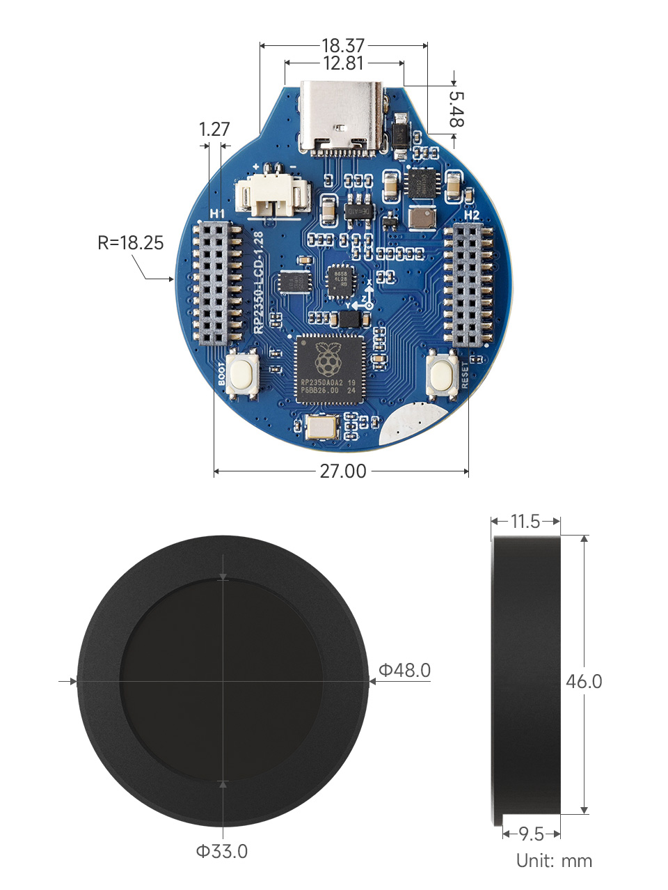

Waveshare has recently launched RP2350-LCD-1.28, an RP2350 rounded LCD development board with a 240×240 pixel resolution and a 65K-color IPS panel. Built around the Raspberry Pi RP2350 chip, this development board features 520KB of SRAM, 4MB of flash memory, and a Type-C connector for easy programming and power.
RP2350 rounded LCD
Other features include a rechargeable Lithium battery manager, 6-axis IMU with a 3-axis gyroscope and accelerometer, multiple GPIO pins (30 in total), USB 1.1 host/device support, temperature sensor, and 24 PWM channels, all configured for flexible I/O options. These features make this device suitable for IoT devices, wearable tech, and embedded applications requiring a compact, energy-efficient microcontroller with display capabilities.

RP2350 rounded LCD(RP2350-LCD-1.28) Specifications
  • Microcontroller: Raspberry Pi RP2350A MCU
    • Dual-core Arm Cortex-M33 processor @ 150 MHz
    • 520 KB internal RAM
    • 8 KB OTP memory
    • QFN-60 package (7×7 mm)
  • Storage:
    • 4 MB NOR flash memory for code and data
  • Display:
    • 1.28-inch 240×240 pixels 65K-color IPS round LCD
  • Sensors:
    • QMI8658 6-axis IMU (3-axis gyroscope + 3-axis accelerometer)
  • USB:
    • USB Type-C port for power and drag-and-drop programming (USB 1.1 host/device)
  • Expansion:
    • 30 multi-function GPIO pins (1.27 mm pitch female headers)
    • 2x SPI, 2x I2C, 2x UART
    • 4x 12-bit ADC channels
    • 24x PWM channels
  • Power:
    • 5V power input via USB-C
    • VSYS and GND pins for external power
    • MX1.25 header for 3.7V Lithium battery (ETA6096 charge manager chip)
    • Low-power sleep and dormant modes
  • Dimensions:
    • Outer diameter: 48.0 mm
    • LCD diameter: 33.0 mm
    • Overall thickness: 11.5 mm
    • Recessed depth: 9.5 mm
    • Total height: 46.0 mm
Since the display is built around the RP2350 MCU it can be programmed with the official Pico C/C++ and Micro Python SDK, and Arduino IDE. Waveshare also provides SDK, dev resources, tutorials, 3D files, and much more on its wiki page.
