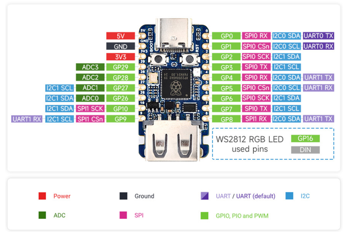

It includes 520KB SRAM, 2MB onboard Flash, a USB Type-C connector for programming, and a USB Type-A port for host or device support via PIO. With 15 multi-function GPIO pins, it supports 2x SPI, 2x I2C, 2x UART, 4x 12-bit ADC, 14x PWM channels, and 12 programmable I/O (PIO) state machines, enabling flexible peripheral interfacing.

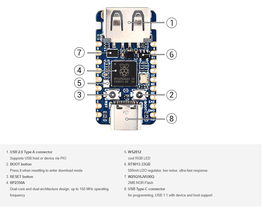

Waveshare RP2350A USB Mini Development Board Specifications:
  • MCU: Raspberry Pi RP2350A
    • Dual-core Arm Cortex-M33 processor, up to 150 MHz
    • Dual-core Hazard3 RISC-V processor, up to 150 MHz
  • Memory: 520KB SRAM
  • Storage: 2MB NOR Flash (W25Q16JVUXIQ)
  • USB:
    • USB Type-C for programming and power (USB 1.1 with host/device support)
    • USB Type-A expansion port via PIO (compatible with USB 2.0/1.1)
  • I/O:
    • 12x Programmable I/O (PIO) state machines
    • 2x 9-pin 2.54mm pitch headers
  • Expansion:
    • 15x Multi-function GPIO pins
    • 2x SPI, 2x I2C, 2x UART
    • 4x 12-bit ADC channels
    • 14x PWM channels
  • Misc:
    • WS2812 RGB LED
    • RT9013-33GB 500mA LDO regulator
    • Temperature sensor
    • Accurate clock and timer on-chip
    • Low-power sleep and dormant modes
    • Drag-and-drop programming via USB mass storage
  • Power: 5V DC via USB-C port
  • Form Factor: 33 x 17.5 mm
