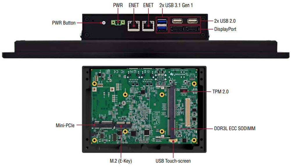

Its low-profile (35mm) yet robust design includes dual gigabit Ethernet controllers, two USB 3.0 channels, two USB 2.0 ports, and offers a wide voltage range for input power – from +10 to 50 volts DC. The U.S.-made panel PC also contains a soldered-down TPM 2.0 module for authenticating root of trust and security.
“With the power for Windows 10 IoT and Linux operating systems, our new PPC12-427 embedded system enables the 15-year product life cycles required for digital signage, Industrial IoT, food processing, energy management, and transportation solutions,” said WINSYSTEMS’ Technical Sales Director George T. Hilliard. “It can also drive two additional displays through its dual DisplayPort and support Human Machine Interface within difficult environments – even in outside temperature extremes where other panel PCs can’t operate.”
This extension of WINSYSTEMS’ SYS-427 packaging gives designers the uninhibited performance and reliability they need without sacrificing flexibility. Unlike other systems that require attachment to an external heatsink or fan, the PPC12-427 was specifically built to operate fanlessly for temperatures ranging from -30 to +85C when equipped with automotive DRAM. It also features an industrial temperature LCD touchscreen and expansion through Mini-Card connectors. And, with its sealed front bezel fully protecting against ingress of dust and moisture, this complete touch panel PC stands up to wash-down environments such as those in food processing.

  • 12-in. Panel PC with Projected Capacitive Multi-touch Screen
  • Supports up to two additional Displays
  • 2x DisplayPort with 4K Resolution
Performance for Industrial IoT Edge Computing
  • Intel Apollo Lake-I E3900 Processor (Dual or Quad-core)
  • Up to 8GB DDR3L ECC System Memory
  • Up to 2.0GHZ CPU Clock Rate
  • Time-Coordinated Computing
  • Soldered down TPM 2.0 Hardware Security Enabled
  • 10+ Year Availability
Rugged Design for Demanding Environments
  • -30°C to +85°C Operating Temperature Range
  • Wide Range Power Input (10 – 50 V DC)
Connectivity and I/O for Embedded Data Acquisition
  • 2x Gigabit Ethernet
  • 2x USB 3.1 Gen 1 and 4x USB 2.0
  • 8x General Purpose Input/Output (GPIO)
  • 2x channel Analog-to-Digital (ADC)
  • 3x Serial Ports
  • HD Audio
Storage
  • eMMC
  • SATA with SATA Power
  • mSATA
Expansion and Configuration Options for Semi-Custom Solutions
  • Mini-PCI Express
  • M.2 E-Key 2230 Form Factor
  • WINSYSTEMS’ Modular IO80 Expansion
