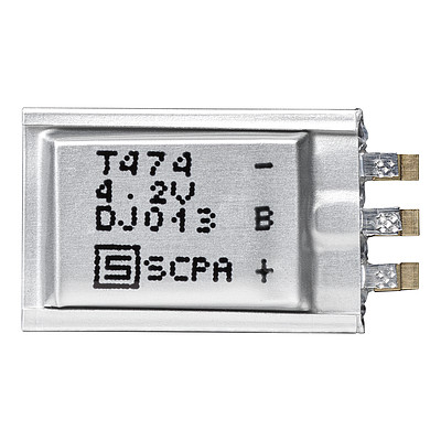

Schurter’s SCPA prismatic ultra-thin supercapacitor
Schurter’s SCPA prismatic ultra-thin supercapacitor. Image used courtesy of Schurter
