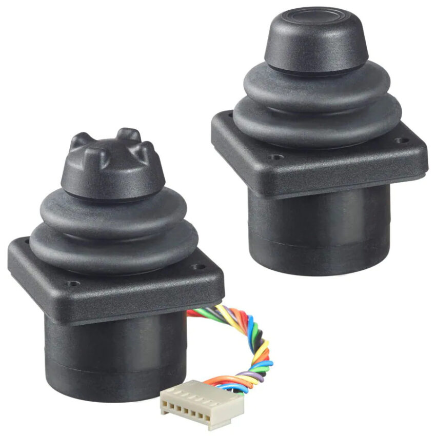

APEMs’ XS series is a two-axis Hall effect joystick featuring a reduced panel height to provide precise fingertip control. Measuring less than 45 mm, the XS allows for unimpeded access to other devices located on the control panel. This compact, low-profile design reduces the risk of inadvertent operation and damage when mounted in handheld mobile devices that are prone to accidental drops. The XS series includes redundant Hall effect sensors for more than 10 million operations. It is IP66 above panel sealed and considered Sil2 compatible, making it the ideal solution for outdoor applications where safety is critical.
  • One or two axis
  • Metal mechanism
  • IP66 front panel sealed
  • Analog or PWM outputs
  • Low profile, less than 45 mm above panel
Specifications
  • 3.3V or 5V operating voltages
  • ±10% x V to ±50% x V output voltage range
  • 10Ω output impedance
  • +20V maximum overvoltage
  • 10 million lifecycles
  • <45mm profile above panel
  • Stainless steel shaft
  • Neoprene boot
  • Nylon handles
  • -30°C to +85°C operating temperature range
