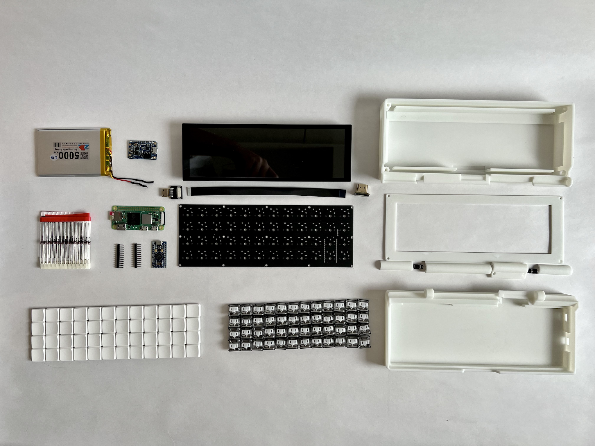

The enclosure for the Penkesu computer is built around the monitor and keyboard, thereby resulting in relatively smaller physical dimensions. Like most portable computers, Penkesu is designed to fold in half when not in use, safeguarding the ultra-wide display. Furthermore, with the intent to keep the hinge design minimal, the repurposed Gameboy Advance SP hinges and HDMI ribbon cable are utilized, they efficiently bear the weight of the display so it doesn’t tip over.
Parts used
Specifications of the Penkesu Portable Computer:
  • CPU: Raspberry Pi Zero 2 W
  • Display: Waveshare 7.9-inch capacitive touch screen
  • HDMI cables: Adafruit DIY HDMI cable parts – right angle adapter, mini HDMI adapter, and 20 cm ribbon cable
  • Power supply: 3.7V 606090 Li-Po battery
  • Keyboard: 48x Kailh Low Profile Choc V1 Switches, 48x MBK Choc Low Profile Keycaps, 48x 1N4148 Diode, 1x Arduino Pro Micro
Penkesu Portable PC
The Arduino Pro Micro powers the board, which enables it to run the QMK open-source keyboard firmware. The compact design of the keyboard was originally developed by the [larrbo] that had been open-sourced– later tweaked the layout so it fits the requirements of Penkesu.
