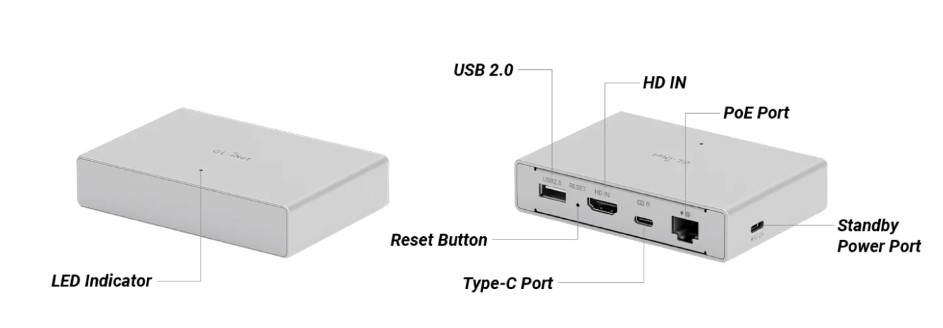

GL.iNet-Comet PoE (GL-RM1PE) Ports

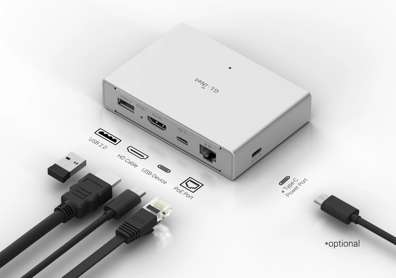

GL.iNet-Comet PoE (GL-RM1PE) Peripherals
A USB 2.0 Type-A to Type-C cable, a USB 2.0 Type-C to Type-C cable, an Ethernet cable, an HDMI cable, and a user manual come packaged with the Comet PoE (GL-RM1PE) remote KVM over PoE solution. The device can be purchased at $109.99 on GL.iNet’s online store, with discounts available for purchases of multiple units, and $91.96 on AliExpress. The Amazon online store offers it as well. A few more technical details and instructions to get started on the documentation website alongside the product page.
