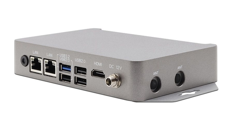

BOXER-6407-TWL chassis showing front I/O, antenna openings, and compact fanless design.

The BOXER-6407-TWL has a slim 30mm chassis with a fanless design for passive cooling. AAEON mentions that it is about 35% thinner than its previous ultra-slim Min PCs, making it suitable for installations with limited space.
The system is powered by either the Intel Processor N150 (up to 3.6 GHz) or the Intel Processor N250 (up to 3.8 GHz), both with a 6W TDP. It supports up to 32GB DDR5-4800 SO-DIMM memory and provides NVMe storage through an M.2 2280 M-Key slot.

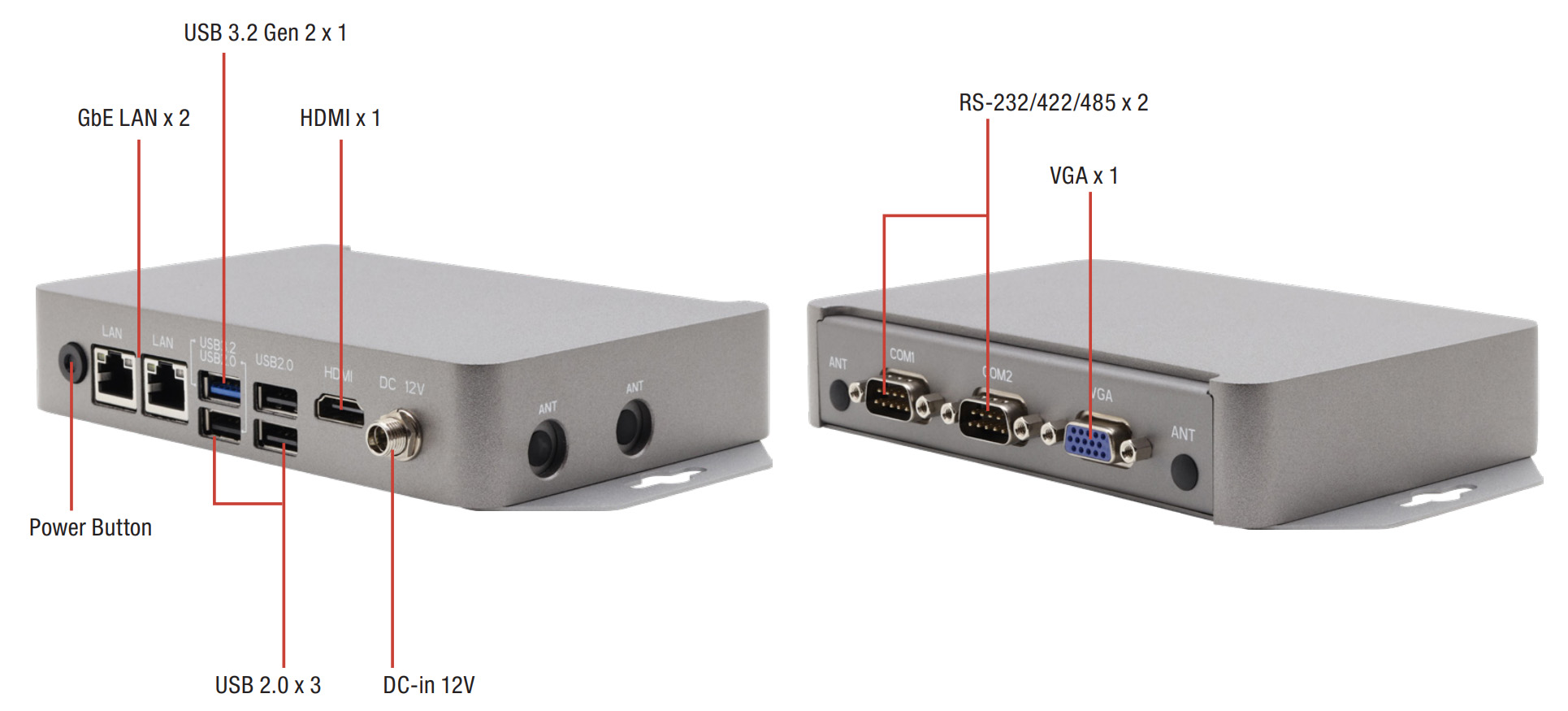

Upgrading older machinery with a newer system can disrupt existing workflows, so AAEON has included both legacy and modern I/O, and now it feates a HDMI (up to 4K @ 60Hz) and VGA for display output, along with dual Gigabit Ethernet ports based on Intel I210-AT controllers.
Front and rear I/O overview of the BOXER-6407-TWL fanless mini PC, highlighting Modern and Legacy I/O
The system also includes one USB 3.2 Gen 2 Type-A port, three USB 2.0 ports, and two DB-9 ports supporting RS-232/422/485. For expansion, it features an M.2 2230 E-Key slot for Wi-Fi/Bluetooth and an M.2 3052 B-Key slot with SIM support for 4G LTE or 5G connectivity.

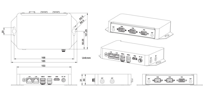

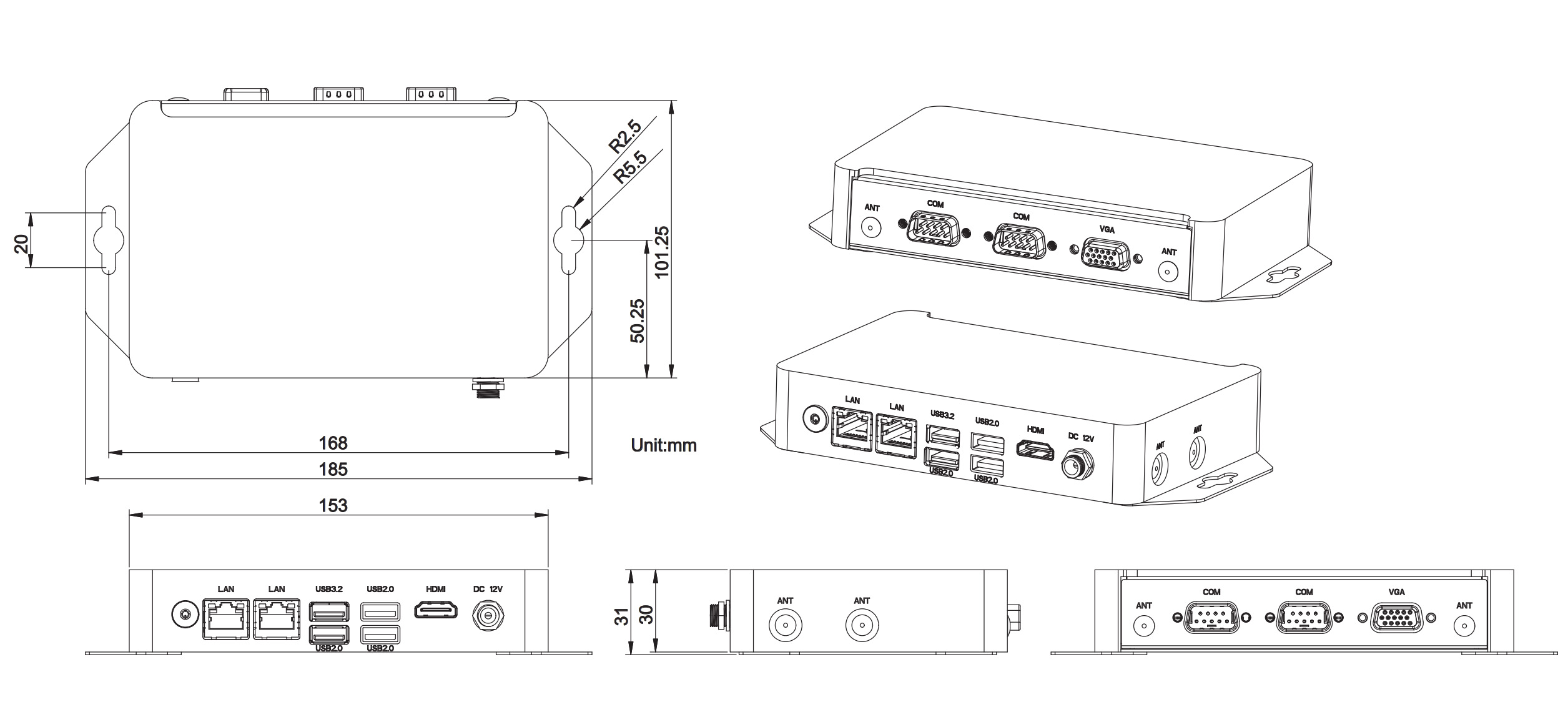

Mechanical drawings of the BOXER-6407-TWL showing dimensions, mounting layout, and port placement.
