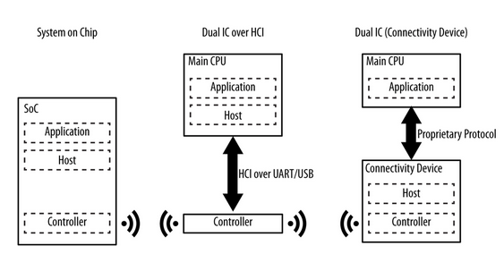

BLE, unlike classic Bluetooth, it’s not designed for big data transmission or streaming audio or video. BLE comes in SoC (System on Chip) ICs which combine a RF transceiver and a microcontroller running the Bluetooth stack (firmware) all in a single chip but you can still have the transceiver alone and run the software stack firmware on your processor.
Possible Hardware Configuration in BLE Solutions - Getting Started with Bluetooth Low Energy by Kevin Townsend, Carles Cufí, Akiba, and Robert Davidson (O’Reilly)
Possible Hardware Configuration in BLE Solutions – Getting Started with Bluetooth Low Energy by Kevin Townsend, Carles Cufí, Akiba, and Robert Davidson (O’Reilly)

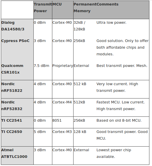

According to Jone, the software stack of Bluetooth Classic must be purchased separately and costs at least $10,000 USD plus a per unit licensing fee for every unit sold. Now, BLE SoC makers provide the software stack free in most cases. For example, Nordic Semiconductors provides the software stack S110, S120 and S130 SoftDevice for free.
most popular BLE chip solutions - Makezine
most popular BLE chip solutions – Makezine
