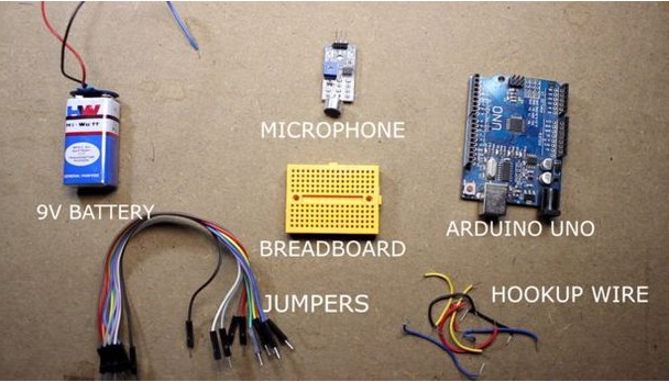

Components required for both versions are:
  • Breadboard
  • Microphone module
  • Arduino Uno
  • 3mm LEDs
  • 100ohm Resistor
  • Battery – 9V
  • Hookup wires and jumpers
  • RCA cable
  • Veroboard and soldering equipment are required if you want to make your own LED design.
