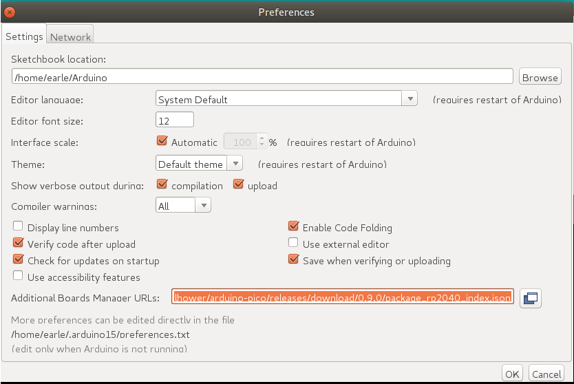

Earle also provides instructions on how to install it with Arduino IDE, by following the instructions below:
- Step 1: Open up the Arduino IDE and go to File->Preferences.
- Step 2: In the dialog that pops up, enter the following URL in the “Additional Boards Manager URLs” field:
- https://github.com/earlephilhower/arduino-pico/releases/download/global/package_rp2040_index.json

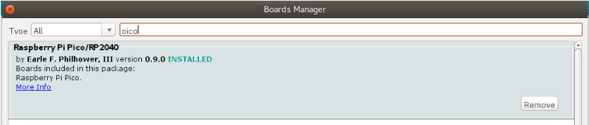

- Step 3: Click OK to close the dialog, then go to Tools > Boards > Board Manager in the IDE.
- Step 4: Type “pico” in the search box and select “Add”.
