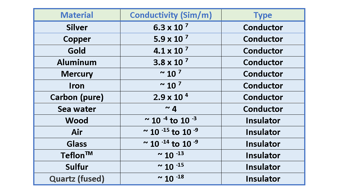

The conductivity values of some common materials for the temperature of 20 ֯C are listed in Table 1.
Table 1: Conductivities of different materials in units of Siemens per meter

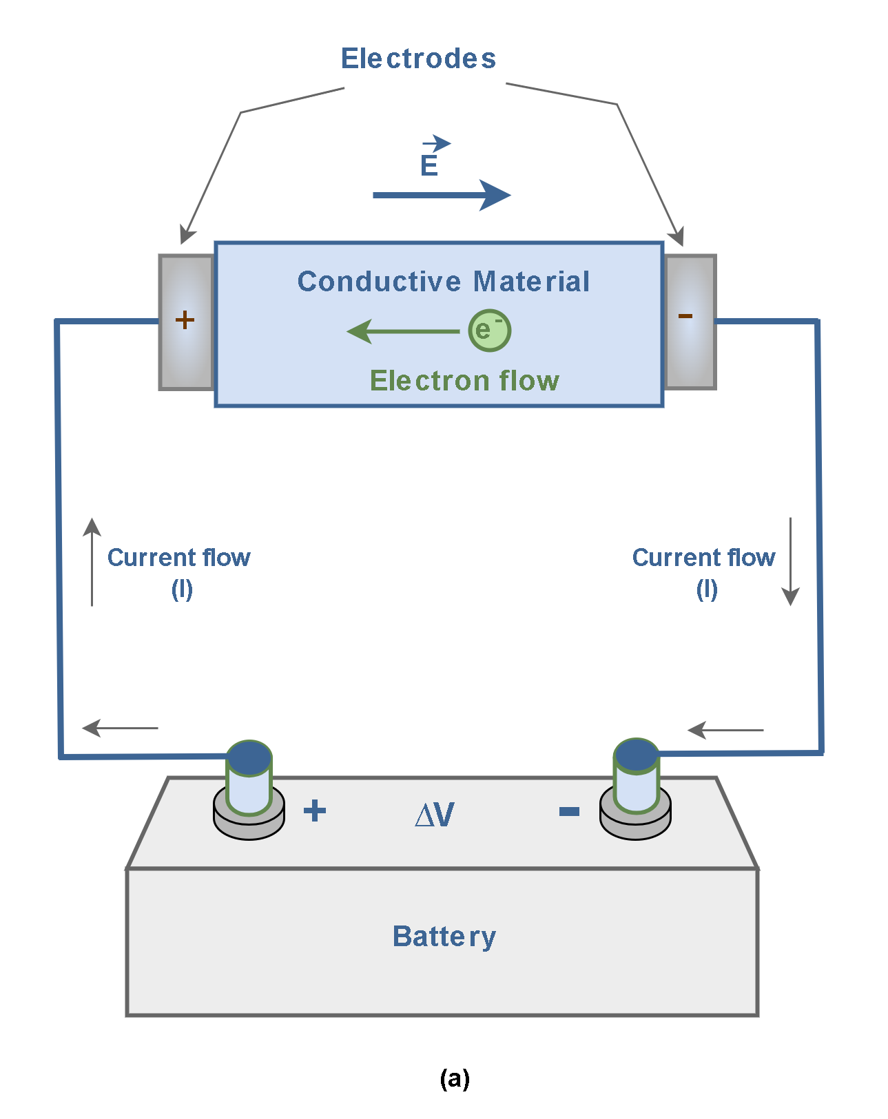

Figure 2(a) shows a test structure based on a simple circuit containing a battery, some wires, and two electrodes. If we put a piece of a conductive material (like a metal bar) between the 2 positive and negative electrodes, because of the potential difference and electrons’ movement, an electric current ‘I’ will be flowing in all the circuits. The amount of the current depends on the voltage ∆V and conductivity of the material under test.
Figure 2 (a): A conductive material between two opposite-polarity electrodes

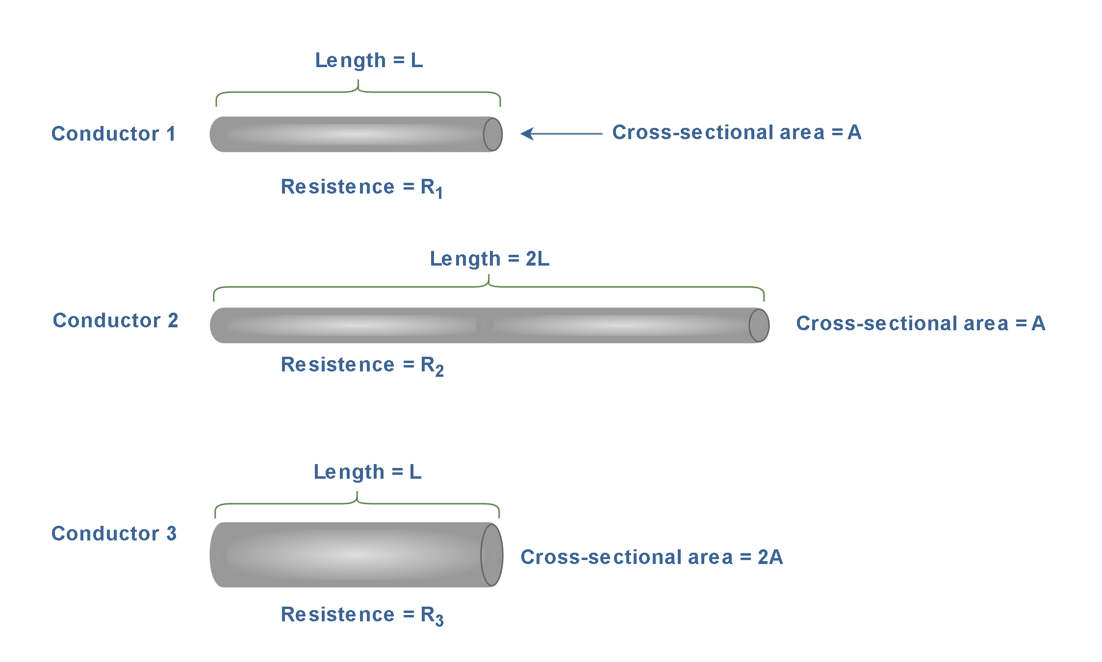

Figure 3 shows three conductor rods of the same materials (the same resistivity ρ), but with different dimensions.
Figure 3: Comparing the resistance between 3 conductors of similar materials but different dimensions
By using Equation 4, we can calculate and compare their resistances R1, R2, and R3. Conductor 2 has the same cross-sectional area as conductor 1 (= A), but with doubled length (= 2L). Therefore, its resistance (R2) is 2 times the resistance of conductor 1, i.e., R2 = 2 ρl/A = 2R1. Conductor 3 has the same length as conductor 1 (= L), but with doubled cross-sectional area (= 2A). Therefore, its resistance (R3) is half of the resistance of conductor 1, i.e., R3 = ρl/2A = R1/2.
Figure 3 illustrates how the resistance of a conductor changes based on its physical dimensions, even when the material properties remain the same.
