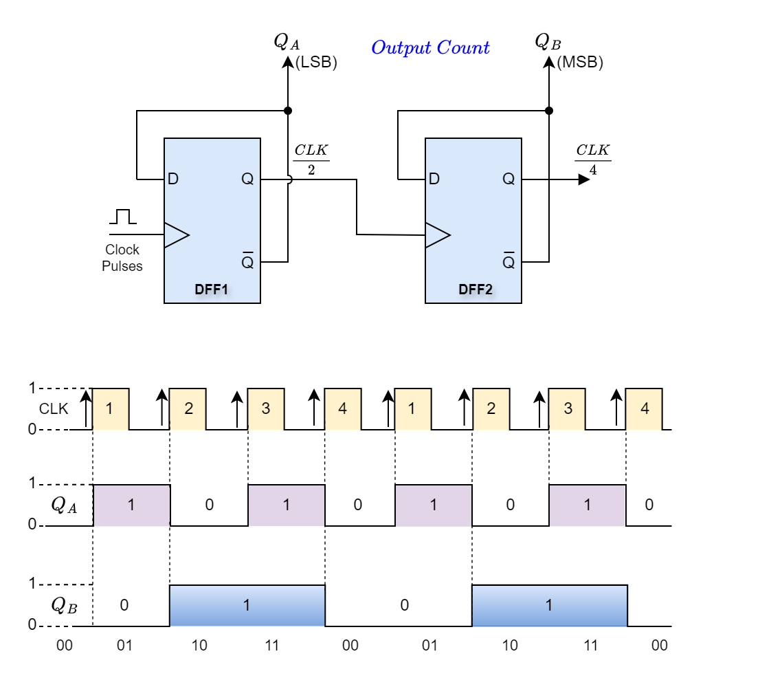

MOD-4 Counter
A single flip-flop, in addition to being a 1-bit storage device, may also be conceptualized as a MOD-2 counter since, upon application of the clock signal, its sole output produces a count of two, which can be either 0 or 1. However, a single flip-flop only generates a finite counting sequence; thus, we may build a MOD counter of any value by joining more flip-flops to form a chain, which increases the counting capacity.
If a single flip-flop is considered a modulo-2, or MOD-2, counter, then adding another flip-flop would make it a MOD-4 counter, which would enable counting in four distinct stages. Essentially, the original clock input signal would be divided by four. This 2-bit MOD-4 counter’s binary sequence would thus be as follows: 00, 01, 10, and 11 as shown.
MOD-4 Counter and Timing Diagram
Fig-3: MOD-4 Counter and Timing Diagram
Even though this link represents an asynchronous counter, the switching transitions of QA, QB, and CLK are depicted in the timing diagram above as being simultaneous for the sake of simplicity. There would be a very slight switching delay between the outputs at QA and QB and the application of the positive-going clock (CLK) signal.

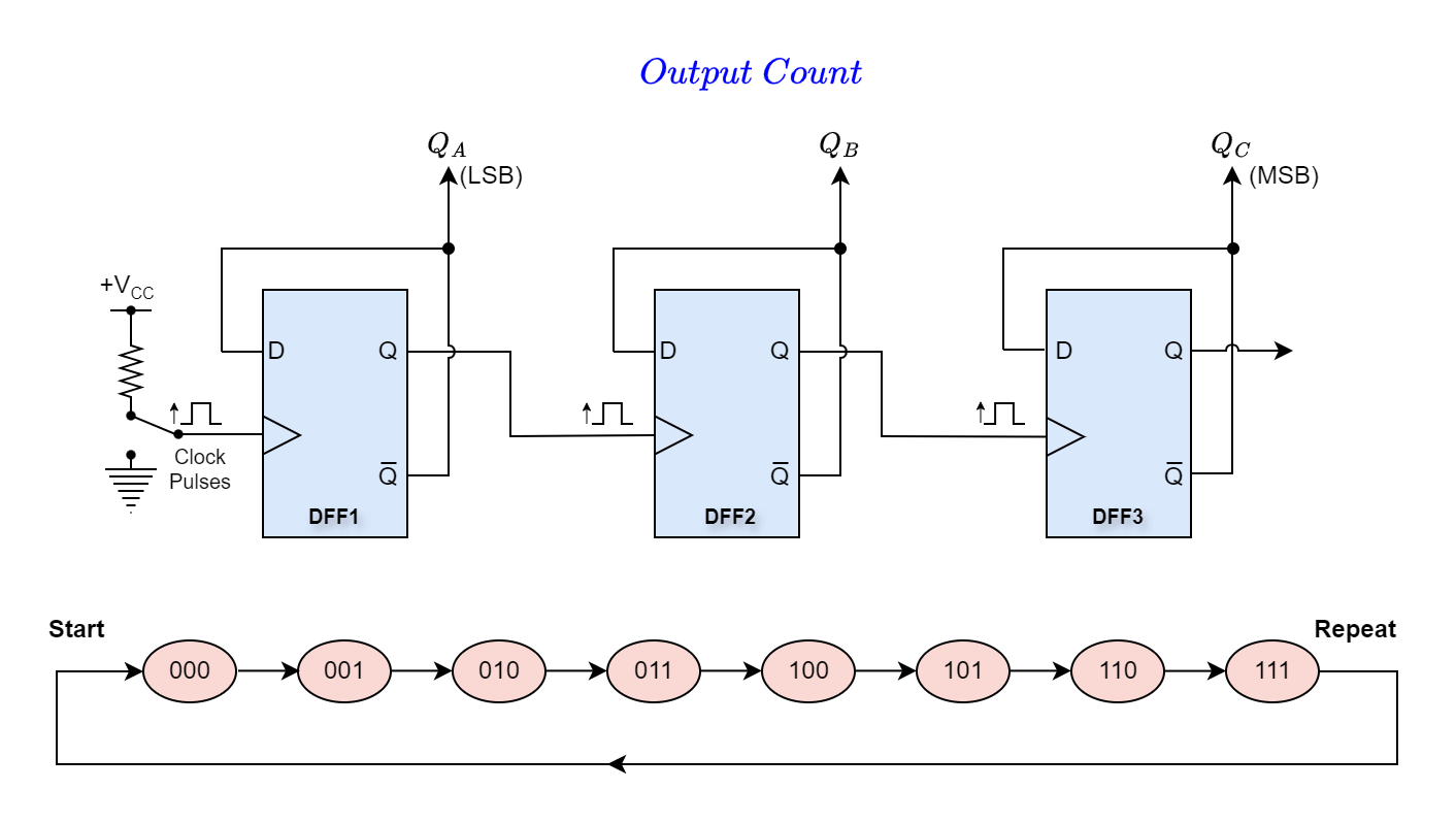

Then, we observed that a MOD-4 counter needs two flip-flops to count in four distinct steps, but a MOD-2 counter just needs one. A MOD-4 counter could easily have another flip-flop added to the end to create a MOD-8 counter, which would provide us with a 23-binary sequence that would count from 000 to 111 before resetting to 000. We could add more flip-flops indefinitely since a fourth flip-flop would create a MOD-16 counter and so on.
MOD-8 Counter and State Diagram
Fig-5: MOD-8 Counter and State Diagram
By constructing mod counters with a natural count of 2n states, we may therefore create counters that have mod counts of 2, 4, 8, 16, and so on, before repeating. However, sometimes it is required to have a modulus counter without a modulo that is a power of two that resets its count to zero during the regular counting procedure. As an illustration, consider a counter with a modulus of 3, 5, 6, or 10.

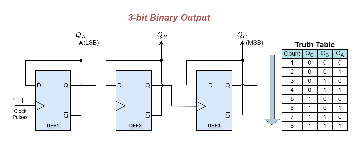

What steps would we need to take, if we wanted to create a MOD-5 counter? Since 2n must be more than 5 given that we know that “m = 5,” Since 8 is more than 5 and 21 = 2, 22 = 4, 23 = 8, a counter with at least three flip-flops (N = 3) is required to provide a natural binary count of 000 to 111 (0 to 7 decimal).
Applying the previous MOD-8 counter-example. The following will be the truth table for its natural count:
MOD-8 Counter and Truth Table
Fig:-6 MOD-8 Counter and Truth Table

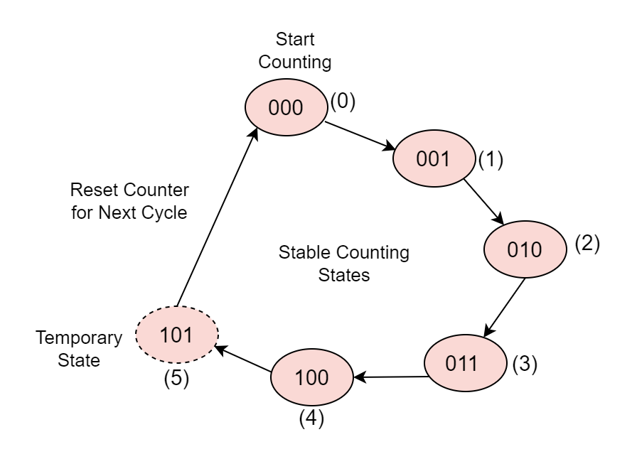

We need to change the above 3-bit counter circuit such that it will reset itself back to zero after a count of five to build a MOD-5 counter. It is a count sequence that goes like this: 1→2→3→4→5→reset, and so on.
Since 000 is a legitimate count state, a MOD-5 counter would yield a 3-bit binary count sequence ranging from 0 to 4. This would give us the following binary count sequence: 000, 001, 010, 011, 100. As a result, as indicated by the state diagram below, the counter circuit must reset itself at the next counting stage, which is the count of six. In this case, the output condition would be QA = 1, QB = 0, and QC = 1 in binary.
MOD-5 Count Sequence
Fig-7: MOD-5 Count Sequence

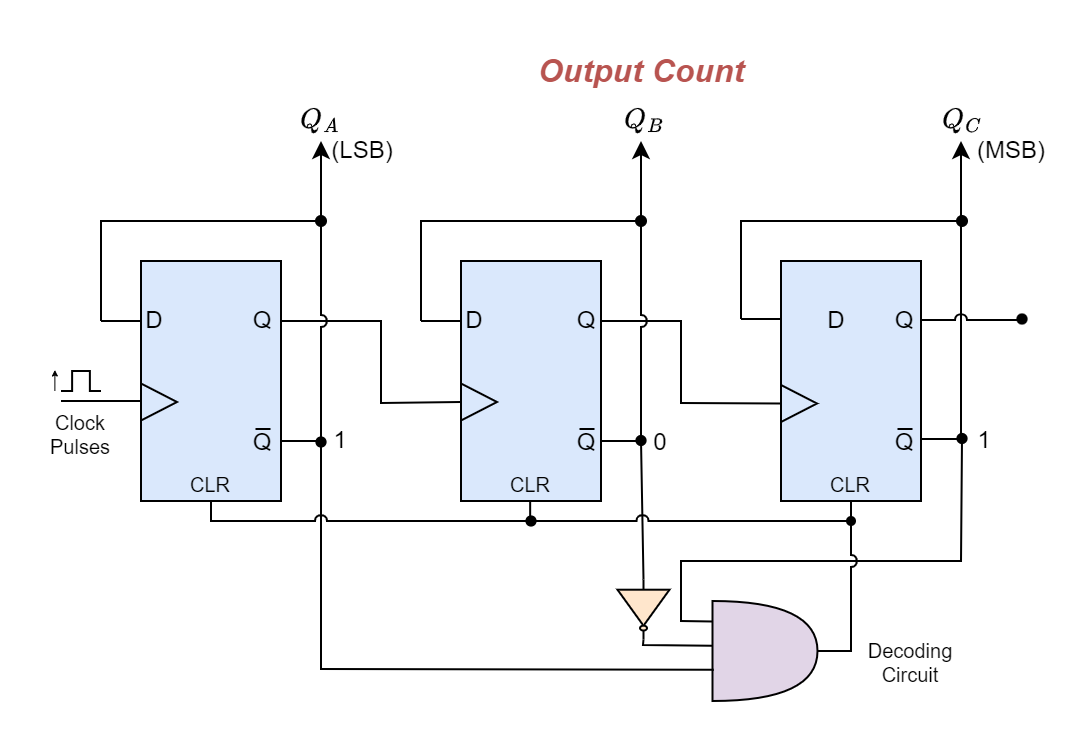

Using an inverter or NOT gate (TTL 74LS04) and a 3-input AND gate (TTL 74LS11), we may decode this output state of 101 (5) to get a signal to clear (Clr) the counter back to zero. The 3-bit counter outputs of QA, QB, and QC are coupled to the inputs of the combinational logic circuit, which consists of an inverter and a digital logic AND gate.
Fig-8: 3-bit counter outputs with Inverter and AND-Gate
Therefore, for any combination of inputs other than the desired input sequence, the 3-input AND gate’s output will be at logic level “0” (LOW).
The output sequence count in binary code will be 000, 001, 010, 011, 100.

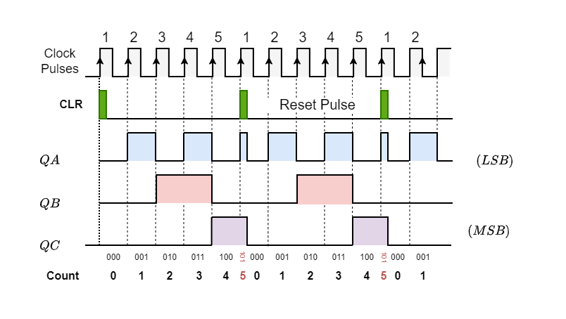

Even though it looks like the counter counts up to the 101 state, the combinational logic decoding circuit will detect this 101 condition when the asynchronous count sequence reaches the next binary state of 101 (5). As a result, the AND gate will generate a logic level “1” (HIGH) output, which will reset the counter back to its initial zero state. As a result, the counter only stays in this momentary condition of 101 for a brief period before resetting to 000.
Consequently, after the AND gate outputs a 5 (decimal) count, we may utilize the input decoding of the AND gate to reset the counter back to zero, providing us with the necessary MOD-5 counter. The counting sequence is unaffected by the decoding circuit’s low (LOW) output.
Modulus 5 Mod Counters and Truth Table
Fig-9: Modulus 5 Counter
Fig-10: Mod-5 Timing Diagram
