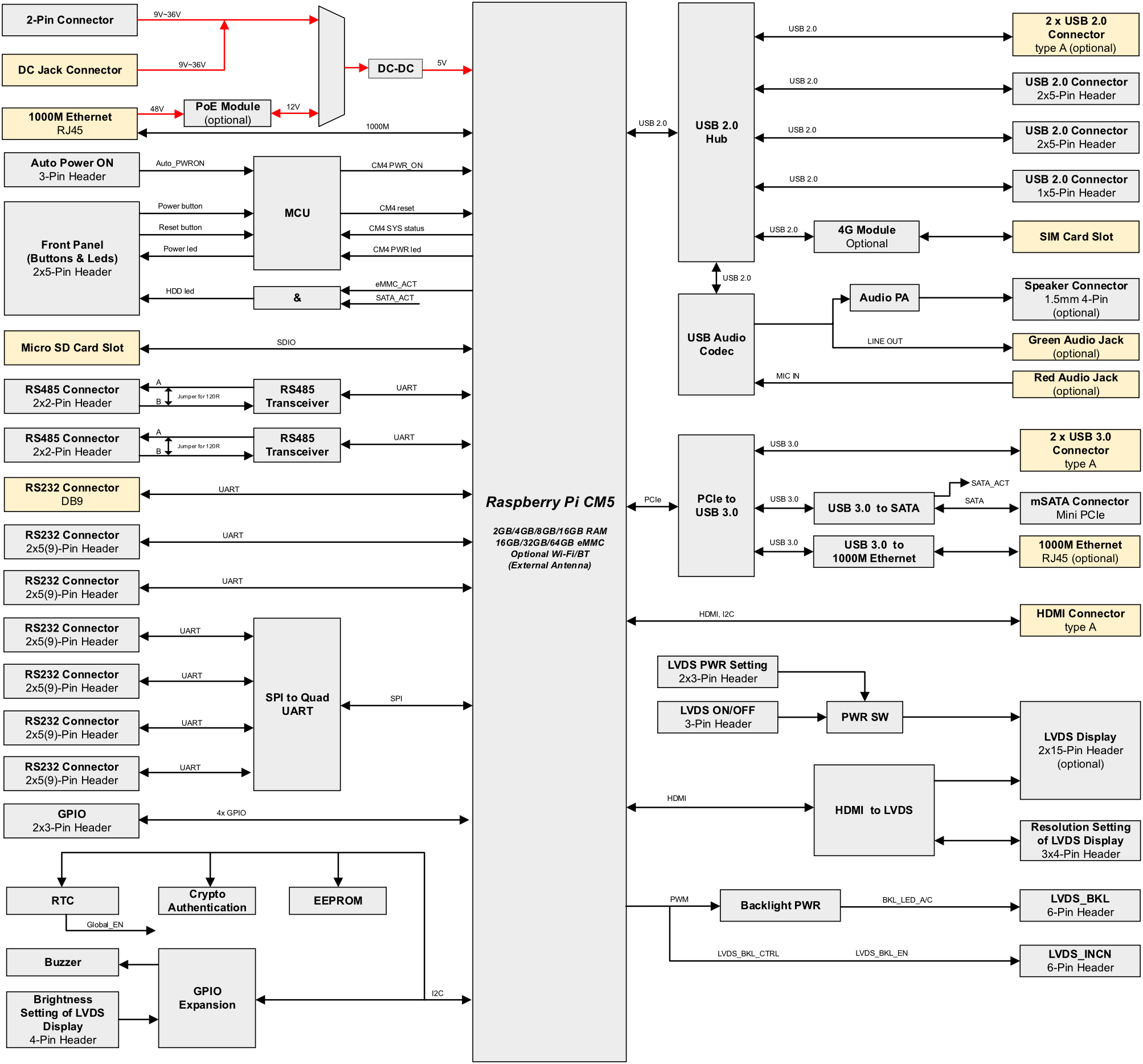

EDATEC ED-SBC3300 Raspberry Pi CM5 Motherboard Specifications
  • Base Specifications
    • SoM: Raspberry Pi Compute Module 5 (CM5)
    • SoC: Broadcom BCM2712
      • CPU: Quad-core Arm Cortex-A76 @ 2.4GHz
      • GPU: VideoCore VII with OpenGL ES 3.1, Vulkan 1.2 support
      • VPU: 4Kp60 HEVC decoder
  • Memory & Storage
    • System Memory: 2GB, 4GB, 8GB, or 16GB LPDDR4-4267 SDRAM (with ECC)
    • eMMC Storage: 16GB, 32GB, or 64GB
    • Expansion:
      • mSATA SSD socket
      • MicroSD card slot
      • 4KB EEPROM
  • Video Interfaces
  • HDMI 2.1 Type-A port (up to 4Kp60)
  • LVDS interface (ED-SBC3320/3321 only)
    • Resolution: Up to 1080p60
    • Voltage selection: 3.3V, 5V, 12V
    • Backlight power/control connectors
  • Audio (ED-SBC3320/3321 models only)
    • 3.5mm stereo audio output jack
    • 3.5mm microphone input jack
    • 4-pin WTB connector for stereo speakers (4Ω, 3W)
  • Networking
    • Gigabit Ethernet (RJ45): 1 or 2 ports (depending on model), with optional PoE
    • Wireless: Optional WiFi 5 & Bluetooth 5 (via CM5)
    • 4G LTE: Supported via mini PCIe module with Nano SIM slot
  • USB Ports
    • 2x USB 3.0 Type-A (5Gbps)
    • 2x USB 2.0 Type-A (ED-SBC3310/3320 only)
    • USB 2.0 headers:
      • 3x headers (ED-SBC3310/3320)
      • 5x headers (ED-SBC3311/3321)
  • Serial Ports
    • RS232:
      • 1x DB9 male connector (Tx/Rx/GND)
      • 6x additional ports via headers
    • RS485:
      • 2x ports via headers (120Ω jumper option)
  • Expansion
    • Mini PCIe slot for 4G LTE module
    • 6-pin GPIO header
  • Other Features
    • 10-pin front panel header (power/reset buttons, HDD/power LEDs)
    • RTC with CR2032 battery backup
    • Buzzer
    • Auto-boot (3-pin header)
  • Power Supply
    • Input Voltage: 9V~36V via DC jack or 2-pin Phoenix terminal
    • Protections: Reverse polarity, overvoltage, overcurrent
    • Optional PoE module
    • Max Power Consumption: 60W
  • Physical & Environmental
    • Dimensions: 170 x 170 mm (Mini-ITX)
    • Weight: 100 grams
    • Operating Temperature: -25°C to 50°C
    • Humidity: 5% to 95% (non-condensing)
The EDATEC ED-SBC3300 Motherboard for Raspberry Pi CM5 remains largely unchanged apart from the use of the Raspberry Pi Compute Module 5 (CM5), with the same software support for Raspberry Pi OS 32-bit/64-bit Lite/Desktop provided alongside necessary drivers. However, the CM5 introduces some issues not present with the CM4, including the unavailability of RS485 functionality without manual modification by EDATEC upon request, slower read speeds for certain mSATA SSDs, and limited usability of RS232 ports, with only JCOM1 and JCOM2 functioning normally while software work is ongoing for JCOM3 to JCOM6.
