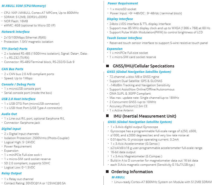

The i.MX 6ULL is a power efficient and cost-optimized processor family featuring an advanced implementation of a single Arm® Cortex®-A7 core, that can operate at speeds up to 900 MHz. The i.MX 6ULL application processor includes an integrated power management module that reduces the complexity of an external power supply and simplifies power sequencing. Each processor in this family provides various memory interfaces, including 16-bit LPDDR2, DDR3, DDR3L, raw and managed NAND flash, NOR flash, eMMC, Quad SPI and a wide range of other interfaces for connecting peripherals such as WLAN, Bluetooth®, GPS, displays and camera sensors.

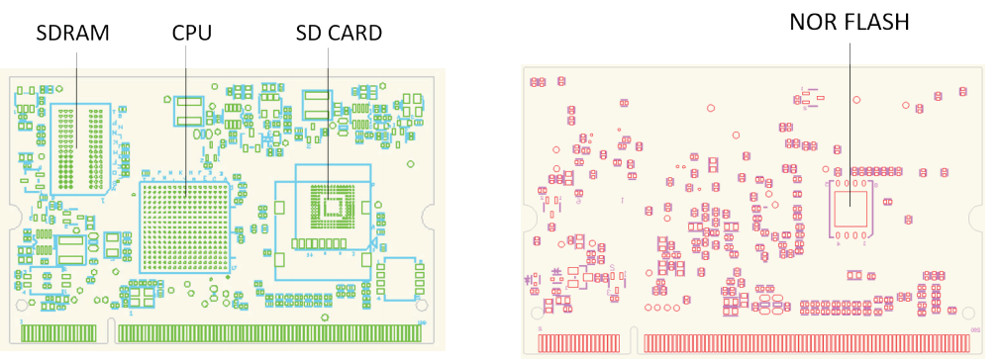

The Artila NXP i.MX 6ULL is clocked up to 800MHz and is Linux ready. The module is notable for offering Linux 4.14 with the PREEMPT_RT real-time patch which could make the module find applications in areas that needs real-time interaction. The SODIMM styled ultra-compact module measures only 68 x 42mm. The module provides support for interfaces like CAN, UART, USB, SD, LCD, GPIO, SD, Ethernet, and some others which are accessible through the module’s 200-pin expansion connector. The module ships with 512MB of DDR4 RAM, a 4GB onboard eMMC, and a 16MB NOR flash. It provides one 24bits digital parallel display interface that supports max 85MHz display clock and up to WXGA (1366 x 768) at 60Hz, a touch controller that can support 4-wire and 5-wire resistive touch panel. The module is 5V rated and consumes about 0.75 Watts.
Artila provides software packages such as PHP, Python, Perl, Node.js, and Node-RED which are available for free and the Linux BSP includes GCC 6.2.x + glibc 2.24, U-Boot, X11 GUI engine, and more. These software packages can be updated through the Artila repository by issuing the standard Linux apt-get command. The module can be booted either from the onboard eMMC or an external SD card.
Just like every other SoM board maker, Artila is providing an optional M-X6ULL starter kit to go with the module. The starter kit expands out the module microSD slot, dual Fast Ethernet ports, a USB2.0 host port, and micro-USB ports. The kit is further equipped with a 24-bit LVDS interface with resistive touch support and an audio output jack.
The specification for the starter kit is shown below:
i-MX6ULL Starter Kit Specification
The major target applications of this module are Industrial HMI & Access Control, IOT gateway, Industrial control & automation and Test and measurement. Attila’s M-X6ULL SoM is available for order but the price is not disclosed yet.
