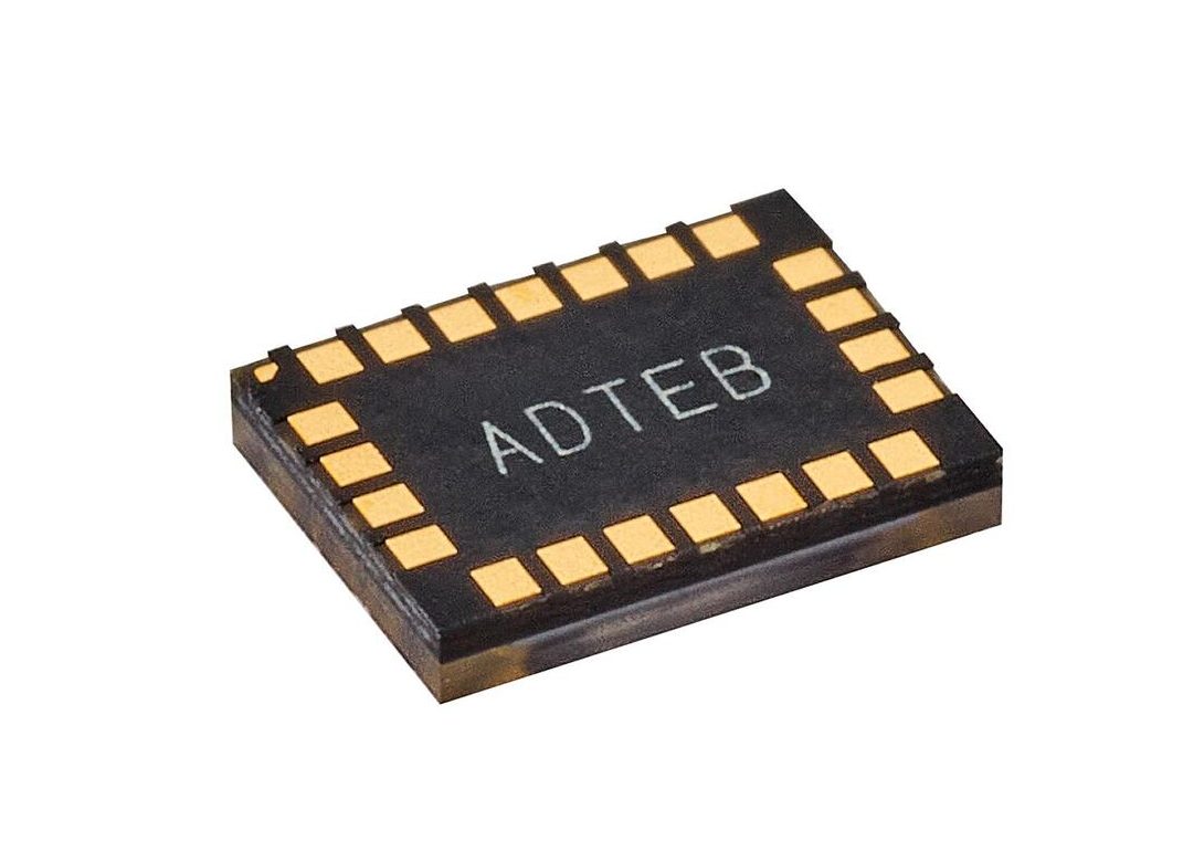

ams' biosensor solution is based on photoplethysmography and electrocardiogram The operation of the ams AS7038RB is based on photoplethysmography (PPG) and electrocardiogram (ECG). PPG is the most used HRM method, which measures pulse rate by sampling light modulated by the blood vessels, which expand and contract as blood pulses through them.
ams’ biosensor solution is based on photoplethysmography and electrocardiogram
The operation of the ams AS7038RB is based on photoplethysmography (PPG) and electrocardiogram (ECG). PPG is the most used HRM method, which measures pulse rate by sampling light modulated by the blood vessels, which expand and contract as blood pulses through them. PPG is also used to measure blood oxygen saturation (SpO2). ECG is the reference for any measurement of the biopotential generated by the heart. Embedded ECG analog front end satisfies IEC 60601-2-47 requirements.
The solution includes LED drivers, photo-sensor, analog front-end (AFE), sequencer, and application software. In addition, the device also enables skin temperature and skin resistivity measurements by providing interfaces to external sensors.
Compare to ams’ previous generation, AS7038RB has a 250% larger photodiode with lower LEDs driving current to achieve the high PPG performances. The AS7038RB’s low-power design and small form factor are particularly well suited to application in earbuds, fitness bands, smartwatches, sports watches, and smart patches in which board space is limited and in which users look for extended, multi-day intervals between battery recharges. The thin package dimension makes the AS7038RB suitable for height constrained solution likes earbuds or smart patches. The photodiode filter centered on red and infrared wavelengths and embedded ADC make the AS7038RB suitable for disposable pulse oximeter solutions.
